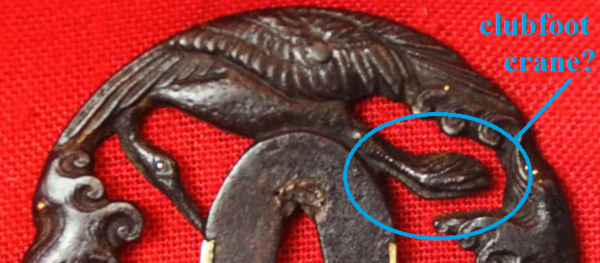

image.thumb.png.f86a78969039c4f6fa8ed394826f0b2f.png  The Crane's feet are clumsy
Maybe wrong, dunno, but looking at what you point out sent me off on a personal debate as to whether its possibly cast?. Just something about it, the way the waves are not crisply carved.
Folks will know better than me.
