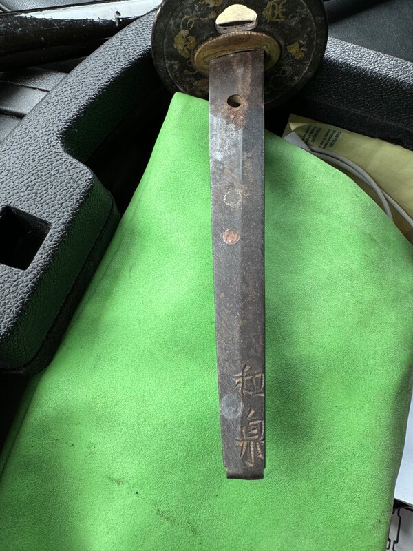

Would like to know the maker and any other info on my sword, it was shortened and the name folded over, o-suriage with orikaeshi nakago . From tip of blade to tsuba measures 29”IMG_6319.thumb.jpeg.675034501da2b4ad48296d182084c341.jpegIMG_6319.thumb.jpeg.675034501da2b4ad48296d182084c341.jpegIMG_6323.thumb.jpeg.9f87efa1e93aa37ce6b6b0ccdf666e38.jpegIMG_6324.thumb.jpeg.23d1e4c446c78d6f1f8bb5accaed8a9c.jpegIMG_6325.thumb.jpeg.88eebe57eaf7193f28c3126e806af5fa.jpeg

Klaus read the MEI although the image was upside-down.

Wasn’t sure about photographing this signature as it was folded over, guess I could photograph one side tip up and the other tip down, if that would help

Hi Herb,
Yes, if you want to make it easy for us to read and help.

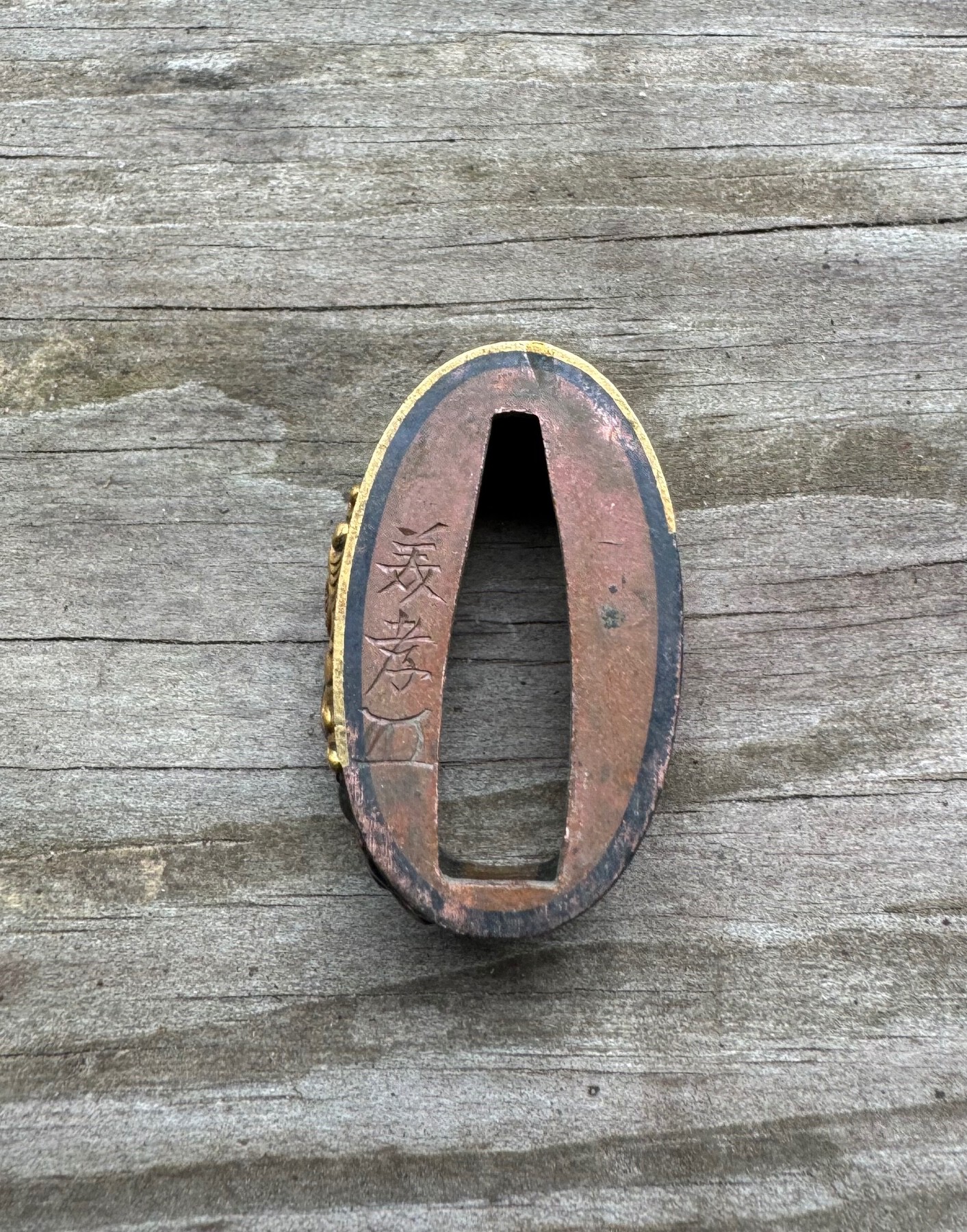

Herb,
good photos, but orientation of TSUBA should be cutting edge upwards (unless it is clearly a TACHI TSUBA).
This TSUBA should be carefully cleaned with warm water and a soft brush, then dried thoroughly. A drop of TSUBAKI (Camellia oil) or cooking oil (only when dry!) would not hurt.
Be very careful not to damage the gold applications!
Probably not a valuable but interesting TSUBA.
