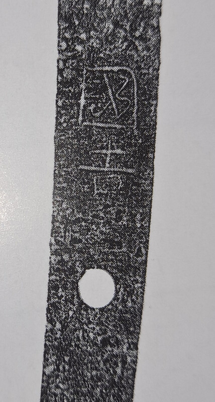

Gakusee Posted October 20, 2024 Report Posted October 20, 2024 8 hours ago, Francis Wick said: Ok finally got it today. Bad news ? Spots of rust but all superficial no pitting should polish I think Not piles of meat on it but enough I think Good news: NO fatal flaws it is actually exactly 27 inches long Nagasa No expert and pics are seriously hard to take no setup for it from my limited knowledge it has suguha hamon, boshi medium and chu maru, jihada ko itame Thanks for the detailed image of the mei. It does look close to a TokuJu Kuniyoshi mei (attached here for reference) plus the workmanship is consistent and so is the jigane quality. I think it has a good chance of papering just by the little we have seen here. 2 Quote
Francis Wick Posted October 20, 2024 Author Report Posted October 20, 2024 3 hours ago, Gakusee said: Thanks for the detailed image of the mei. It does look close to a TokuJu Kuniyoshi mei (attached here for reference) plus the workmanship is consistent and so is the jigane quality. I think it has a good chance of papering just by the little we have seen here. Thank you for the pic of the other mei. It’s pretty close I would say. Has a chance I guess no good reason not to try at this point 1 Quote

Jussi Ekholm Posted October 21, 2024 Report Posted October 21, 2024 Like Michael above I would feel this would be quite plausible as being a genuine work by Enju Kuniyoshi. Unfortunately the TJ13 Orikaeshi-mei example that Michael posted above is the only actual picture of signature by this smith that I have. Here are the 3 tachi signatures that I mentioned above. Kasuga Taisha Ise Jingū Jūyō 15 4 1 Quote
Rivkin Posted October 21, 2024 Report Posted October 21, 2024 Does not look bad. I would have send it to be shown to Tanobe sensei and if he feels its good to have it polished and then submitted for papers. As is, I still feel there is some uncertainty. 1 1 Quote
Francis Wick Posted October 21, 2024 Author Report Posted October 21, 2024 4 hours ago, Jussi Ekholm said: Like Michael above I would feel this would be quite plausible as being a genuine work by Enju Kuniyoshi. Unfortunately the TJ13 Orikaeshi-mei example that Michael posted above is the only actual picture of signature by this smith that I have. Here are the 3 tachi signatures that I mentioned above. Kasuga Taisha Ise Jingū Jūyō 15 Outstanding Jussi I don’t know where you find all this material ! Thank you muchly it is going to Japan next year so we will see how it goes. Quote
