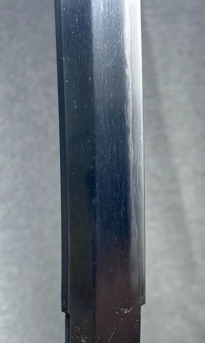

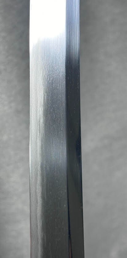

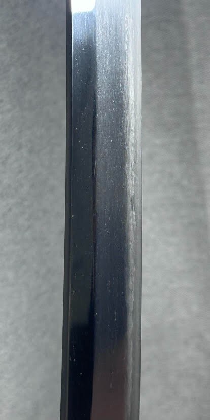

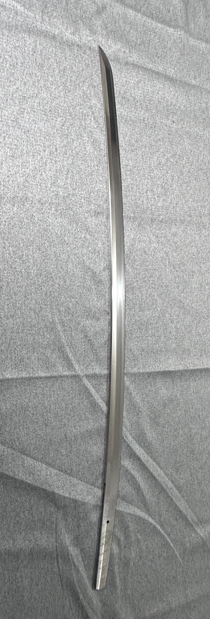

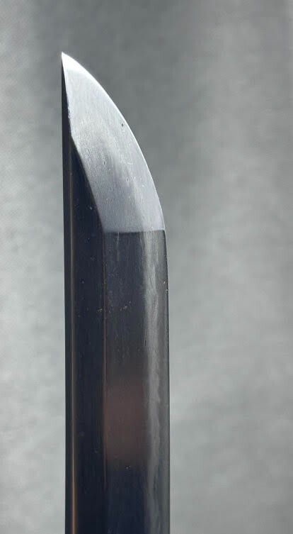

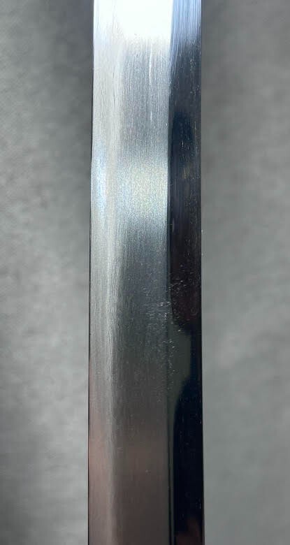

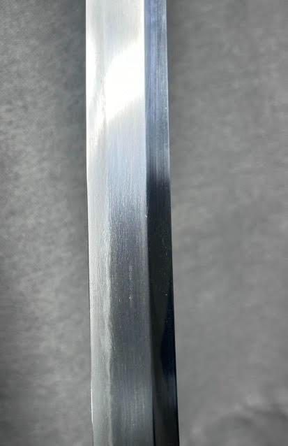

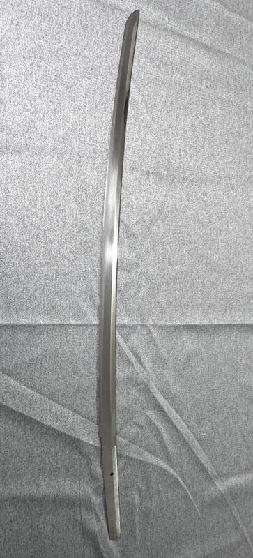

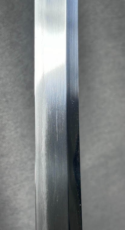

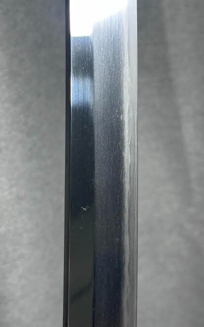

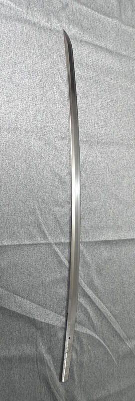

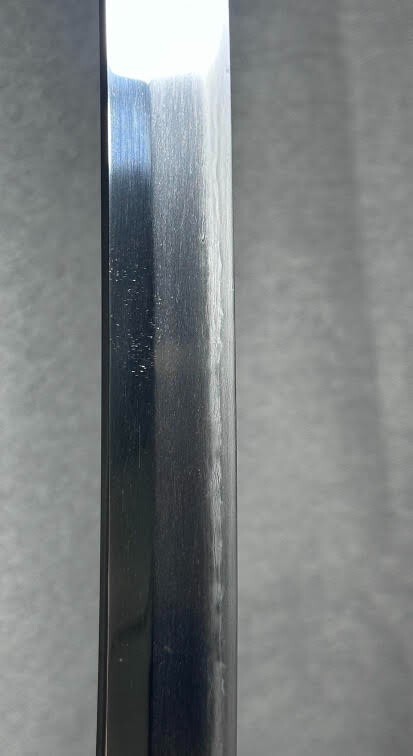

If that is a newly made Chinese sword, that's impressively good.
I can't see any obvious signs beyond the sketchy seller that it is Chinese or machine made... Honestly if this hit the UK auctions with no info and based purely on sight alone, I'd probably be bidding on it, which is scary if this really is a fake.
Are there any red flags I'm missing? The hamon looks a little strange on some photos (darker shadows in places), the linear vertical lines on some of the steel reminds me of a wartime polish (so rushed/amateur/perhaps machine done), but anything distinctly bad that couldn't be explained by bad lighting or a bad polish? (And yes, I am ignoring the nakago since there's no close up images of it)
I'm uploading the ebay pics and description for posterity:
