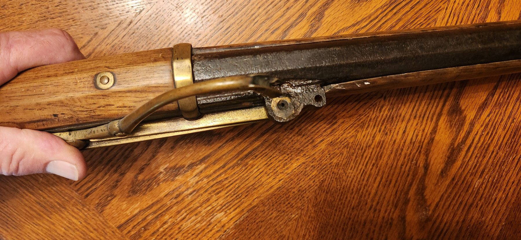

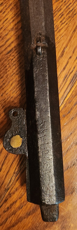

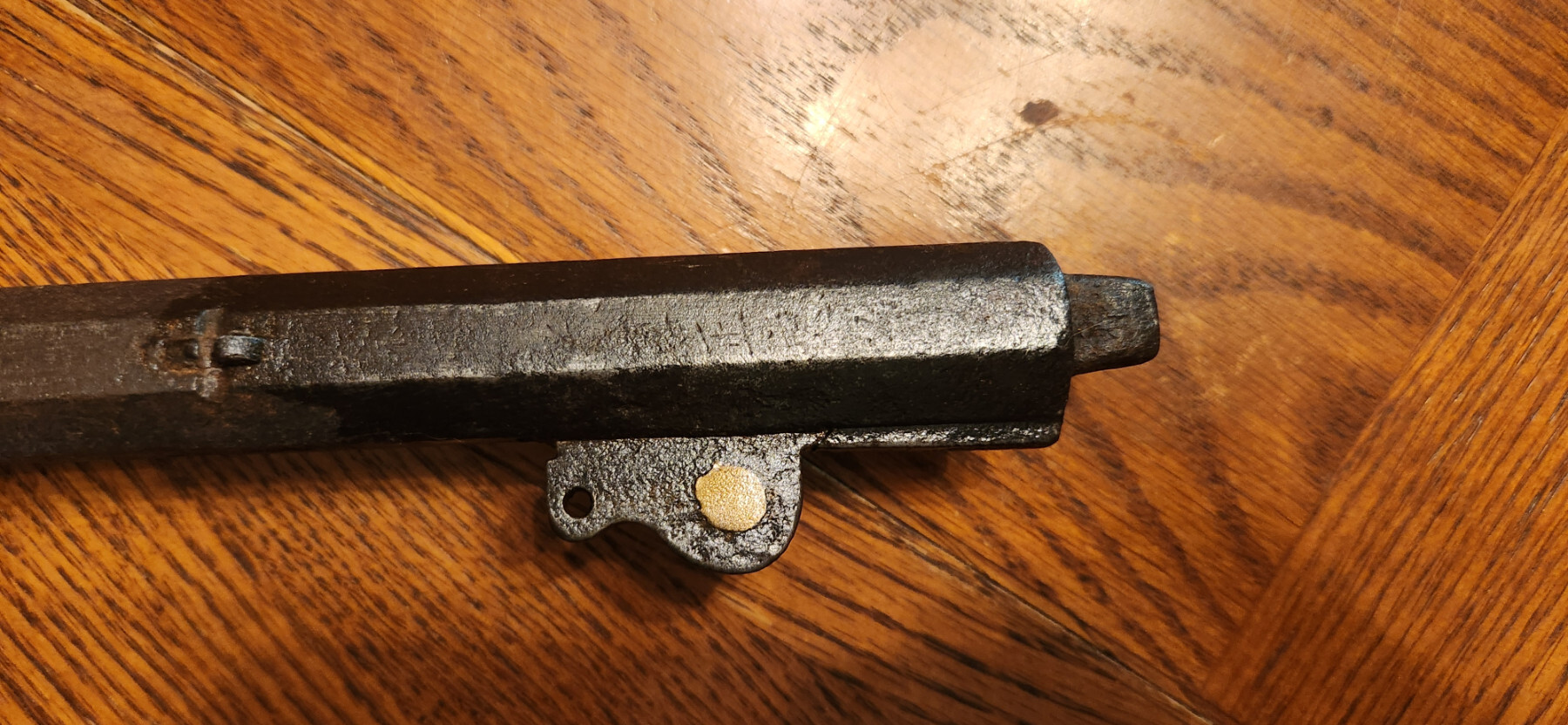

Wavemaker Posted October 3, 2024 Report Posted October 3, 2024 I would like some assistance in translating the markings on this rifle and possibly determining it's age and authenticity. Sorry, the pics of the marking under the barrel are the best I can get. Quote
Bugyotsuji Posted October 3, 2024 Report Posted October 3, 2024 The gun looks good from here John, well used, with some minor damage and the original coating stripped off completely. The Mei looks to be 正忠 Masatada (or 正良 Masayoshi) + Saku, but I cannot immediately find a record of either personal name without the smith family name above. The gun does have some distinguishing features, but not really enough for me to place it geographically. (Kunitomo?) As to age, we can say loosely mid-Edo. On the side of the butt is the 壬申 Jinshin Bango number from the great round-up of 1872. Looks like 1,873 号 ('go' =number). Under that may be コクフケン 'Kokufu Ken', an early Gifu Prefecture name(国府県?) but I haven't yet figured that out. In early Meiji, the old Han were abolished and a new system of prefectures was introduced. Some of the new prefectures only lasted a few years, merging with others for example, but many kept their original name. (Still working on it) PS Since the barrel has no rifling, it might be better to call it a Tanegashima (smoothbore) matchlock long gun, etc. 2 Quote

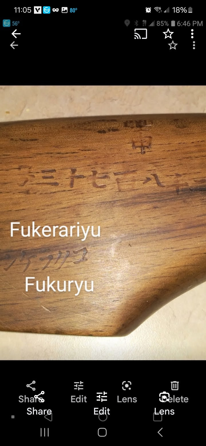

Wavemaker Posted October 4, 2024 Author Report Posted October 4, 2024 Maybe I wasn't far off. I pulled this up but seems like the one character is missing a line. Quote
Bugyotsuji Posted October 4, 2024 Report Posted October 4, 2024 ...is it 1,000 or 2,000? 一千, 二千? Hard to tell with those shadows, but try this 一千八百七十三 Quote

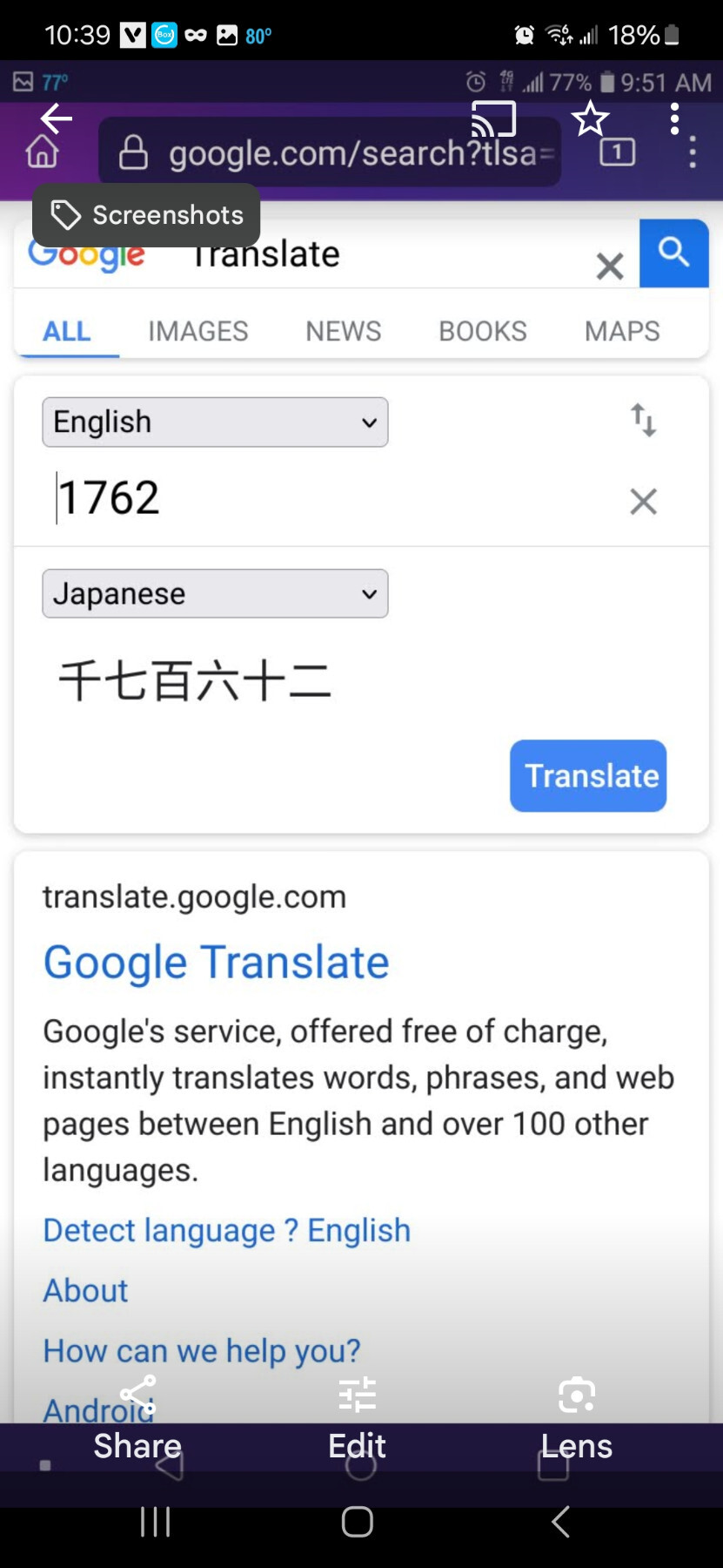

Wavemaker Posted October 4, 2024 Author Report Posted October 4, 2024 Also wanted to add this. Google translate came up with the top word for those characters. Closest I could find to it was the bottom word. May be way off base. No expert. Quote
Bugyotsuji Posted October 4, 2024 Report Posted October 4, 2024 Many of the stamps are not clear, so they are to a degree open to interpretation. Usually with these Jinshin registration numbers there is an indication somewhere on the barrel or stock nearby noting the place of registration. If we follow the same direction as the numbers (which go from right to left), then the bottom word makes sense as Kokufu Ken コクフケン. With the Kanji it would be, as I said above, 国府縣 if you use the old kanji 縣 for 県 Ken (prefecture). (Originally I thought it might be ユリフ, but that did not make much sense as I could find no record of such a place.) This would tell you simply that a gun originally made somewhere in Japan was picked up in the great registration of 1872 in Gifu. 2 Quote
Yumso Posted October 4, 2024 Report Posted October 4, 2024 Read from right to left, 第二千八百七十三号 -> No. 2873 コクラケン -> Kokuraken https://aucview.com/yahoo/j1140802752/ Here, this rifle also had similiar number to yours. 3 1 Quote
Bugyotsuji Posted October 4, 2024 Report Posted October 4, 2024 Yes, Kokura makes sense. Thanks, Yoon! 1871-1876 https://en.m.wikiped...ki/Kokura_Prefecture 1 Quote
