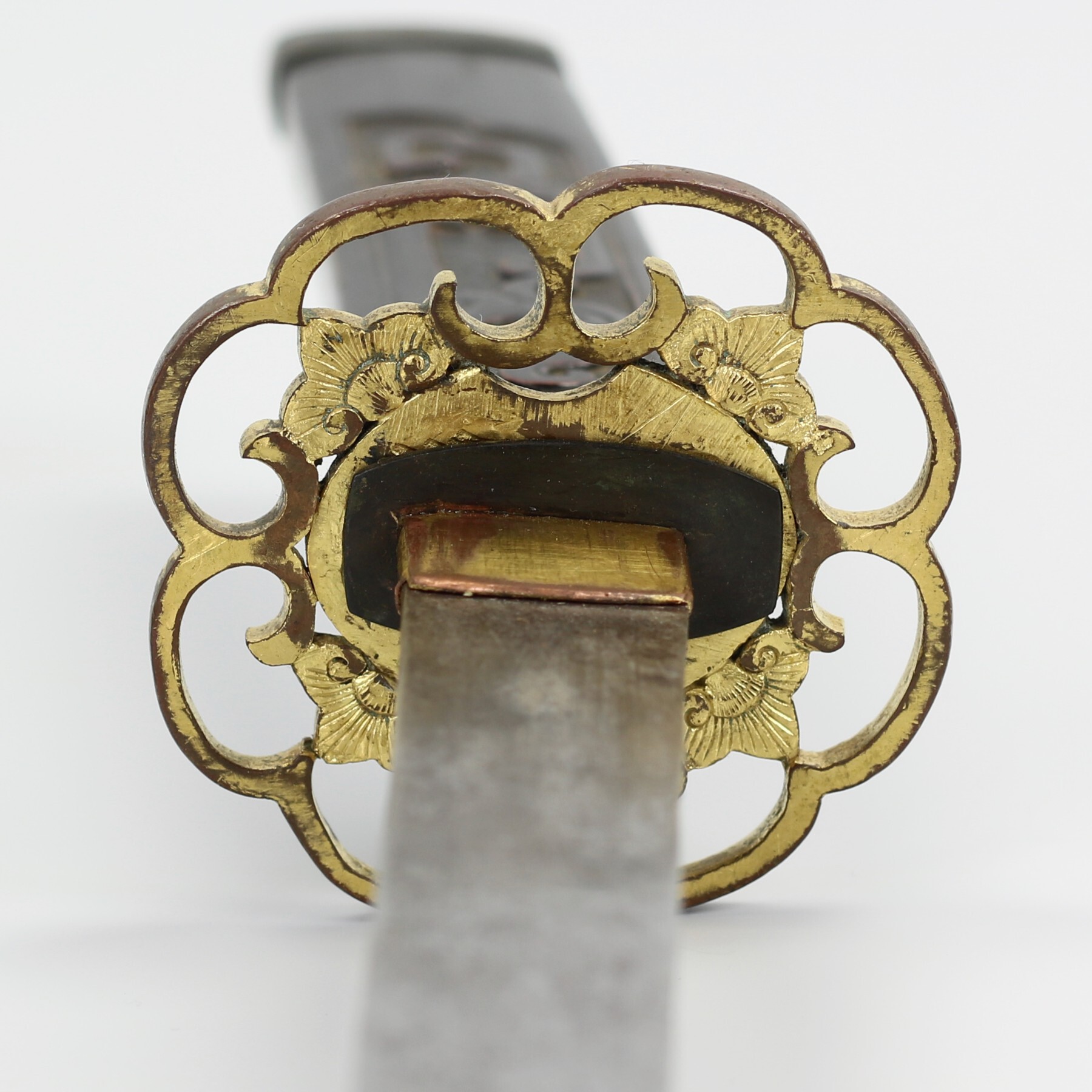

Peter D Posted October 10 Report Posted October 10 On 10/2/2024 at 10:53 AM, vajo said: I allways want to find out when i see a crude katana that it could be a korean hwando. What is the point that makes a difference? https://www.mandarin...ean-ceremonial-saber Korea is right in between the major powers Japan and China and it shows on their weapons and other regalia. They have a number of swords, some are much easier to differentiate from Japanese swords than others. Their straightswords generally follow the tradition of the Ming period in China, so they are easy to set apart from ken. Hwando Then there are the hwando, military sabers that are much more like Chinese yaodao (waist-worn sabers) than anything else. Korean swords are rare on the market, but this type turns up the most. The French army took a large number of them during a punitive expedition to Ganghwa Island in 1866, and they have been dispersed into collections worldwide since. Some have red writing on their sheats, dating to the late 18th century. All have iron mounts with silver overlay and octagonal guards. Occasionally, one sees guards separately sold as "nanban tsuba." The typical hwando, this one recently sold at Olympia Auction, lot 84. Wide blade more in the Chinese style. Typical Korean suspension system on scabbard, throatpiece missing. Grip wrap in the Japanese style but with hilt mounts following the late 18th-century Chinese transitional style between fangshi and yuanshi. (More about that here.) Joseon byeolun-geom Sabers worn by Joseon period military officials. This is the style most easily mistaken for Japanese swords. It is basically like a short tachi. Some of the best of them actually have Japanese-imported blades, so don't get distracted by the blade itself. Here is one I had, with a Japanese blade: The most obvious departures from Japanese design is the textile, if still present: a suspension system that more resembles the Chinese one, and a long tassel. Other tell-tale signs are the proportion of the hilt, and the fact it is often lacquered in the same style as the scabbard on this type of sword. Guards are modeled after Japanese guards but with odd placement and shape of the hitsu-ana. Often made of patinated silver, a Korean variety of shakudō but jade is also sometimes seen. The habaki also often look odd. Another aspect is that most of these were not made so they can be easily taken apart like the Japanese sword, so its often impossible to see the tang. Another one I had, again with a Japanese blade: Other types There is a whole range of other ceremonial Korean swords, but they are more easily discernible from Japanese swords because their blades are often roughly made and toy-like. They were more like a metal tsunagi sometimes. Here are two. 2 4 1 Quote

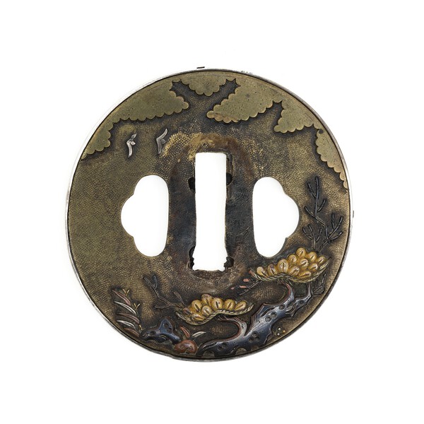

Peter D Posted October 10 Report Posted October 10 Some Korean guards. Often with hitsu-ana that are more round on the inside. Sometimes larger, sometimes smaller than those found on Japanese examples. Nakago-ana often miss that narrowing towards the edge that you tend to see on Japanese work. 3 2 2 Quote
