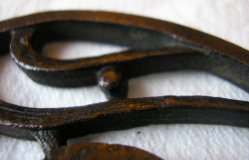

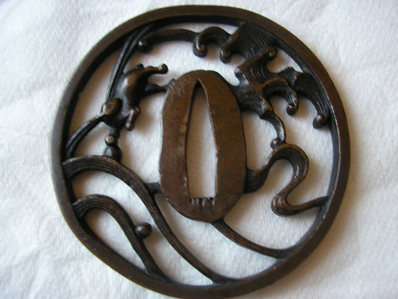

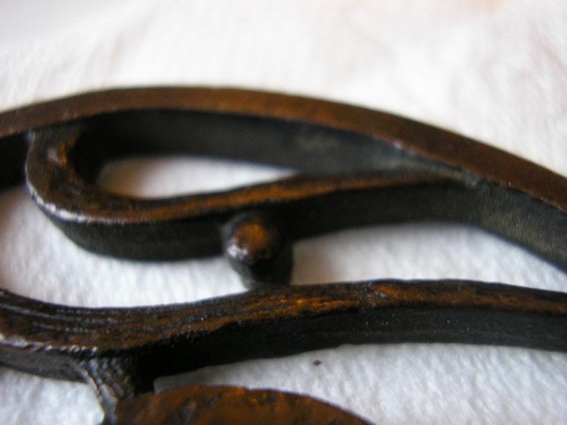

RobertM Posted December 30, 2009 Report Posted December 30, 2009 Hi all, I recieved this tsuba as a present, however i suspect it was purchased from a known seller who has been the topic of some conversation on this messageboard. My main concern with the tsuba is on the inside of the rim and carvings, running down the middle is a faint line. Does this mean the tsuba has been cast? Forgive my amateur question as its the first tsuba ive ever held in my hand. Sorry for the poor photo's. Description given was Owari copper tsuba, late edo period. Many thanks Rob M Edit Admin - pics resized from huge to just big Quote
Grey Doffin Posted December 30, 2009 Report Posted December 30, 2009 I've never heard of an Owari sukashi (open work) tsuba in soft metal; I think they're all iron. I guess cast. But what do I know? Let's hear from some others. Grey Quote
raven2 Posted December 30, 2009 Report Posted December 30, 2009 I would have to agree with Grey, I think it is cast. Quote

sanjuro Posted January 10, 2010 Report Posted January 10, 2010 Cast without a doubt...... Possibly Chinese but cant be certain. The subject matter of the decoration is most puzzling since the long eared rabbit and other elements of the design have no relationship as far as I am aware (I'm willing to be proved wrong of course). The patination seems contrived and artificial looking. Sorry to be so negative here, but thats how I see it. Better pics in focus would help a lot though. Quote
Ford Hallam Posted January 20, 2010 Report Posted January 20, 2010 Keith, the motif of long eared rabbits and waves was, and is, actually a remarkably common design in Japan. Apparently the design originates from the No theatre. A courtier crossing Lake Biwa recites a poem that remarks on the moon reflected on the waves....and thereby the rabbits on the moon ( obvious really ) now appear to run on the waves. While I agree that it's a modern cast copy I believe it was made from a mould taken from a genuine tsuba. It doesn't look anything at all like Owari though...the way the waves are carved and the relative openness reminds me more of certain types of Ko-Shoami guards. regards, ford Quote
Mantis dude Posted January 20, 2010 Report Posted January 20, 2010 I think it should be commented that while this is most likely a cast piece, a line like that on an iron tsuba could be an indication of a fold (well maybe not exactly like that), I don't have an example of some akasaka pieces that demonstrate but maybe someone else does or some other school where you can really see the fold. Point is a line running down the inside of the side wall doesn't automatically mean cast, it could also mean fold which is very desirable to see. The hare and waves is a very common, i can't remember exactly been a while but the rabbit under the moon has a meaning of reproduction (sexual) I think. Most of my books are packed away for a move, but that is popping into my head. I of course could have made that up, maybe I am just horny. LOL. These repros (chinese or whereever they are from) all seem to have a similar look and if you go on ebay or yahoo.jp, you usually can find the same seller selling a lot of them. Doesn't take long to start recognizing them when you see a bunch of them. You get that "feel" for them so you don't have to waste your time looking at them when scanning auctions. Just curious while on the topic, has anyone ever seen an article or discussion on real Japanese cast tsuba? over the years there has been some mentions here and there on the forums, but has there ever been a more academic discussion? I am still under the impression that casting has been done before modern times? Has anyone ever seen older cast pieces, say pre meiji? I have an older one but I wouldn't know how to date it. Maybe I will write about it after I move and I can take pics of it (it is packed away, actually I have 2 of them and that is how I learned it was cast). The clues became more apparent with closer insepection but it fooled several experienced guys because it looked old. it took more of a second look to id the cast clues. However, as I said I didn't even question the piece until I had purchased a second one. Subsequently I have seen one or 2 more on yahoo.jp over the years. My first one was mounted on a wakisashi that seemed to fit well and I assume had been mounted for a long time. The good news was while I purchased the wak for the tsuba, I sold the wak minus the tsuba and made $50 so I actually got the tsuba for free. Oh the early days of ebay. Quote
