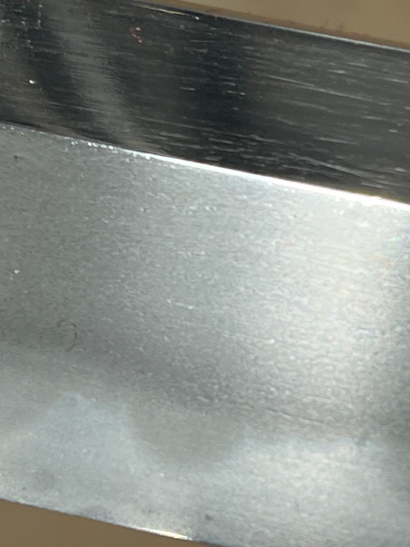

sc72 Posted September 30, 2024 Report Posted September 30, 2024 Gendaito blade purchased as "tamahagane", non-industrial production. I would be grateful for your opinion. Quote
sc72 Posted September 30, 2024 Author Report Posted September 30, 2024 Sorry for fotos but this is the best I can Quote
ROKUJURO Posted September 30, 2024 Report Posted September 30, 2024 Ste, please add your first name to all posts. It is a rule here. GENDAITO are traditionally made swords. They are made of TAMAHAGANE, are water-quenched and should show NIE or NIOI formations near the HAMON and a structure in the JI (= HADA). These features are often seen best in-hand by yourself. Making photos of it isn't easy. I suggest your images should be: - well focused, not foggy or blurry - made with a dark, non reflective background for good contrast - made with light from the side (may not apply for HAMON photos) - made directly from above (not at an angle) - made with correct orientation (vertically tip-upwards, especially NAKAGO photos and TSUBA) - without HABAKI but showing the MACHI and NAKAGO JIRI - made in high resolution to see details - showing details (in magnification) like BOSHI, HAMACHI, HAMON, HADA, NAKAGO JIRI etc. or the fine work on TSUBA - presented as cut-outs so very little background is shown If you cannot supply good photos (..."these photos are all I have from the dealer...."/..."I do not have a good camera but only an old mobile phone...." ), DO NOT POST BAD ONES. They will not be helpful. Quote

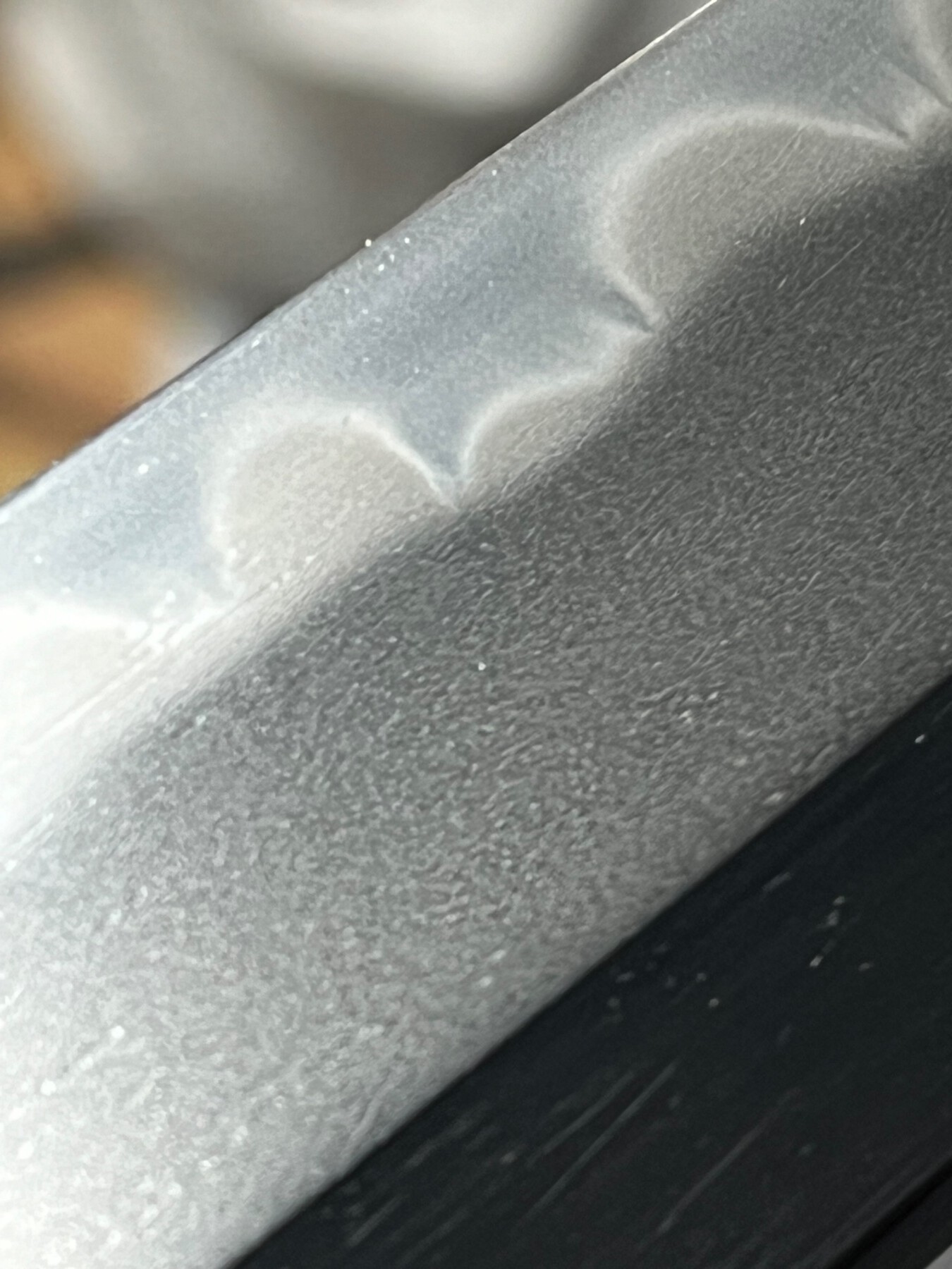

ROKUJURO Posted October 5, 2024 Report Posted October 5, 2024 Stefano, these are good photos which make it clear that it is a typical oil-quenched blade. If it was really made from TAMAHAGANE, I see no reason why it should not have been quenched in water and thus have an active HAMON with HATARAKI. The blade seems to show MUJI HADA if at all. You can add your first name to your profile so you can avoid typing it in every post. Quote
sc72 Posted October 5, 2024 Author Report Posted October 5, 2024 So clarified that in your opinion it is not tamahagane (No with water but finished with oil) ...it is a WWII gunto or worse a Chinese sword? ...now I see this discussion and Ray Singer post inside (with fotos) Stefano Quote

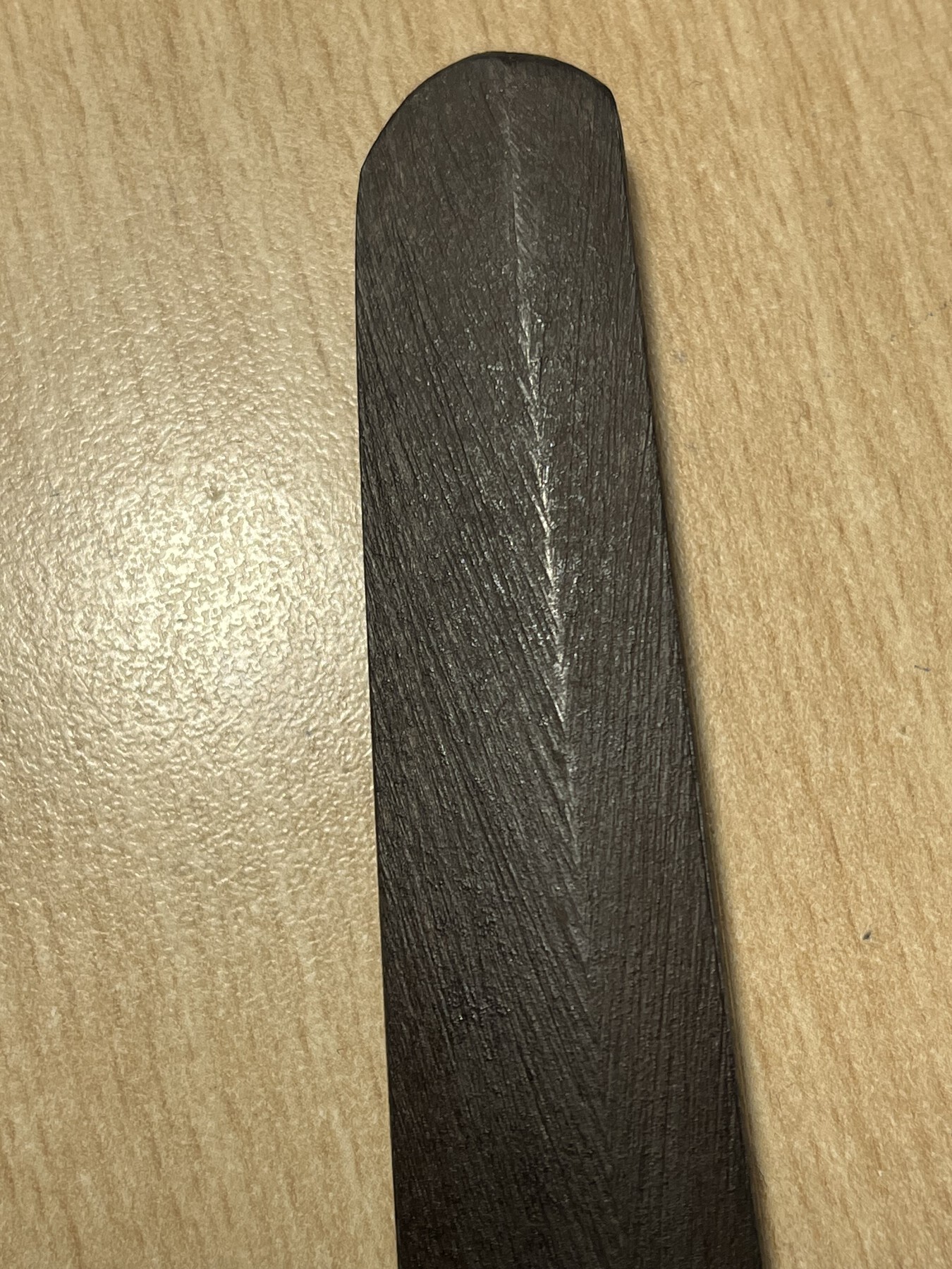

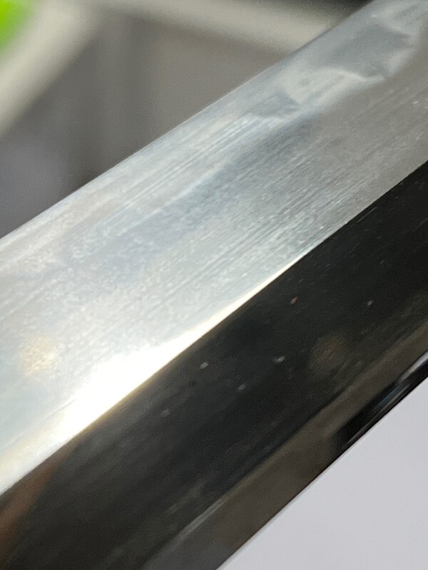

sc72 Posted October 5, 2024 Author Report Posted October 5, 2024 I have these photos of the previously unseen points, the koshirae is useless for the purposes of evaluating the blade as it has been changed. is this a pre or WWII gunto? or worse? Quote
Shugyosha Posted October 5, 2024 Report Posted October 5, 2024 Hi Stefano, I don't know that you can distinguish a blade made from tamahagane from one made of say, orishigane or nambantetsu just by the look. Blades made from nambantetsu in the 17th century look no different to blades of that period made with Japanese steel to my eye though it's possible that there is a more uniform distribution of carbon in modern steel. Jean may say different, but he's a bladesmith and I would respect his opinion on the matter. There is some hada there, so it's possible to say that the steel has been folded but it's hard to say more. As regards the hamon, the darker areas at the peak of each of the highest parts of the hamon (yahazu, arrow nock shape?) are the indicator that it has not been quenched in water but in oil. My understaning is that quenching in oil requires far less skill than using water as there as a water quench creates greater stress in the blade with a tendency for cracks to form in the edge so, having gone to the effort of folding the steel, there would be no point in taking the risk of ruining all that work by quenching with water. With regard to the photographs that you have just posted of the tang, I woud suggest that the patina looks odd and looks like it has been applied to give the blade an aged look. Also the ha and mune machi are off, they are always at 90 degrees to the blade on traditionally made Japanese swords and not with that chamfered kind of look. I'm sorry Stefano but I think that this is a modern Chinese copy (albeit much better than most) and I hope that you didn't pay too much for it. 1 Quote
Shugyosha Posted October 5, 2024 Report Posted October 5, 2024 Sorry, one further thing: is the blade unsigned? I would expect a Japanese made gendaito to carry the smith's signature (in fact I think it may be a legal requirement) so if that is not the case then that's another pointer towards it not being a Japanse made blade. Quote
PNSSHOGUN Posted October 5, 2024 Report Posted October 5, 2024 Agree, it is an oil tempered Seki sword from WWII with the Mei removed. Quote
