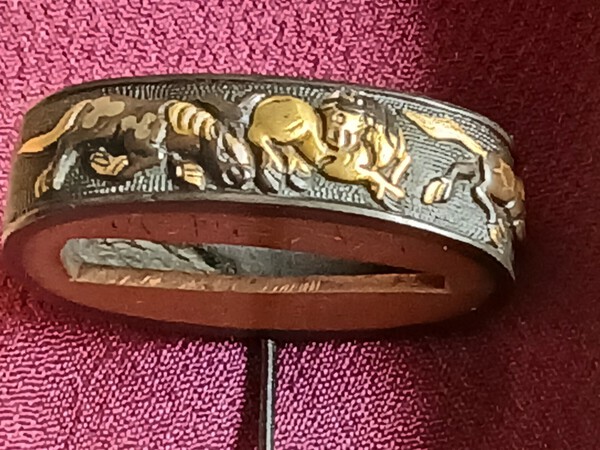

I recently acquired this fuchigashira apparently signed "Goto Senjo", along with another fuchi purportedly from another artist of the Goto lineage in separate auctions:
When I picked this up, I originally did so simply for the horse motif as well as the style/quality of the piece.

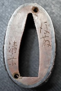

Now I am curious as to the authenticity of the piece and its attribution as I also picked up this piece with a similar style signed Goto Kiyonobu (Having looked into it a bit I think this second one might not be authentic as it is the one on the left that is signed as "Goto" and the right one is signed Kinsha Tomotsune? The left one doesn't seem to match Goto work to me...)
The Goto Senjo piece appears to be of a similar style, has a neat, straight signature and features Nanako similar to other documented Goto school works, as does the fuchi on the right in the above picture although I have no information to go on regarding the artist Kinsha Tomotsune.
Thoughts?

I am doubtful this one is authentic, however I am hopeful that the first one (signed Goto Senjo) is. The style is a closer match as is the mei and the overall quality. These 2 pieces signed "Goto" were bought in two separate auctions from two separate sellers so the authenticity of one should not affect the other.
I've taken a few new photos of the first one with the horses which I'm optimistic about, hopefully I can get some opinions on its authenticity!
Hello Jake , as no one else has commented I will give you the bad news . There is no chance of these being Goto . The workmanship is just nowhere near good enough . You would expect the Shakudo to be a dark bluey black wheras yours are a coffee color . Sorry to ruin your day . Attached is one of my pieces signed Goto Deshi ( I forget the rest ) which will show you what the color should be like .

Hi Jake,
