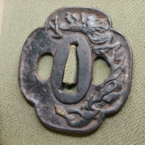

JunS Posted September 27, 2024 Report Posted September 27, 2024 I bought this tsuba for 25$ on catawiki from Japan. Is this tsuba legit? What time period is it from? What school? https://drive.google...Jru_g1Xr?usp=sharing Photos are in the drive folder the file were to big to upload. I would be very happy if someone could help me. Quote
JunS Posted September 27, 2024 Author Report Posted September 27, 2024 It is so shiny because I photographed it with flash. Quote
Dan tsuba Posted September 27, 2024 Report Posted September 27, 2024 Hey Simon! I think I have the exact same tsuba! My opinion is that it is cast iron from the very late Edo period and has probably never been mounted. But then again, what do I know! I am certain other much more knowlegable members than I am will tell you more about it. Quote
JunS Posted September 27, 2024 Author Report Posted September 27, 2024 Thank you Dan, what price did you get yours? Was mine a good deal? Quote

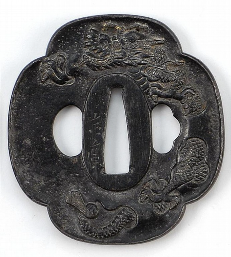

Dan tsuba Posted September 27, 2024 Report Posted September 27, 2024 Hey Simon, I got mine (I guess I bought two, but must have gifted one to a friend) one for $49.00 and the other for $116.00 U.S.. Pictures are attached. My tsuba look a little different than yours. You paid $25.00 for yours. I think that is a fair price. Remembering that brand new, made yesterday, tsuba (like made for iaido swords -training swords) can sell for as much as $150.00! I collect tsuba that are within my budget (no more than $200.00 per tsuba, because of my social security check-ha, ha, ha, etc!) I learn from each tsuba and appreciate them (so much to learn, so little time!). There are many threads on this forum that deal with beginning tsuba collectors and how to collect tsuba. There are also many good books out there for beginners to learn from. There is a member on this forum. His forum name is Spartancrest. Perhaps you can send him a personal message through this forum and he can recommend some good learning books? 1 Quote

Jake6500 Posted September 29, 2024 Report Posted September 29, 2024 With my limited expertise I concur with Dan. No sign of wear around the Nakago Ana, probably never mounted. As Dan has a tsuba with the same design we can assume it is probably cast. As for dating there is some controversy/dispute as to whether cast Tsuba existed in the Edo Period or whether they were only produced later. We can assume it is probably a product of either the late Edo or Meiji Periods. Hard to go wrong with a $25 Tsuba, even if it's cast. 2 Quote
Okan Posted September 29, 2024 Report Posted September 29, 2024 Hi Simon, It’s most likely a cast tsuba made for tourists in the 1970s-80s. It’s not genuine, but don’t worry—buying a cast piece will help you learn and differentiate between fake and real ones in the future. 1 Quote

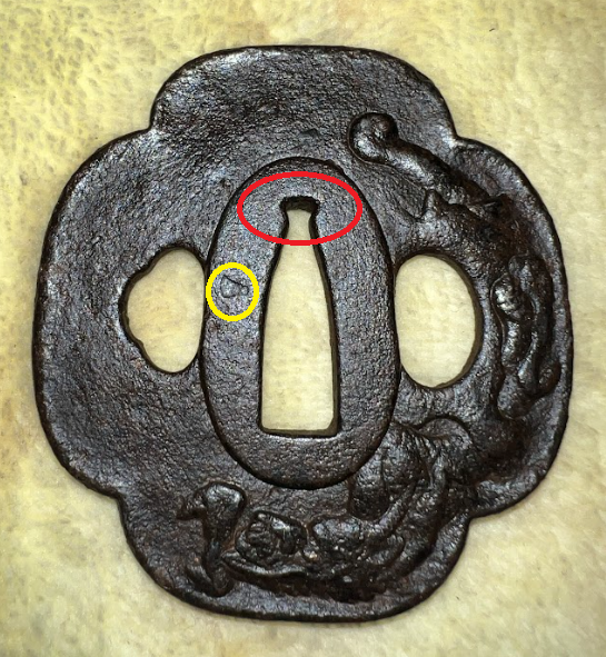

Spartancrest Posted September 30, 2024 Report Posted September 30, 2024 Hi Simon your images show the "ura" side - back side. Normally the "omote" side has the most detail. But I would concur that the piece is cast - hey I have seen a lot worse and it is a useful learning tool. Watch out for the ones with that "mushroom" top of the nakago-ana [cast in for adding sekigane] and the cast bubble/fault on the seppa-dai. 4 1 Quote
Spartancrest Posted October 2, 2024 Report Posted October 2, 2024 On 9/28/2024 at 3:15 AM, JunS said: Is this tsuba legit? Well Simon, Eldreds auctions sold one for $169 [including fees] in 2012 so your $25 was better than that! You notice the "mushroom" top is a constant feature, the "signatures" [fake] are added later and can vary even in who they pretend to be by. https://www.eldreds.....-with-re_BEB03ED54F 1 Quote
