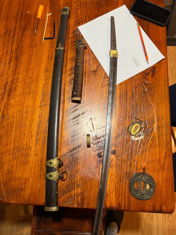

drb 1643 Posted September 20, 2024 Report Posted September 20, 2024 I posted pictures in the translation section and was hoping someone could help me if this is a legitimate Mikasa dirk. The Mei is unlike anything I’ve seen before. Thanks for any information. Tom 1 Quote
Bruce Pennington Posted September 20, 2024 Report Posted September 20, 2024 We saw a similar one before. Had that same stamp and mei on the nakago. Does yours have standard navy dirk fittings? @BANGBANGSAN Quote
drb 1643 Posted September 20, 2024 Author Report Posted September 20, 2024 Yes Bruce, it has the standard navy dirk koshirae. Any views as to legitimacy? Thanks, Tom Quote
BANGBANGSAN Posted September 21, 2024 Report Posted September 21, 2024 10 hours ago, drb 1643 said: Yes Bruce, it has the standard navy dirk koshirae. Any views as to legitimacy? Thanks, Tom Tom I think In addition to having the phrase 皇國興廃在此一戦 (The fate of an Empire is decided by this battle")engraved on the blade, the 甲種 (Type Ko) Mikasa Dirk typically has the swordsmith's name inscribed on the tang. The 乙種(Type Otsu), like yours, usually only has 三笠砲鋼(Mikasa cannon steel)without the swordsmith's signature. However, the Type Ko is generally more commonly seen, while the Type Otsu is less common. http://ohmura-study.net/741.html 5 Quote

drb 1643 Posted September 21, 2024 Author Report Posted September 21, 2024 Trystan, thank you very much for this information. I had no idea that there were two classes. So is the otsu class a machine made blade? Tom Quote

BANGBANGSAN Posted September 21, 2024 Report Posted September 21, 2024 2 hours ago, drb 1643 said: Trystan, thank you very much for this information. I had no idea that there were two classes. So is the otsu class a machine made blade? Tom In July of 1931 (Showa 6), an agreement was made between Japan Steel Works and Suikosha to engrave "Mikasa" and the "company emblem" (the old emblem from the founding period) on the tang of the dirks. However, there exists a letter from Hideaki addressed to the head office in August, expressing his strong objection to mass production, stating, "I absolutely refuse to engage in such quantity production." As a result, Hideaki's signature was not included, and the blades were inscribed with "Manufactured by Steel Works" and forged by his apprentices. There are no known molds or examples of dirks engraved with the word "Mikasa" and the "company emblem," nor with the inscription "Manufactured by Steel Works." I think your dirk is one of those with the company emblem. 2 1 Quote

BANGBANGSAN Posted September 21, 2024 Report Posted September 21, 2024 11 hours ago, PNSSHOGUN said: That is very interesting information, so the Otsu dirk in question was made by the Zuishoha directly and the better versions contracted to Horii Hideaki? There are more than 12 known inscriptions, and based on the variations in these inscriptions, it is assumed that several different swordmaking methods were employed, ranging from fire-forged swords made only with cannon steel to forge-welded swords made with a combination of cannon steel and tamahagane . In July of 1931 (Showa 6), an agreement was made between Japan Steel Works and Suikosha to engrave "Mikasa" and the "company emblem" (the old emblem from the founding period) on the tang of the dirks. However, there exists a letter from Hideaki addressed to the head office in August, expressing his strong objection to mass production, stating, "I absolutely refuse to engage in such quantity production." As a result, Hideaki's signature was not included, and the blades were inscribed with "Manufactured by Steel Works" and forged by his apprentices. Quote
BANGBANGSAN Posted September 21, 2024 Report Posted September 21, 2024 54 minutes ago, drb 1643 said: Fantastic information Trystan. Thank you very much! Tom You got it. It's on Ohmura's website, but the Japanese version has much more information than the English version. English version http://ohmura-study.net/204.html Japanese version http://ohmura-study.net/741.html 3 1 Quote

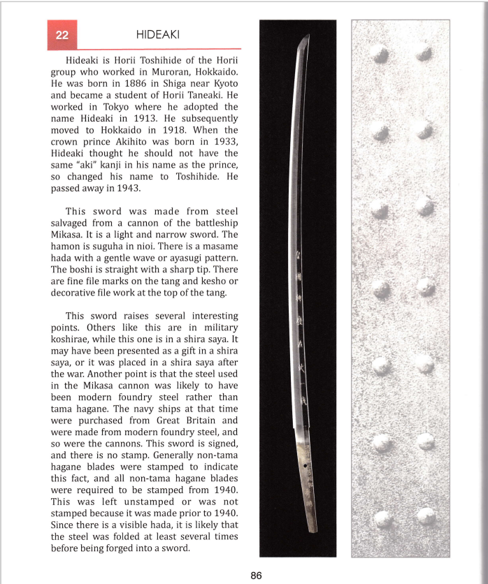

ROKUJURO Posted December 20, 2024 Report Posted December 20, 2024 A side note From a metallurgical standpoint, the MIKASA steel was probably not well suited for blade making as cannon barrels have to be made of especially tough steel with low carbon content to prevent cracking. I doubt that the MIKASA cannon steel was used as single material, but was certainly combined with a hardenable carbon steel. The use of the name MIKASA was mostly a good marketing trick in my opinion. 1 Quote
Brian Posted December 20, 2024 Report Posted December 20, 2024 I think it's general accepted and mentioned somewhere that only a bit of the steel was used, mixed with regular blade steel. So yes...more of a patriotic thing. Quote
Bruce Pennington Posted December 20, 2024 Report Posted December 20, 2024 It's often mentioned that full sized swords were made this way, too, but until now I'd never seen one. Thanks to @Kiipu sharing some pages from "Modern Japanese Swords : The Beginning of the Gendaito Era"; Kapp, Leon; Kapp, Hiroko; Monson, Leo, here is an example: Quote
