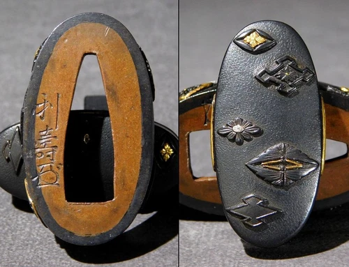

This one is signed on the left https://ginza.choshu...j/r5/008/00_riju.htm   伊藤博文所持 摩利支天厨子  伊藤博文所持 摩利支天厨子
https://www.zacke.at...th-kanzan/?lot=21438  This one on the right, image is pretty dirty.
10947-6-medium.jpg?v=63786242747233
An ebay one signed on the left https://www.ebay.com/itm/276165246574
SUPERB Nara Toshinaga Signed Kamon Fuchi/Kashira Edo original sword antique - Picture 9 of 12
The Walters has a fuchi signed on the left. https://art.thewalte...or/nara-toshinaga-i/   and other examples of his work.
I can't find any Monkey or Eagle - Sorry.
