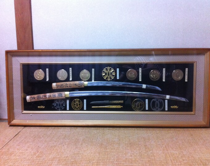

Spartancrest Posted September 13 Report Posted September 13 It may have started out being on a display board or was made for a paperweight "Nambu tekki" cast iron souvenir, they were only meant to be seen on one side. Quote
Lee Bray Posted September 13 Report Posted September 13 Size and weight seem off for a regular katana tsuba. It's about twice the weight, 3-4cm too large and 2mm too thick for the 'dancing crane' tsuba one normally sees. Dale is probably on the money with some kind of display piece rather than a real tsuba. Quote
Spartancrest Posted September 13 Report Posted September 13 57 minutes ago, ROKUJURO said: Something very similar: I think you have found the culprit The texture and 'kao' on the seppa-dai, the eye and nose hole match - censer (kōrō 香炉) burner top. I even found a black one [image is too small for details] 2 1 Quote
