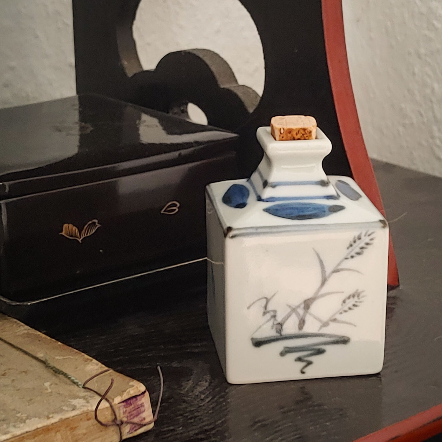

Andi B. Posted October 5, 2024 Report Posted October 5, 2024 I use white mineral oil (DIY-fragranced with clove buds). Only a few drops once or twice a year is sufficient for me - no need to marinate the blades. 1 Quote
