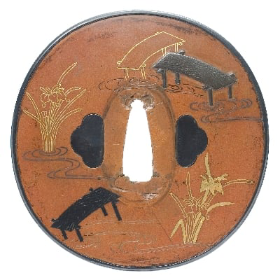

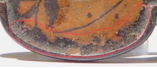

DoTanuki yokai Posted September 11, 2024 Report Posted September 11, 2024 The “corrosion” at the rim looks like urushi for me. It was maybe applied to protect the patina and give the piece more visible structure imho. You can also see it on the umetada example but much thinner. It is wiped off because you only want a thin layer but more remnants stay in the deeper parts. Quote

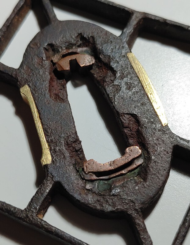

kissakai Posted September 11, 2024 Report Posted September 11, 2024 I bought this for it's age and the mangled seppa area 1 Quote

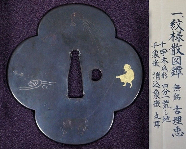

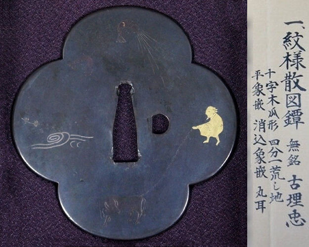

MauroP Posted September 11, 2024 Report Posted September 11, 2024 I think Umetada (or ko-Umetada) could be a good call. Here below a ko-Umetada tsuba (according to NBTHK) and the only ko-Shōami in soft metal I was able to find (which BTW is also not so far from the tsuba discussed here). . 1 1 Quote
Spartancrest Posted September 11, 2024 Report Posted September 11, 2024 3 hours ago, DoTanuki yokai said: The “corrosion” at the rim looks like urushi for me. That's what I was thinking Christian, [you beat me to it - well I have to sleep sometime!] Urushi is a pain to clean off if anyone has tried, but the purists might say it adds to the history and should be maintained, I have seen the damage it can cause on Iron guards - not so much on kinko. Shocking Shingen tissue thin seppa-dai. 2 2 Quote

DoTanuki yokai Posted September 12, 2024 Report Posted September 12, 2024 Without urushi with urushi the reasons I have explained earlier. Without the urushi the engravings would only be really visible in the right light. Like a clear lacquer in modern times the Urushi also protects the surface. Edit2: I changed the pictures ,found some fitting ones but want to add that I removed this patina and urushi later because I was unhappy with it. It works for the explanation I hope. Edit: here you can see that much more urushi will be left close to the rim simply because it’s harder too get wiped off there. 1 Quote
