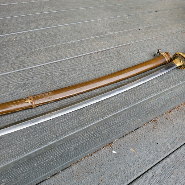

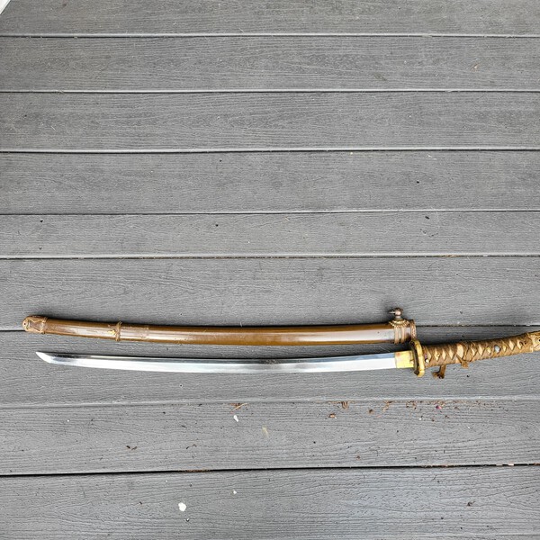

ddily Posted September 9, 2024 Report Posted September 9, 2024 Hello! So I inherited this sword from my wife's great uncle. He was a marine during WW2 and captured this sword while clearing out a bunker during the battle of the Philippines. He has a journal entry talking about it and a photo of him holding it and smiling. I would love some help on what to do with this. I have a friend who suggested I post it here. He gave me a Japanese sword cleaning kit he got while he was in Japan and taught me how to clean it. He is stumped by it. He thinks it is very very very old. Would love to know more about it and how much it is worth as I might be willing to part with it. Quote
PNSSHOGUN Posted September 9, 2024 Report Posted September 9, 2024 Hi Josh, welcome to the forum. Very nice sword, it does appear to be an older blade but we would need photos of the tang to be sure. Would love to see the photo of the Marine holding it. As for care, just keep the blade lightly oiled and nothing more. With such great history, maybe consider keeping it in the family? Quote
Mark S. Posted September 9, 2024 Report Posted September 9, 2024 And be careful about offers made by PM. Know what you have first. 1 1 Quote
Lewis B Posted September 9, 2024 Report Posted September 9, 2024 On 9/9/2024 at 4:56 AM, Mark S. said: And be careful about offers made by PM. Know what you have first. Expand Exactly. Looks like a nice blade that is a good candidate for polish and restoration. But first I would take it to a sword show that has a Shinsa section. San Fran isn't too far from you. 2024 is over but there will be another next year. Looks older than WW2 production, and has 2 mekugi (holes in the tang) which is a good sign for an older blade. Can you measure the Nagasa? (measured from tip directly across to the mune machi (notch that the habaki sits against). Quote
Bruce Pennington Posted September 9, 2024 Report Posted September 9, 2024 The older blade has been fitted for the war in Type 98 Japanese officer fittings. You can read about them here: http://ohmura-study.net/934.html Like John said, a close-up of the nakago (tang) will help the guys with date estimates, and if there is a smith name. The nagasa measurement HB is asking for is here: 1 Quote

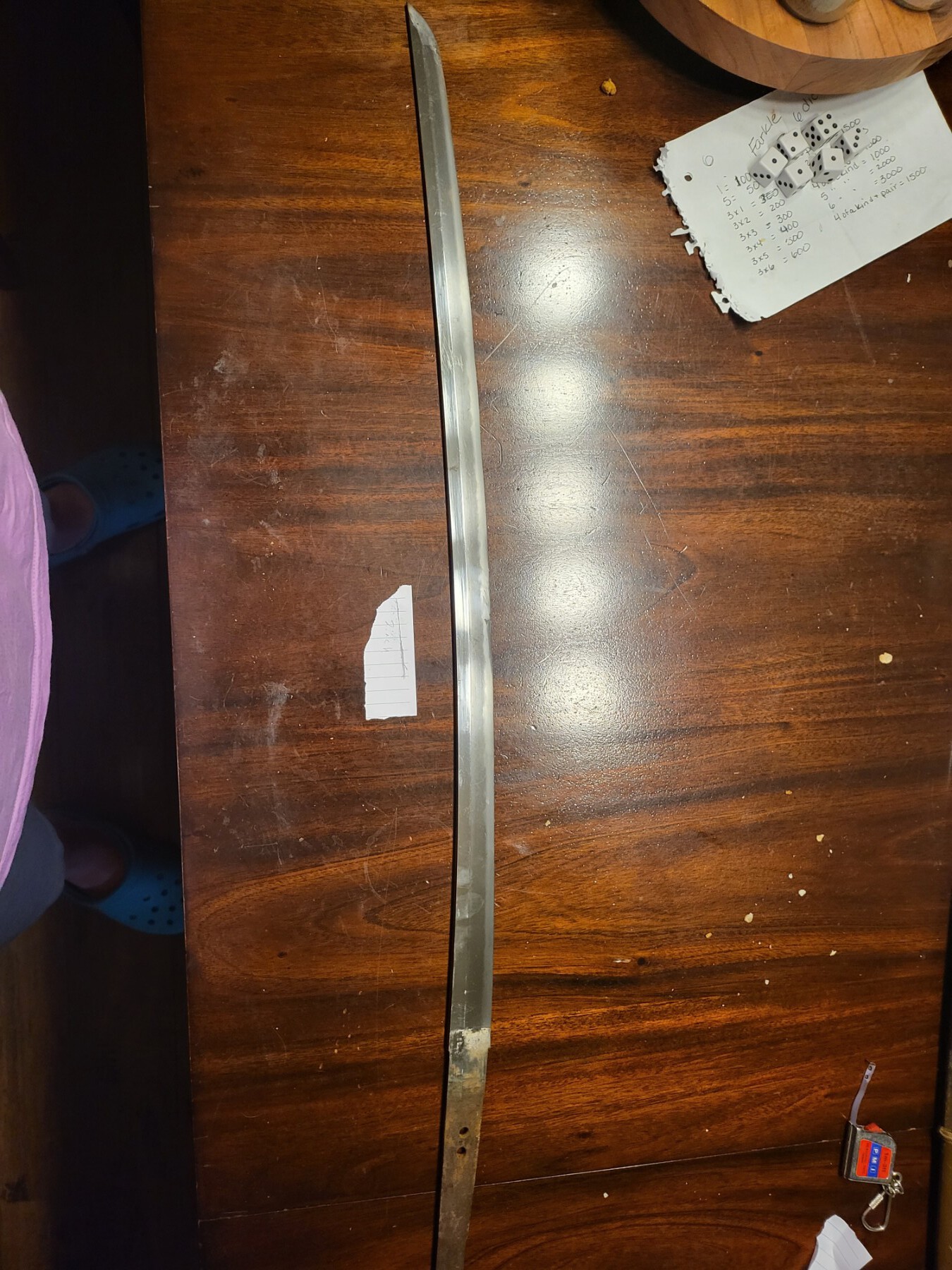

Grey Doffin Posted September 9, 2024 Report Posted September 9, 2024 Hi Josh, Do not use soot and tape and do not listen to anyone who recommends it; it causes damage to the patina. A clear photo of each side of the tang, taken with a raking light (from the side to better show markings) and on a dark background will do fine. Here you will find a care and handling brochure; you should read it twice but use micro fibre cloth rather than uchiko to remove old oil: https://nbthk-ab2.or...ord-characteristics/ Grey 1 Quote

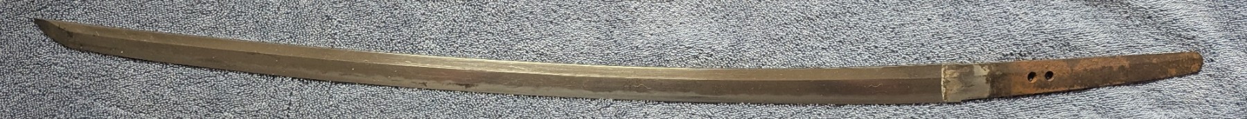

ddily Posted September 10, 2024 Author Report Posted September 10, 2024 67.5cm nasaga 3cm kissaki 18.5cm nakago Total length 85.5cm Quote
PNSSHOGUN Posted September 10, 2024 Report Posted September 10, 2024 Could be late Muromachi Bizen (1500s), looks to be in good condition. 1 Quote

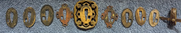

Bruce Pennington Posted September 10, 2024 Report Posted September 10, 2024 On 9/10/2024 at 1:20 AM, ddily said: How did you figure that out? Expand Years of steady, my friend! And specializing in that kind of thing. The fittings are a quality upgrade. The pierced tsuba and 8 seppa are always on quality swords. Quote
ddily Posted September 10, 2024 Author Report Posted September 10, 2024 On 9/10/2024 at 5:08 AM, Bruce Pennington said: Years of steady, my friend! And specializing in that kind of thing. The fittings are a quality upgrade. The pierced tsuba and 8 seppa are always on quality swords. Expand That makes complete sense, you see enough and learn over time, you gain a trained eye. Consider me very ignorant, what does that mean? Quote

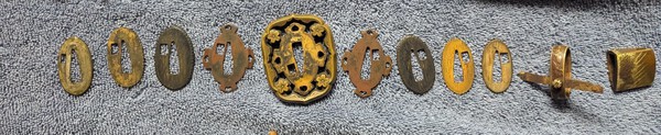

ddily Posted September 10, 2024 Author Report Posted September 10, 2024 The tsuba and seppa are also numbered here is a picture of that Quote
David Flynn Posted September 10, 2024 Report Posted September 10, 2024 Looks, Shinshinto to me. But it needs to be submitted to a shinsa. I'm basing this on the colour of the rust and the two holes. I've seen quite a few Shinshinto and Gendaito, with holes like this. 3 Quote
Franco Posted September 10, 2024 Report Posted September 10, 2024 I'm skeptical that this an "old" sword and second the thought that this may be a Shinshinto sword. Quote

ddily Posted September 10, 2024 Author Report Posted September 10, 2024 Slight update, I sent an email to Ted Tenold, this is what he said: I’ve looked over the images of your sword. It’s really difficult to clearly define many details from images, though you have done an admirable job in photographing the sword. It looks like it could be a candidate for restoration. Looks maybe early 17th century or perhaps very late 16th century. Could be a candidate for restoration but would ultimately require an in-hand evaluation to confirm it’s condition and workmanship. The koshirae is little better than average quality Type 98 Imperial Japanese Army Shingunto, in which the older blade has been fitted. There were a number of professional shops that supplied officers with the service of remounting older swords into new mountings, or supplying them with newly made traditional or non-traditionally made swords as military sidearms. He also said he is currently not accepting new projects and referred me to reach out to a local where I am located. I am going to have the blade inspected in person Friday. Happy to provide more updates 1 Quote
David Flynn Posted September 10, 2024 Report Posted September 10, 2024 As I said earlier, it needs to go to shinsa. The photo's really don't help. Quote
Grey Doffin Posted September 10, 2024 Report Posted September 10, 2024 Hi Josh, It is good that someone who knows more than you is going to see your sword in hand but I suggest you go that far and no further for now. You don't know anywhere near enough to make informed decisions about possible restoration and shinsa. Polish and shinsa may be appropriate for the sword but there is no reason to hurry; polish does nothing to preserve the sword - a light coating of oil does that. See: I'm new to Japanese swords and I want to get my 1st sword polished and/or have koshirae made for it. in FAQ under Nihonto Info above. The more you know before you spend money on the sword the happier you'll be with the results. Grey 2 2 Quote
