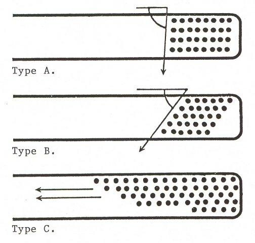

Spartancrest Posted September 9, 2024 Report Posted September 9, 2024 On 9/9/2024 at 6:08 AM, Franco D said: I've seen 3 and 5 punch with my own eyes. Expand From Markus Sesko's book "Encyclopedia of Japanese Swords" pages 315 - 316 nanako (魚子) – Nanako means literally “roe.” In earlier times, many different characters were used for nanako, like (魶子), (七子), (粟子), or (鉾子) but these passed out of use. Nanako was frequently applied by specialized craftsmen, the so-called nanako-uchi (魚子打ち) or nanako-maki (魚子蒔き). According to the Japanese nomenclature, nanako is “beaten” (utsu, 打つ) or “sown” (maku, 蒔 く ). For this, specially made nanako chisels (nanako-tagane, 魚子鏨) were used. According to the arrangement of the “grain,” we know different terms for nanako surfaces, like Tatsuta-nanako (竜田魚子, horizontal nanako which resembles the Tatsuta-gawa [竜田川] in Nara), gunome-nanako (互の目魚子, wavy nanako), daimyō-shima-nanako (大名縞魚子, nanako where between each row of grain a polished row is applied), or shaka-nanako (釈迦魚子, very coarse nanako). Nanako was mostly applied to fittings made of shakudō and sometimes also to shibuichi and suaka surfaces, and we know examples by Tanaka Kiyotoshi (田中清寿) who applied nanako also to iron. As you can see there are single or multiple punches that were used. 5 1 Quote

Jesta Posted September 9, 2024 Author Report Posted September 9, 2024 On 9/9/2024 at 9:04 AM, Matsunoki said: It would be very interesting to see which variety of the above punches were used by the Goto masters in the creation of their very fine nanako. Anyone have any knowledge on that? The one above with 20 recesses on it would be no good when trying to follow the curvature of a tsuba but would work well on a Kozuka. A single punch would work perfectly on a tsuba, (and maybe the triple? Not sure.) Expand I think that one of the ways to tell would be to see if the nanako line up or if they are alternating (if you see what I mean): OOOOO OOOOO OOOOO or OOOOO OOOOO OOOOO The large punch would have them all in lines, whereas a single punch (in Ford’s video) would have them alternating. You can see that in Andi’s example they are alternating on the kogai, so maybe it would be related to the quality of the work. I can imagine that Goto would insist on the very highest quality craftsmanship… 1 Quote

1kinko Posted September 9, 2024 Report Posted September 9, 2024 So, straight line nanako (like the video of Ford making nanako at the V&A) are enough of a problem even with etched guide lines- how do you think curved nanako would be done without guidelines? I’m sure there were nanako-shi who could do it but, imho, the smarter or less skilled would have engraved guidelines first, perhaps by scribing from the edge to the center at the proper interval. Some deeper guidelines seem to me to help create squarish nanako, but not leaving the precise distance between individual nanako can also result in squarish or pentangular nanako when seen up close. With regard to multiple nanako punches, we often see their use on furniture and armor. There is a good article on the building of Buddhist butsodon that shows a wide variety of punches used by these metal workers (sorry but this is the only information I have on my hard copies- WEB.kanagu.PDF [2006]; Section 7: The work of the decorative metal fittings artisan (kazari kanagu shi). Quote

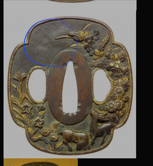

Steves87 Posted September 11, 2024 Report Posted September 11, 2024 On 9/9/2024 at 5:55 PM, Matsunoki said: I guess it’s the old “practice makes perfect”…..although skill levels, eyesight and patience come into the mix. Another question……if the artist made a bad “strike” ie missed his mark was/is there a way of recovering the situation? It must have happened - resulting in an “OSM” Expand That is a good question and I have always just thought "it is wrecked", but, thinking about it, you could locally flatten the area and start again... it will make a depression of sorts, but it has got to be cheaper than starting again. In no way would I say this is something you can do on a high end item, but something like Nagoya Mono would probably handle it... see the circled area of an image I got from the below link, flattening out nanako to remedy a miss-placed strike would create a waving nanako base as seen. 1 Quote

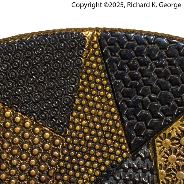

Spartancrest Posted September 15, 2024 Report Posted September 15, 2024 I have been looking for this for some time - many types of nanako on the one tsuba. https://www.metmuseu...lection/search/35144 Unfortunately the museum does not have much information. Image has been lightened. 1 Quote

Spartancrest Posted September 15, 2024 Report Posted September 15, 2024 Another more colourful example in the V&A https://collections..../item/O465753/tsuba/ 2 Quote
