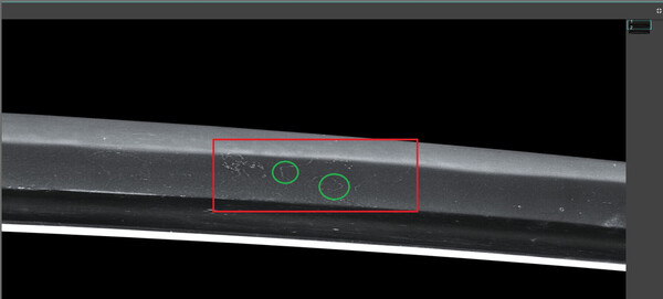

Nagayama describes chikei as black(Page 87), Sesko describes chikei as blackish, the NBTHK say,  that chikei are dark. You see chikei as white. That can only mean, that you have more and better information than the majority. Please, share your knowledge with us. At least I want to know...
Uwe G.
PS: I would descibe the white lines as jinie due to the lamination.
Jacques, those are totally different from the examples you posted previously and which were highlighted by Colin.
In this recent batch there is no “Rai hada” in that there is no shingane showing. The previous ones clearly have shingane as they are the large dark areas (the ones that you suggested showed chikei). Read the Markus Sesko’s article: Rai hada is a different colour to the kawagane and it’s equivalent in Aoe blades is Namazu hada, which looks different to the surrounding metal and has the quality of cat fish skin.
What you have highlighted immediately above are not chikei nor shingane, just some rougher grain/ small kitae ware or perhaps as Uwe says, ji nie in the example with the more consistent grain.

To me, these "white wavy lines" do not seem ji-nie at all
Rather, I think that it is an accentuation of the lamination as a result of the togi-shi work where this lamination seems to "open" a little if the stone of the right hardness is not used
I'm appalled by the ignorance and lack of culture of some people: if the chikei appear white in the photos, it's only a matter of light reflection. You'll find the same thing on this tachi attributed to Norishige. That said, I give up and leave you to your beliefs, it's not my problem.

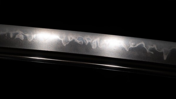

Jacques - with all due respect to you
I agree that chikei has a specular sheen in daylight
But when taking photos in a room, chikei does not behave like this
For the photo you gave as an example, the lights are positioned so that there is no reflection of light from the surface of the blade
I've taken several thousand shots of blades and I've never photographed a chikei like this
Different blades and different light conditions
