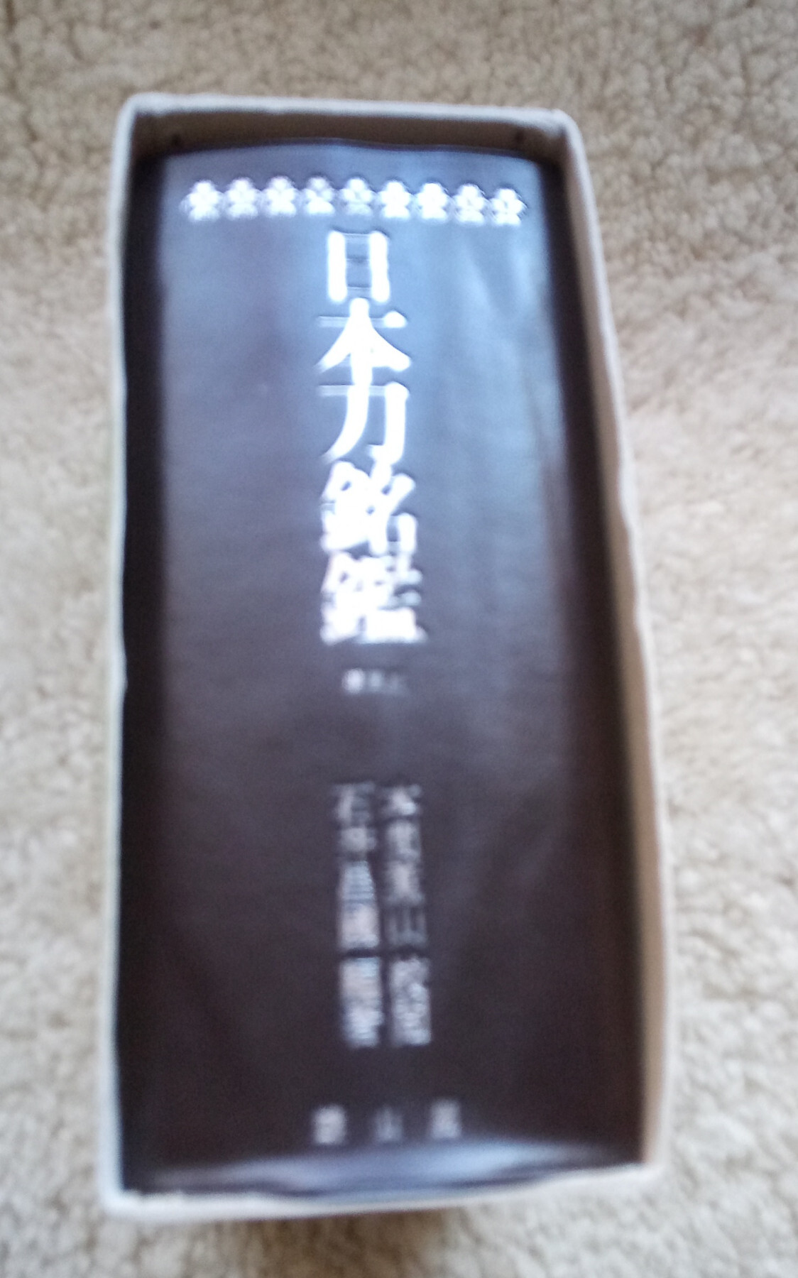

Jacques Posted September 18, 2024 Report Posted September 18, 2024 Quote Nihonto Meikan” (日本刀名鑑): Describes the evolution of Japanese sword forging methods and highlights the importance of lamination techniques developed in the Kamakura period. It mentions how the use of different steel types (shingane for the core and kawagane for the outer surface) became standard during this time. Which page? I have this book. I've yet to see a Kamakura sword showing shingane. From Nagayama's connoisseur book page 33 Quote

Gakusee Posted September 22, 2024 Report Posted September 22, 2024 On 9/20/2024 at 4:13 PM, Jacques D. said: If there's one thing I don't accept, it's people lying to discredit me. Until proven otherwise, the Nihonto meikan I own is a swordsmith's repertory, it does not deal with manufacturing techniques (the subject is not even broached). As for the Kokon Kaji Biko, this book was written by the shogunate's tester : Yamada, Yoshimutsu , and I challenge you to show me where it says what you claim it says. https://www.digitale.../bsb11175205?page=,1 ps the worst is that there are 4 (??) who like without even looking if what you say is true or not. Jacques, apologies for the confusion: it is not the Meikan but the Taikan. The Nihonto Taikan , Koto Volume 1 the section about Rai school. One could refer for instance to pages 40-55. While they do not explicitly mention the terms shingane or kawagane, some of the pages talk of the “weak skin” of the Kunitoshi when running some comparisons to Kunimitsu or less of the weak skin in Kunimitsu and comparing against Awataguchi Yoshimitsu vs the other, and reference the Raihada in there as the weak skin. The way I interpret this is they infer a surface or top layer that is sometimes weak and sometimes differential steel shows. 1 Quote

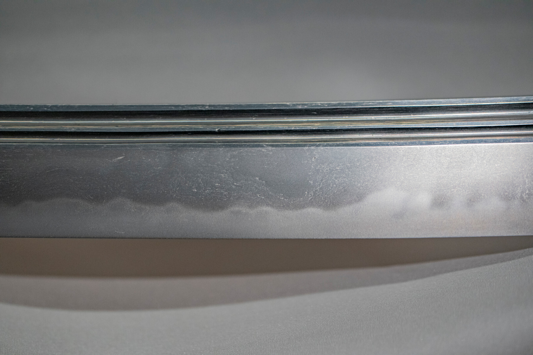

CSM101 Posted September 24, 2024 Report Posted September 24, 2024 Part I It is always good to see a civilized discussion. With opinions based on facts. This one here seems to be a little bit too theoretically. That´s why you can see now some of the discussed points. From "Jigane & Jihada", sword Nr. 31 Rai Kunimitsu, juyo token with Rai hada, end of Kamakura and Nr. 32 Ko-Aoe Koretomo with sumi-hada. mid Kamakura, Tokubetso Juyo. Uwe G. 3 Quote

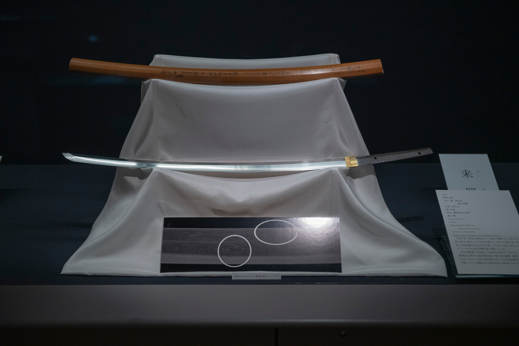

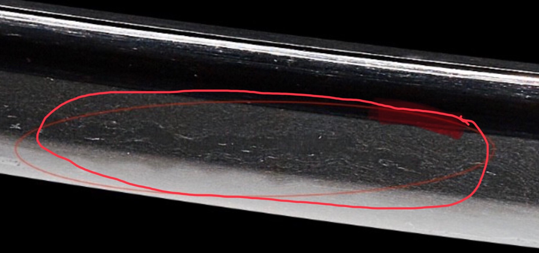

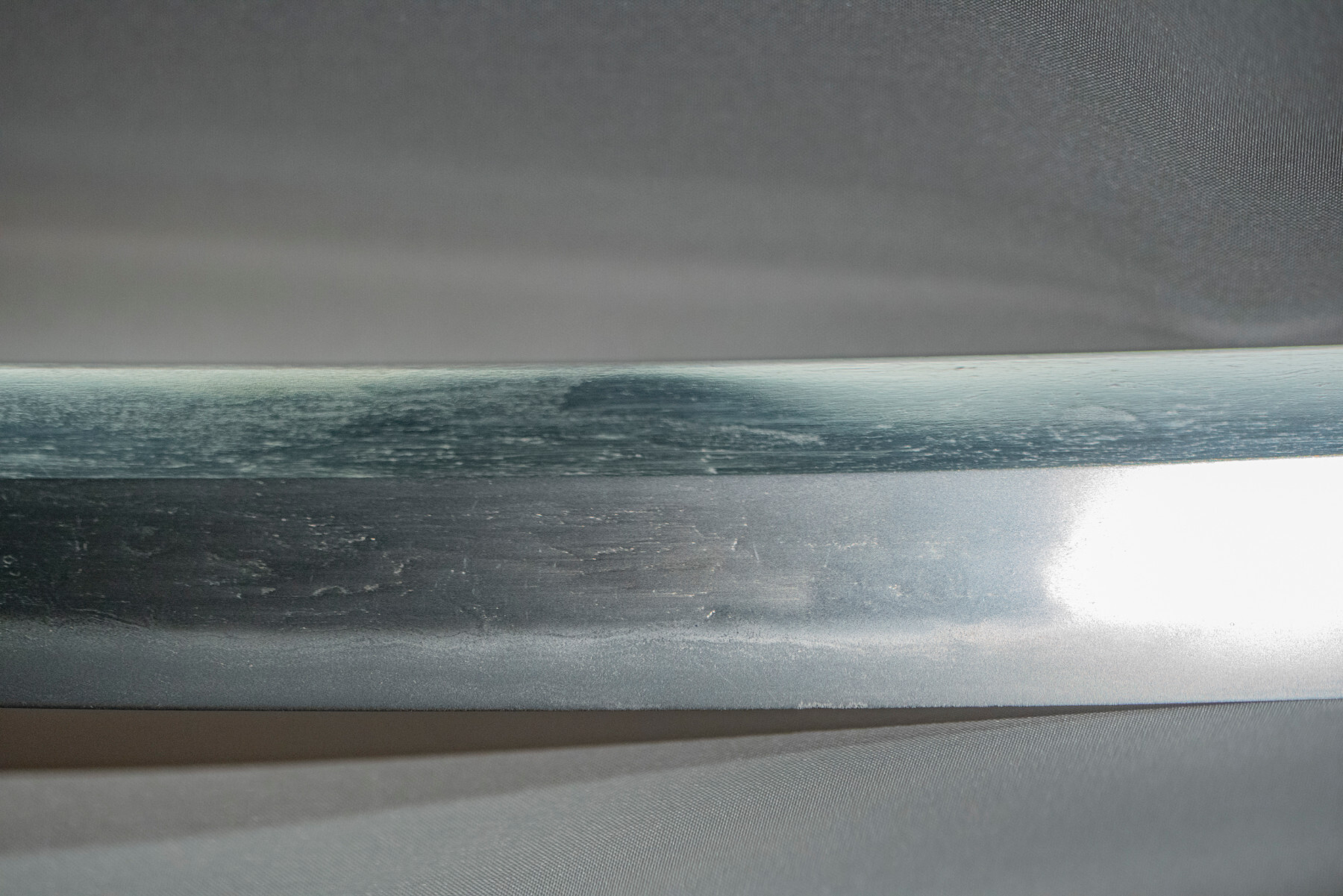

Lewis B Posted September 24, 2024 Report Posted September 24, 2024 Some blades seem to completely embrace the Shintetsu vibe. Take this Juyo Sekishu Naotsuna Quote
Shugyosha Posted September 24, 2024 Report Posted September 24, 2024 As has been said before, it’s us westerners that have the problem with delaminations/ shintetsu. The Japanese focus on the hamon. 1 Quote

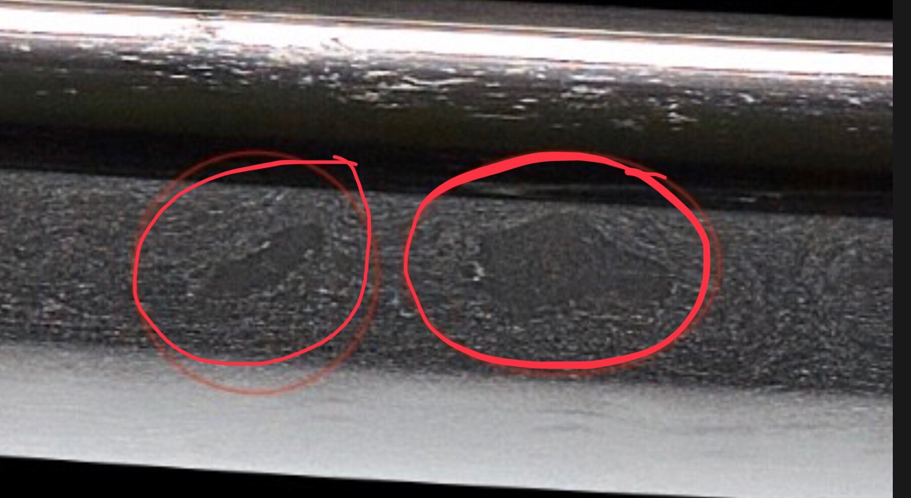

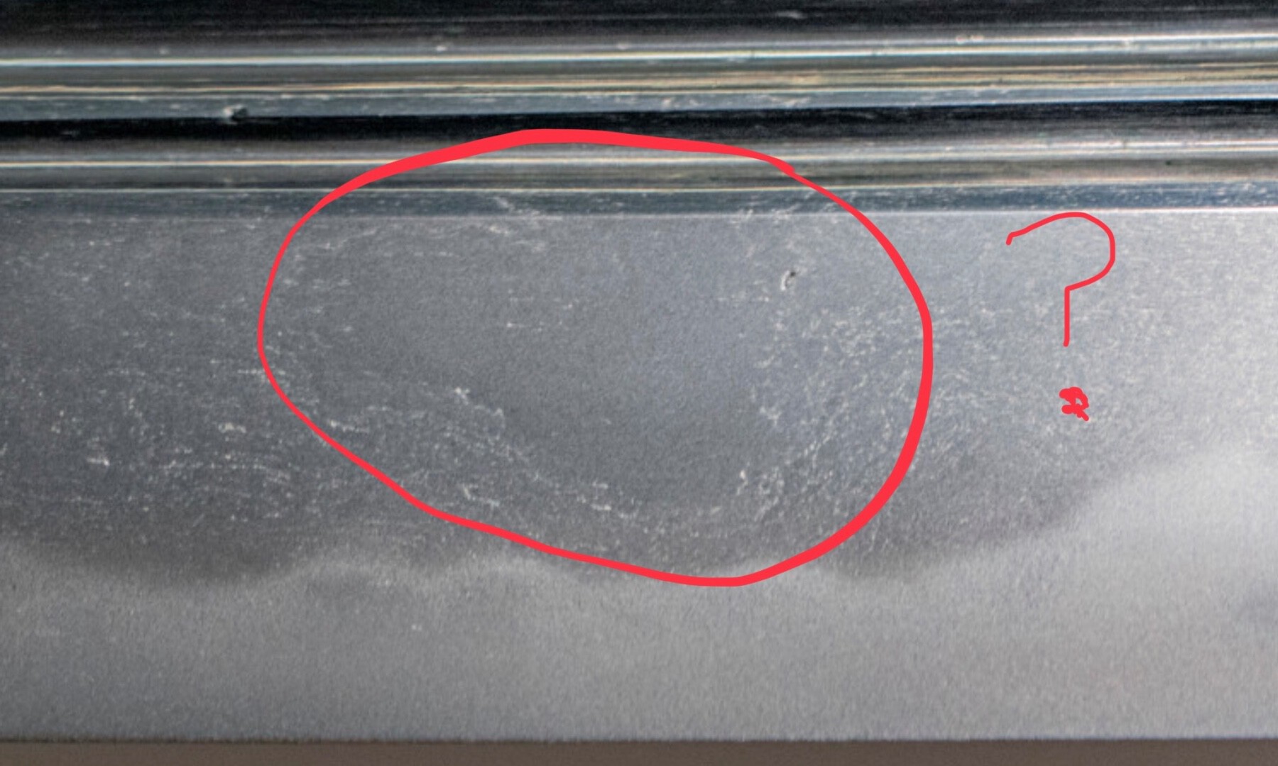

Jacques Posted September 25, 2024 Report Posted September 25, 2024 19 hours ago, Lewis B said: Some blades seem to completely embrace the Shintetsu vibe. Take this Juyo Sekishu Naotsuna Where do you see shintetsu ? I think you need dot learn hada. Last words about Rai hada, you can see chikei in this area can you see chikei in shintetsu ? 2 1 1 1 Quote

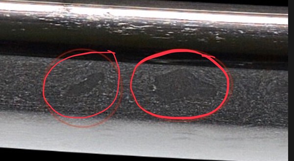

Lewis B Posted September 25, 2024 Report Posted September 25, 2024 57 minutes ago, Jacques D. said: Where do you see shintetsu ? I think you need dot learn hada. Last words about Rai hada, you can see chikei in this area can you see chikei in shintetsu ? Are you saying the areas I circled in red are not Shintetsu? There are none of these features on the ura side. Quote
Matsunoki Posted September 25, 2024 Report Posted September 25, 2024 1 hour ago, Jacques D. said: Where do you see shintetsu ? Just in case @Jacques D. missed the red circles…..enlarged for his benefit. 1 1 Quote
Matsunoki Posted September 25, 2024 Report Posted September 25, 2024 ….and one of the other images … 2 Quote

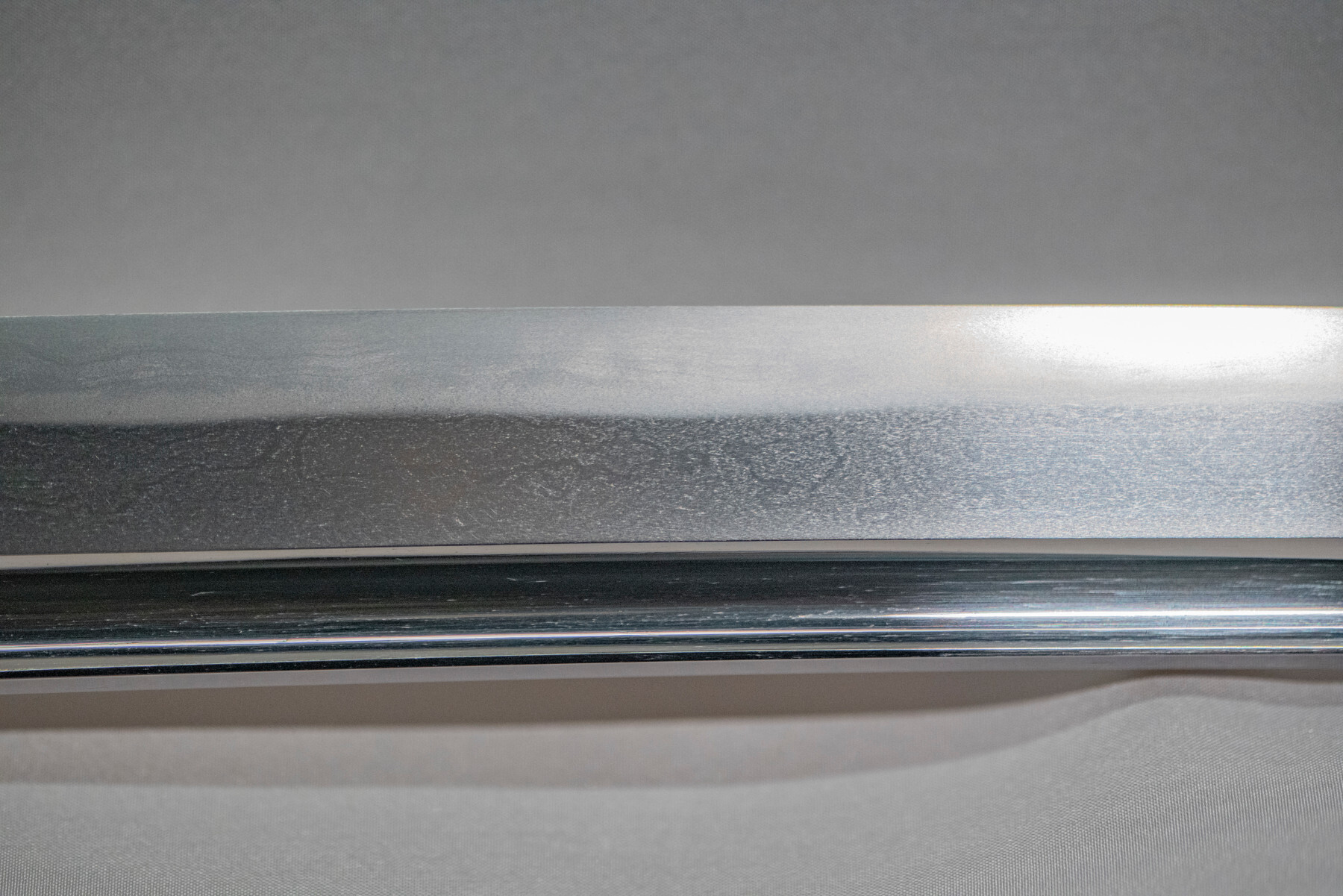

CSM101 Posted September 25, 2024 Report Posted September 25, 2024 Some people m i g h t not know the difference between chikei and Rai hada. So, here again an example: katana, attributed to Rai Kunimitsu; Tokubetso Juyo Token. The dark lines are chikei. In my eyes there is a difference to Rai hada. But what do I know? Or the NBTHK? Uwe G. Quote
Rivkin Posted September 25, 2024 Report Posted September 25, 2024 25 minutes ago, CSM101 said: Some people m i g h t not know the difference between chikei and Rai hada. So, here again an example: katana, attributed to Rai Kunimitsu; Tokubetso Juyo Token. The dark lines are chikei. In my eyes there is a difference to Rai hada. But what do I know? Or the NBTHK? Uwe G. That's one sexy chikei blade! Yukimitsu? Or maybe even Sadamune? Edit: I just noticed its Rai Kunimitsu... wow! Quote
