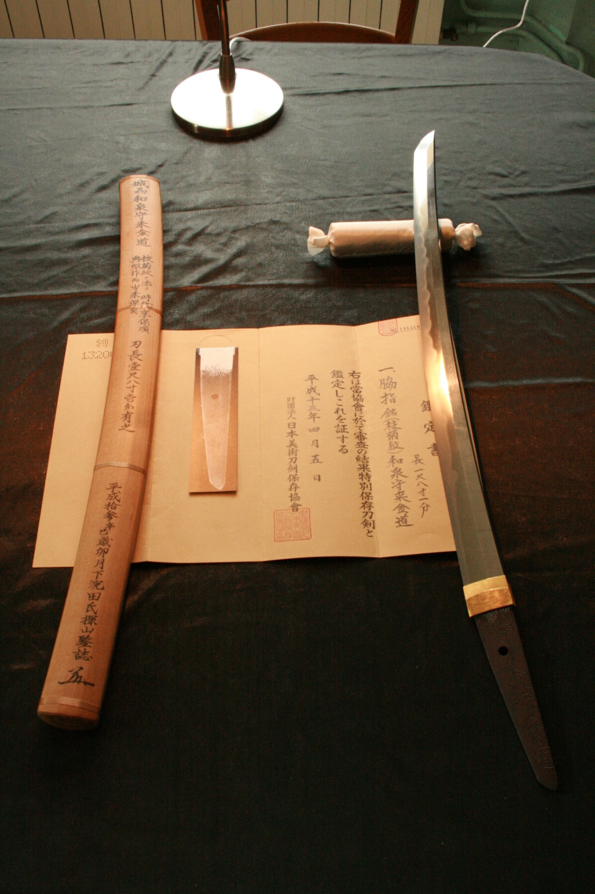

Jacques Posted September 8, 2024 Report Posted September 8, 2024 Quote Finally, as we know well, even experts disagree. There are swords which receive different attributions when submitted to the NBTHK and NTHK or even the same sword which went to different hands (eg Nisshu, Honma, later NBTHK certificate etc). Expand Is spoke only fot the NBTHK as i don't trust others organisations My personal experience, I had a sayagaki made by Tanobe san for a wakizashi I owned. The kissaki on this waki has a major flaw (inclusion) and yet the sayagaki attests that the workmanship is excellent. Tanobe san has found a way to make ends meet, and you mustn't idealize him too much - he's a bit venal. Nothing to compare with shinsa's fees 1 Quote
Gakusee Posted September 8, 2024 Report Posted September 8, 2024 On 9/8/2024 at 9:43 AM, Jacques D. said: Is spoke only fot the NBTHK as i don't trust others organisations My personal experience, I had a sayagaki made by Tanobe san for a wakizashi I owned. The kissaki on this waki has a major flaw (inclusion) and yet the sayagaki attests that the workmanship is excellent. Tanobe san has found a way to make ends meet, and you mustn't idealize him too much - he's a bit venal. Nothing to compare with shinsa's fees Expand Thanks for this illustration, Jacques. I cannot see the text well - where does the Rai Kinmichi sayagaki say that it is with excellent workmanship? But even if we disagree on evaluations of excellent / very good / good/ adequate / poor as these are qualitative evaluations, we are somewhat deviating from the view expressed earlier of attribution objectivity. Sometimes, I also do not understand how certain swords are evaluated as excellent, when I see jigane that stands out and rough hada. But the NBTHK and Tanobe sensei say excellent workmanship etc. I take it as a lesson that perhaps that smith could have hadatachi or whatever, or the “brightness of the jiba” is more important than tightness of jihada, or the “clarity of the hamon and consistency of nioiguchi” are more significant than what I perceive to be an exciting hamon (ie niesuji and hataraki within) etc etc etc and that I need to learn more. This has happened also at various times when I have visited the TokuJu shinsa and seen some of the swords elevated to that level and scratch my head. However, this has nothing to do with Tanobe sensei. Also you raised the issue of sayagaki being paid and I am raising a parallel example - Juyo shinsa also being paid. The NBTHK has also made a way of “making ends meet” by charging fees for their shinsa. In fact, some sceptics are being increasingly concerned by the very varied and bewildering behaviour of the last few shinsa, with rejections of swords which are far superior to those actually being passed at Juyo or Tokubetsu Juyo level. But that’s a discussion for another time and I am not sure I wish to go into that on this public forum and disseminate speculations or inside knowledge. In principle, I agree that we should not idolise individuals and seek several opinions and do our own homework. Also, it is normal for retired people to also undertake “consultancy” services the world over. So, taking as many educated opinions as possible is always the best approach. 4 Quote
