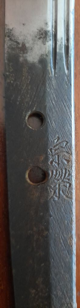

Davis Posted September 9 Author Report Posted September 9 Same subject, different sword. I have limited reference material so would welcome opinions. Quote
Rivkin Posted September 9 Report Posted September 9 I am bad at reading kanji, but this looks like Muneyoshi 宗榮 which can also go as Soei. The style of yasurime and patina - from Kambun to WW2 period. The problem is that yasurime and nakago generally look ok for Harima lineage, but the writing does not really match its style. Otherwise its not a common name and I don't really see any matches. On the other hand the writing itself does not scream "gimei", but its not of great quality. This is where going through books would help, there were many generations and maybe one signed like this. 2 Quote

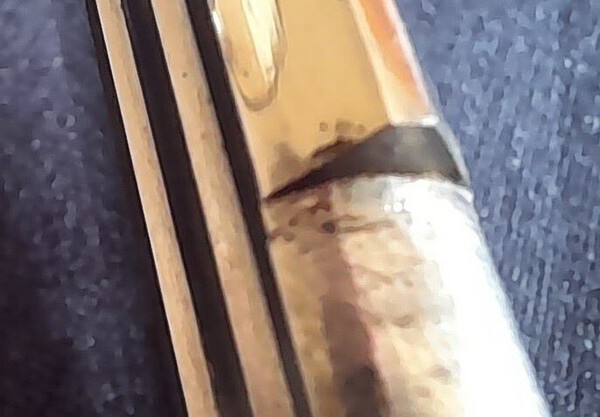

Davis Posted September 10 Author Report Posted September 10 John, hopefully this picture will show up the area of corrosion much better. Kirill, thanks for that information, this sword ( 2nd ) also has mitsumune. Quote
Shugyosha Posted September 10 Report Posted September 10 Hi Mick, Based on the photo of the first blade you've just posted, I don't think that the mei is a later addition than the corrosion. Some water has got into the tsuka and caused that corrosion around the mekugi ana and you can see the same coloured rust at the bottom of the strokes of the kanji adjacent to it. That said, I think Kirill's comments about the quality of the carving of the mei are valid and the shape of the nakago/ nakago jiri as per Geraint's comments would put me off - some more authenticated examples below. It's a biggish name, so a target for gimei - so if you're going to buy it, pay a price consistent with it being an unsigned blade. https://www.samuraim...u-hozon-certificate/ http://sanmei.com/co...nts/en-us/p2348.html https://nihontoantiq...esada-sword-fss-760/ As regards the second one, I feel that's the more interesting of the two based on the photos shown: mitsu mune usually suggests that more care has been taken over the blade's manufacture and is often considered a nod towards smiths working in the Soshu tradition, and the double hi seems to add a graceful look to the blade but it's hard to tell much more from these pictures alone If you're genuinely considering buying either or both of these blades then you need some better photos of the full blade and detail shots including the boshi, hamon and jigane and their measurements too as that feeds into an evaluation of the price. If you can see them in hand too, so much the better. 1 Quote
Davis Posted September 11 Author Report Posted September 11 Thanks very much for your reply and those links John. I own both swords. The first was bought very cheap. I've had the Munehide/Muneyoshi for many years and still don't understand what I actually have, it's an enigma. Downside to it is that it does have some tiny rusts pots. I will provide a few more details when time permits. This picture doesn't show much, I will attempt to do better. Thanks for your responses. 1 Quote

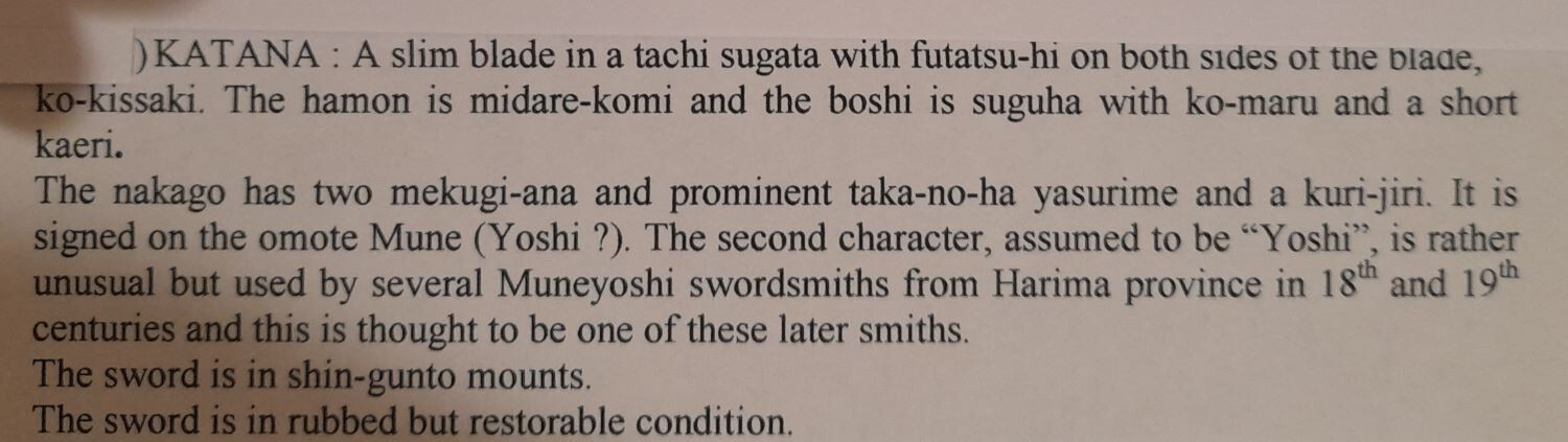

Davis Posted September 11 Author Report Posted September 11 This was a description of the sword given to me years ago by a collector/author. 1 Quote
