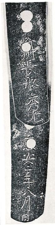

Veli Posted December 27, 2009 Report Posted December 27, 2009 Hi! Please take good care of this one! My quick translation: Bishu Osafune Hidemitsu Eiwa ni nen hachi gatsu hi (August 1376) This is a Bizen Kozori group tanto from late Nanbokucho! The smith's name was Hidemitsu. He was the second generation Hidemitsu. He is rated a high-level smith! I am not sure about the authenticity of the signature, but I compared it to a reference I have (Toko Taikan p. 523), and found no significant differences. The oshigata is not very clear in the said book, however. Furthermore, the engravings on the blade look skillfully made, which is a good thing! More knowledgeable members hopefully verify my analysis... In any case, this is a very interesting and possibly a valuable tanto! BR, Veli Quote
Veli Posted December 27, 2009 Report Posted December 27, 2009 Compared to the signature example supplied by Franco, there are differences. Fujishiro example is 1st gen, however. I leave further discussion to experts... BR, Veli Quote
John A Stuart Posted December 27, 2009 Report Posted December 27, 2009 It doesn't look too far off the tachi example in Fujishiro. John Quote

Bugyotsuji Posted December 27, 2009 Report Posted December 27, 2009 Small point, but the Nakago says Bishu, and the Saya says Bizen. Quote
Veli Posted December 28, 2009 Report Posted December 28, 2009 Here's the tachi example from Fujishiro, which was mentioned by John. BR, Veli Quote
Jean Posted December 28, 2009 Report Posted December 28, 2009 I am not convinced taking into account the first 2 kanji, Bi Shu. In the tanto mei the Kanji "shu" is very special Quote

Stephen Posted December 28, 2009 Report Posted December 28, 2009 to my ol eyes it looks dang close to the tachi mei. mos deff one for shinsa. Quote
reinhard Posted December 29, 2009 Report Posted December 29, 2009 Some features look doubtful, but the mei is good enough to have it checked by an expert. Therefore the blade should be treated with utmost care from now on. If it turns out to be genuine work, it will be quite a precious discovery. For those who like to investigate any further, here's an example of HIDEMITSU's mei on another tanto dating from the same year: reinhard Quote

Grey Doffin Posted December 29, 2009 Report Posted December 29, 2009 M. Lee, No one is questioning the honesty of the last owner of of yourself. Signatures of important swordsmiths have been added to later blades (forgeries) ever since swords have been signed. Much like with important signatures on oil paintings, signatures on swords have to be considered carefully. Grey Quote
Jean Posted December 29, 2009 Report Posted December 29, 2009 Mei provided by Reinhard is more convincing,===>SHINSA- meanwhile preserve it. Quote

george trotter Posted December 30, 2009 Report Posted December 30, 2009 Reinhard said Some features look doubtful, but the mei is good enough to have it checked by an expert. M. Lee asked What features do you find that may be doubtful. George Trotter Quote
Toryu2020 Posted December 30, 2009 Report Posted December 30, 2009 FWIW- I would want to see the jigane to see if it says Bizen. That said to my eye the chisel is too heavy in the longer strokes both horizontal and vertical. The short strokes in the SHU seem very heavily punched. The spacing seems off and the characters do not "stack up" on a straight line. The Tsuki in the date character looks wrong with that long tail and the HI seems heavy. Given the small number of control examples likely all of this could be accounted for so yes, it needs further research and even if the mei proves wrong the blade shows plenty of promise and needs to be well cared for. M.Lee you have some mighty good luck it seems... -tom Quote
Jacques Posted December 30, 2009 Report Posted December 30, 2009 Hi, I don't like the horimono, the tip of the ken lacks of symmetry, and the back of the bo-bi seems odd. Quote
reinhard Posted December 31, 2009 Report Posted December 31, 2009 george trotter said: Reinhard saidSome features look doubtful, but the mei is good enough to have it checked by an expert. M. Lee asked What features do you find that may be doubtful. I don't like the package. The saya-gaki looks doubtful and the habaki is not worth of a HIDEMITSU blade. There are minor irritations as far as the horimono are concerned. Jacques pointed them out already, but they don't really matter, for they could be due to careless treatment in the past. Anyway, this blade should be put to the test. It has a good chance to be worthwhile. reinhard Quote
