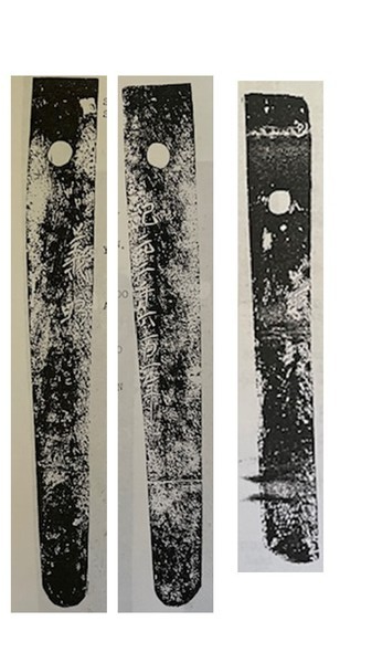

Oshigata below (Fuller & Gregory, 1985):
1. Mishina Yoshikane (Seki stamp?).    2. Noshu Mishina Yoshikane (sakura/Sho stamp).   3. Mishina Yoshiaki (Seki stamp).   4 & 5. Yoshiaki (Seki stamp).  "2601 years of Japanese Empire" (1941).                  Blade also has horimono of dragon chasing pearl, and other side Buddhist bonji .   6. Yoshiaki (Sakura/Sho stamp)
