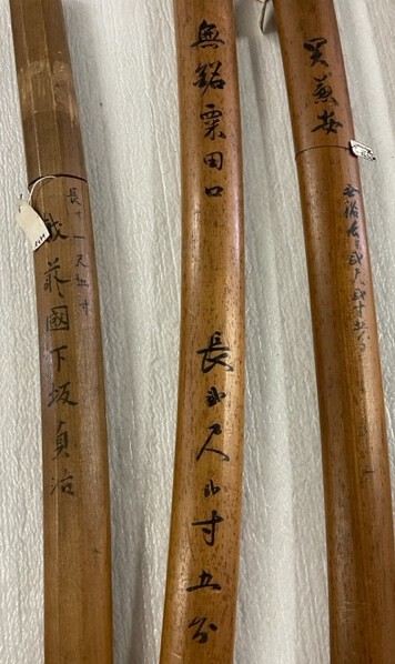

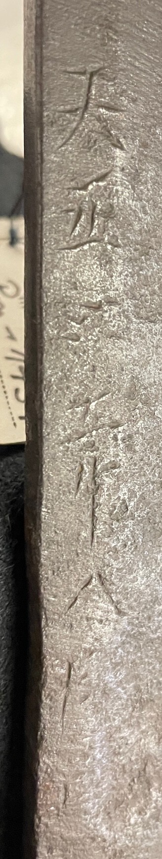

Lewis B Posted September 2, 2024 Author Report Posted September 2, 2024 Katana/tachi #1 Katana/tachi #2 omote Katana/tachi #2 ura Blade 3 Tanto. This one had some age. My favourite short blade (sorry for the blurriness? \ 2 1 Quote
Jussi Ekholm Posted September 2, 2024 Report Posted September 2, 2024 For signatures I would guess 1. 兼貞 - Kanesada 2. 備州長船XX / 天正XX年八月日 - Bishū Osafune XX (c.1573-1592), cannot identify smith or year with certainity. 3. 越前国下坂貞次 / 大和大掾藤原正則 - Echizen no Kuni Shimosaka Sadatsugu / Yamato no Daijō Fujiwara Masanori 4. 行平作 / Yukihira Saku 2 1 Quote
Lewis B Posted September 2, 2024 Author Report Posted September 2, 2024 8 minutes ago, Jussi Ekholm said: For signatures I would guess 1. 兼貞 - Kanesada 2. 備州長船XX / 天正XX年八月日 - Bishū Osafune XX (c.1573-1592), cannot identify smith or year with certainity. 3. 越前国下坂貞次 / 大和大掾藤原正則 - Echizen no Kuni Shimosaka Sadatsugu / Yamato no Daijō Fujiwara Masanori 4. 行平作 / Yukihira Saku Thanks. So could #4 be the "Demonic Yukihira"? Yukihira (行平), who is traditionally dated to the Genkyū era (元久, 1204-1206) He seems to have been quite a character I took some video footage of 1-3, and these had some nice activity in the jihada visible even though in poor polish. Quote

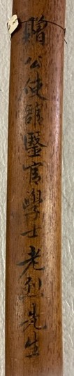

SCJapan Posted June 30 Report Posted June 30 Dear Lewis B, This is Setsuko Chano ( 茶野 節子) I found your post yesterday fortunately. Regardeing a photo of Saya ( 鞘〉I found Dr. Roretz Jananese name老烈先生. I think that it seems to be able to idntify Number 2472 (75) in the list, "Aoje Sujeh, Provinz Boshin 2? lang gekurzt. Scheide weiss. Geschenk des Hara Kikohiro". Would you agree with my thoughts on this ? As you are German, you could read a short explanation about Japanese swords written by Dr. v. Roretz in the list. Dr. Roretz collected most of swords in Nagoya in 1876-1880. He learnt the evaluation method from Ozaki Tadakage 尾崎忠景( belonged to Owari Clan ) accoding a book written by Prof. Shoji Katoh of Nagoya University. I contacted Professor Katoh to get the souce of Ozaki Tadakage as a sword sevaluator. Because Ozaki Tadakage's name is not found as Swords evaluators name lists at present. As a Owari Cran, I found some records on him in our history. I would be grateful if you would let me know contacts of the person in charge when you have visited to Styer MesserMuseum in 2024. I shall go to the museum this August together with my husband and descendants of Dr.von. Roretz. They know the direktor of the Museum. Looking forward to hearing from you soon. Kind regards, Setsuko Chano 1 1 1 Quote

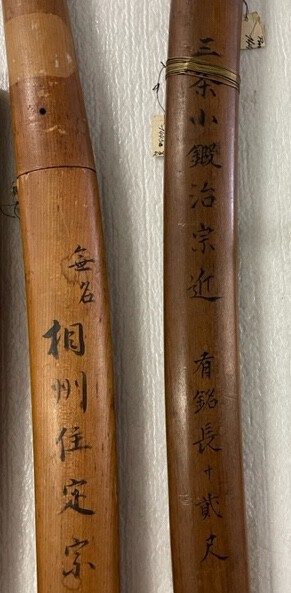

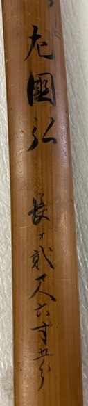

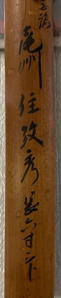

Jussi Ekholm Posted July 4 Report Posted July 4 I think these would be the sayagaki 相州住正宗 - Sōshū jū Masamune (for this I did not know the first kanji but it seems common way of writing 相 in sayagaki as I checked some reference sayagaki from various authors) 大和国貞行 - Yamato Kuni Sadayuki 和泉守兼定 - Izumi no Kami Kanesada X国弘 - X Kunihiro (I cannot read first letter with confidence but guess this could be Sa Kunihiro 左国弘) 濃州住兼X - Nōshū jū KaneX (I cannot read last one confidently) 尾州住政秀 - Bishū jū Masahide 備州長船兼光 - Bishū Osafune Kanemitsu 備州長船祐定 - Bishū Osafune Sukesada X兼安 - X Kaneyasu (I cannot read first one confidently) - This one is too artistic for me to read 越前国下坂貞治 - Echizen Kuni Shimosaka Sadaharu 無銘粟田口 - Mumei Awataguchi 相州住定宗 - Sōshū jū Sadamune (Not the Sadamune but a different one from c. Tenbun) 三条小鍛冶宗近 - Sanjō Kokaji Munechika Quote

SCJapan Posted July 27 Report Posted July 27 On 7/4/2025 at 12:05 PM, Jussi Ekholm said: I think these would be the sayagaki 相州住正宗 - Sōshū jū Masamune (for this I did not know the first kanji but it seems common way of writing 相 in sayagaki as I checked some reference sayagaki from various authors) 大和国貞行 - Yamato Kuni Sadayuki 和泉守兼定 - Izumi no Kami Kanesada X国弘 - X Kunihiro (I cannot read first letter with confidence but guess this could be Sa Kunihiro 左国弘) 濃州住兼X - Nōshū jū KaneX (I cannot read last one confidently) 尾州住政秀 - Bishū jū Masahide 備州長船兼光 - Bishū Osafune Kanemitsu 備州長船祐定 - Bishū Osafune Sukesada X兼安 - X Kaneyasu (I cannot read first one confidently) - This one is too artistic for me to read 越前国下坂貞治 - Echizen Kuni Shimosaka Sadaharu 無銘粟田口 - Mumei Awataguchi 相州住定宗 - Sōshū jū Sadamune (Not the Sadamune but a different one from c. Tenbun) 三条小鍛冶宗近 - Sanjō Kokaji Munechika 4 minutes ago, SCJapan said: I wrote my message in English, but my message was translated to Japanese automatically, mistakenly partly. I am afraid it causes some misundertanding. hi, 相についてお伝えします。 相州(そうしゅう)とは、相模国(さがみのくに)の略称です。現在の神奈川県の大部分を指します Quote
