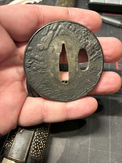

Dad passed last September and we found this sword while cleaning out parts of his closet. My mom knows he had it when they first met, mid-1970'd but no idea where he got it. I do not have the tsuka. Blade is magnetic and very sharp, with quite a few nicks in the blade. There are engravings on the tang, the small dagger and the kojiri. Someone on reddit says the tang inscription is from Etchu No Kami Kanekuni, but it looks much sloppier than other Kanekuni mei I have see online.
Wondering if someone here can let me know if this is worth seeking professional authentication or is this a gift shop trinket.

To me this looks like a genuine nihonto in genuine fittings. It also looks like under that surface rust you'd have a really nice hamon. Sadly I can't comment on the authenticity of the signature since I'm still learning about that side of things myself, but I can't see anything here that worries me about the age and manufacturing of the sword.
Of course better and more pictures are always welcome (such as what the blade looks like without its habaki, and at the very tip and very end), but if I saw this in an online auction with the current pictures, I'd definitely be bidding :)
Since this is your first post (welcome to the forum), I don't know how much you know about nihonto, but please don't try cleaning the rust off the blade yourself, and never clean the tang - you would destroy any value the sword has.

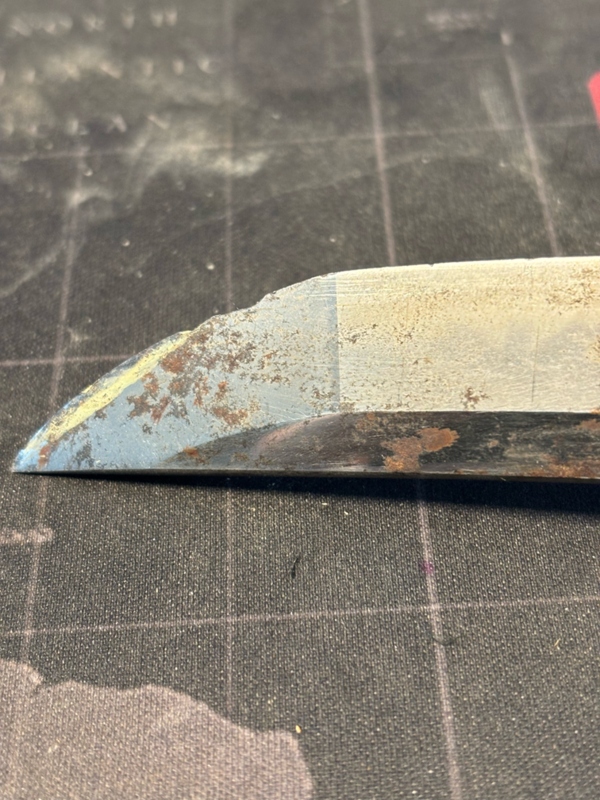

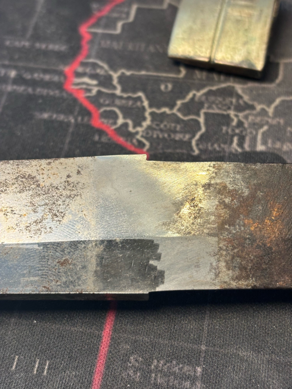

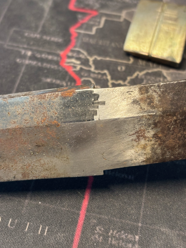

Here are some pictures of the tip and the blade under the habiki

Thanks for the extra pics! I'm even happier now that it is genuine - but someone has given this sword quite a beating.

110% - I've tried cleaning some things myself (never a sword though!) and paid the price for it later. With the chips and quantity of rust this would need to go to a professional that specializes in nihonto for a full polish. This is expensive, but may be worth it depending on the quality of the blade (others may be able to comment on this more than I can).
