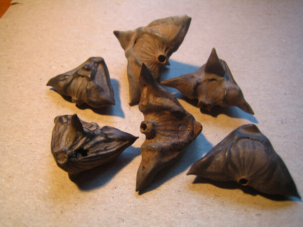

FlorianB Posted August 31, 2024 Report Posted August 31, 2024 There’s another explanation that the matsukawa-bishi is actually derived from the fruits of water-caltrop, called "hishi" 菱. BTW: The matsukawa-bishi pattern is a very old design and could be found on textiles in the Shoso-in already. Best, Florian 1 Quote
Bugyotsuji Posted August 31, 2024 Report Posted August 31, 2024 Yes, 菱 Hishi is water caltrops, also sometimes water chestnut, the origin of the word, the shape traditionally described as lozenge or diamond-shape. The matsukawabishi kamon shape of pine bark come from this word, i.e. matsukawa + hishi. I do agree that it seems to have melded or blended back towards incorporating elements of the original pointed/spiked caltrop shape. Quote
