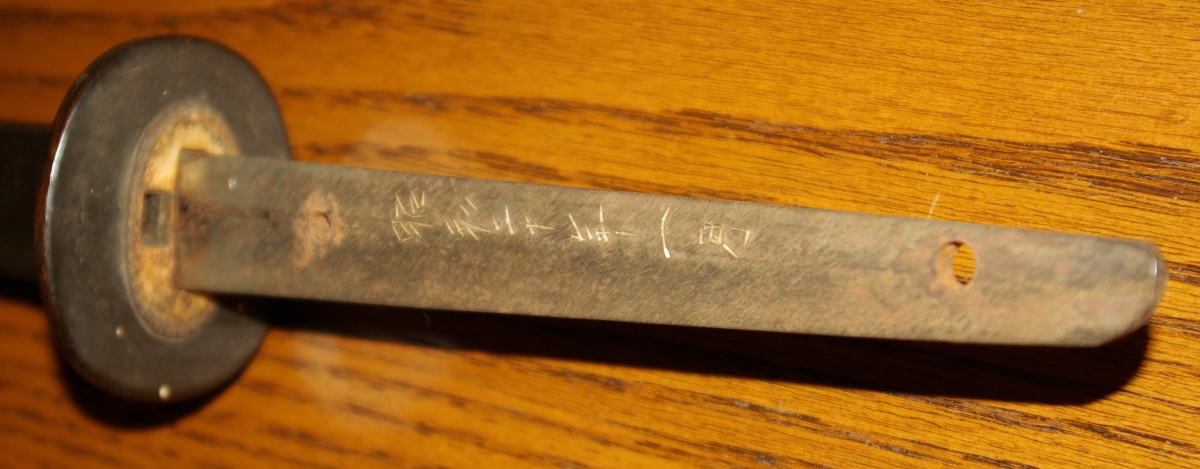

Roger Wildcat Posted December 26, 2009 Report Posted December 26, 2009 You want the picture of the tang? I didn't notice any stamp on mine. Quote
Bruno Posted December 26, 2009 Author Report Posted December 26, 2009 Thank you Roger! But, I beleive that yes,there is the small mark too on your tang. Or maybe I have a bad view. Quote
Roger Wildcat Posted December 26, 2009 Report Posted December 26, 2009 What general area will I need to look at for a stamp? Quote
Bruno Posted December 26, 2009 Author Report Posted December 26, 2009 I guess it is on the pic you just posted, it seems that a faint mark is close to the washer, neer the hole. It could be also a defect. Quote

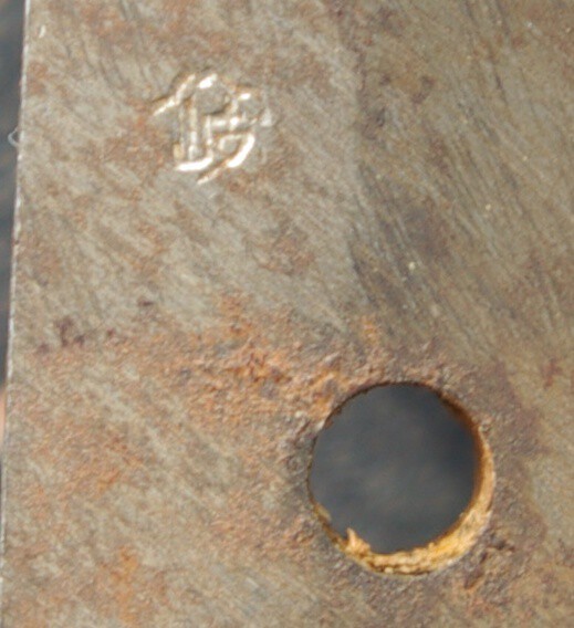

Roger Wildcat Posted December 26, 2009 Report Posted December 26, 2009 Well, I see a incredably small mark which I thought was a scratch. When I took it outside in broad daylight, it showed even more detail. Just took another picture, let me know what you see. Quote

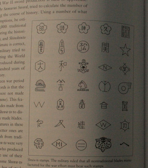

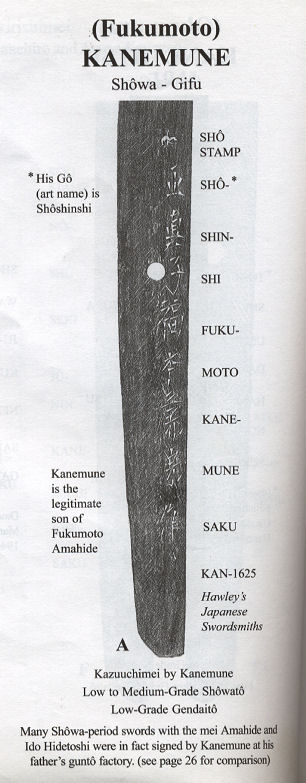

Stephen Posted December 26, 2009 Report Posted December 26, 2009 Roger looks to be showa stamp. page n Kanemune...here again. Bruno any thing like one of these? Quote
Bruno Posted December 26, 2009 Author Report Posted December 26, 2009 To Roger and Stephen, thanks to you guys! Well, my stamp is completly unreadable(to faint, not as well printed as Roger's one), that is why I asked if someone has a more or less same Kanemune sword with a better stamp that could be the same as mine. As mine like Roger's one is a Type 3 and forged only 2 months after Roger's sword, I beleive it is the same mark. Even with Roger's pic, I am not able to tell which stamp it is. Stephen, you vote for the Showa one?Right? Kind regards Quote

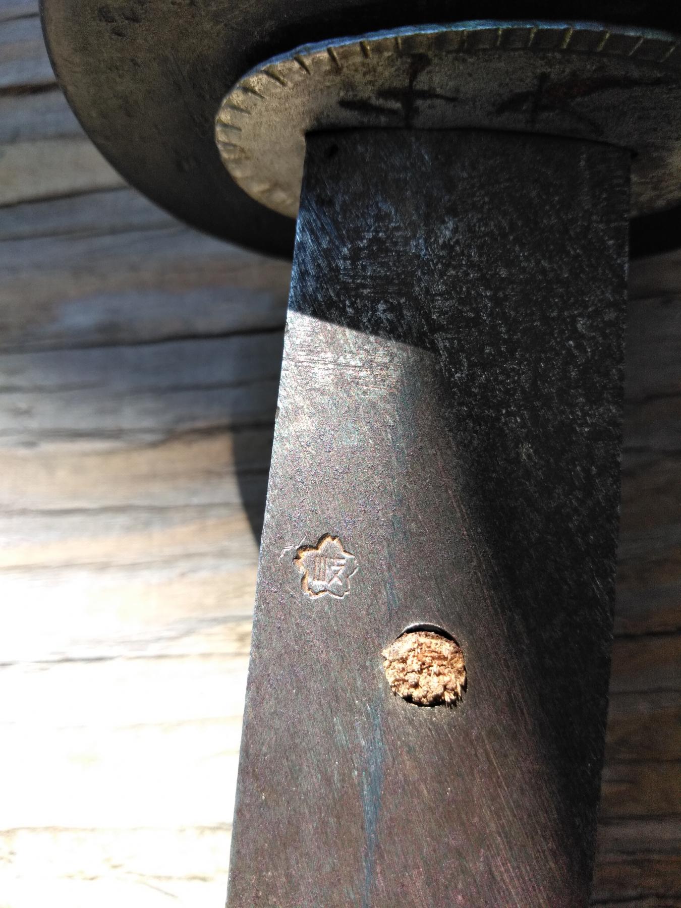

george trotter Posted December 27, 2009 Report Posted December 27, 2009 Hi, the stamp looks to my tired old eyes to be very similar to what Fuller and Gregory call "chimata" inside a sakura blossom (same as "sho" sakura blossom). it is shown also in Kapp &Yoshihara "Modern Japanese Swords and Swordsmoths" page 62. I have only ever seen this on Type 3 mounted swords, so must be a stamp that came out around 1943. Another stamp I have seen only on Type 3 is "matsu" in a circle, but obviously different to this one. Hope this helps. George. Quote
John A Stuart Posted December 27, 2009 Report Posted December 27, 2009 George, I have been talking with Bruno about this mark and had written it off as not a standard mark. However looking at magnification can see how it could be a mis-struck chimata stamp, which is the same as the Gifu stamp except within the sakura lozenge. I do see how this can be the case. 岐 It must be. John Quote
Bruno Posted December 27, 2009 Author Report Posted December 27, 2009 Thank you Steve, George, John and others, This is true, Chimata and Gifu marks are almost the same. The Gifu one seems to have 2 strokes/lines(in the first kanji) shorter than the Chimata.And it appears to me that it is this one(Gifu)we can see on the Roger's picture. However, the mark on the nakago is inside a sakura blossom and as I never seen any Gifu mark before, I do not know if it can be found inside a sakura blossom too. If yes, I think the stamp on the Type 3 nakago is a Gifu stamp. If not, 33%Gifu 33%Chimata 33% unidentified one!!! :D (I still wonder why two different words like Gifu and Chimata are written with so similar kanji, and what does Chimata mean.) Once again thanks everyone for your precious help, I really appreciate it. Regards Quote

Roger Wildcat Posted December 28, 2009 Report Posted December 28, 2009 I found a picture of a tang with a better stamp on ebay, just type Kanemune and his sword shows up. Quote
Bruno Posted December 28, 2009 Author Report Posted December 28, 2009 I think this one is the Showa stamp different from the one on ours Kanemune. Yes it is better printed. Quote

Roger Wildcat Posted December 29, 2009 Report Posted December 29, 2009 From the page that Stephan presented to us, the stamp looks like the 2nd on the top row. Quote
Bruno Posted December 29, 2009 Author Report Posted December 29, 2009 From the page that Stephan presented to us, the stamp looks like the 2nd on the top row. Yes, Chimata stamp obviously. Gifu stamp is very similar:岐 Quote

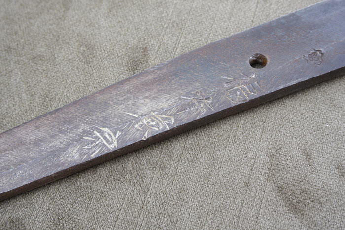

ww2colorado Posted June 16, 2019 Report Posted June 16, 2019 Guys i have one i will add photos shortly Quote
Bruce Pennington Posted June 16, 2019 Report Posted June 16, 2019 I found a picture of a tang with a better stamp on ebay, just type Kanemune and his sword shows up.This one is clearly a Showa stamp, placed sideways. Your original is something else, like discussed above. I've love to see it with those small rust pieces removed from the stamp. It looks more like a Gifu than chimata, but without removing the rust pieces it's hard to say. Quote
