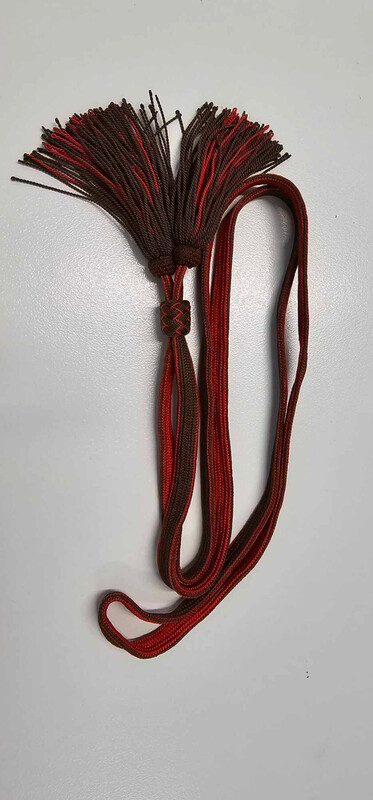

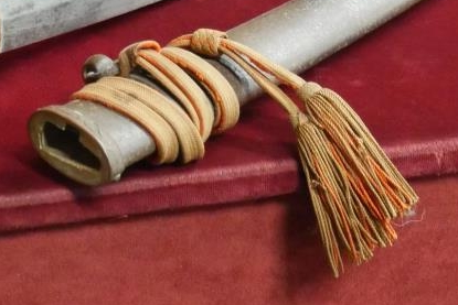

RussellM Posted August 22, 2024 Report Posted August 22, 2024 Hi everyone, can you please take a look at this tassel and let me know if it is a reproduction or genuine? The tassel isn't mine but it is for sale at US$520. Any help greatly appreciated! Cheers Russ Quote

PNSSHOGUN Posted August 23, 2024 Report Posted August 23, 2024 Low quality Chinese junk, nasty example made from rayon. 6 Quote
moriarty Posted August 23, 2024 Report Posted August 23, 2024 250 for that? The depths of depravity.. 1 Quote
RussellM Posted August 23, 2024 Author Report Posted August 23, 2024 Thank you very much gents for your assessment, you have saved me from making a rather large mistake! They don't want $250, they want $520! Cheers from NZ Russ 1 Quote
PNSSHOGUN Posted August 23, 2024 Report Posted August 23, 2024 No worries Russ, originals won't have a shine to them even when they are old new stock. The crowns above the tassels should be tightly knit as well. 4 Quote

Kiipu Posted August 23, 2024 Report Posted August 23, 2024 Not to be overlooked is a rather obscure comment made by Akira Komiya. 額縁 Gakubuchi Sword tassel - genuine or reproduction? 2 Quote

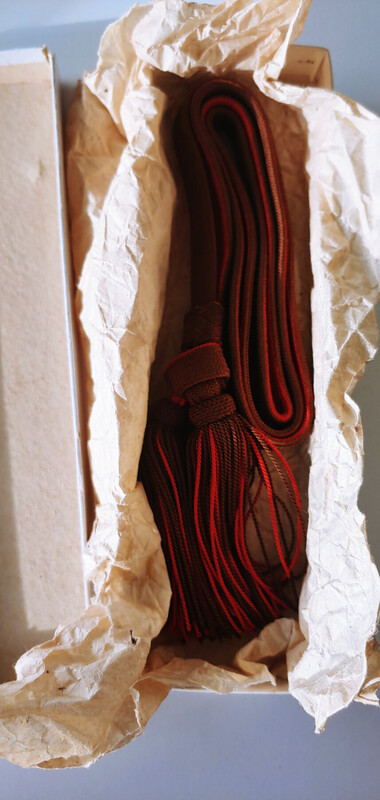

PNSSHOGUN Posted August 24, 2024 Report Posted August 24, 2024 Early thin field grade tassel with the above mentioned bordered edges, really hard to find! 3 Quote

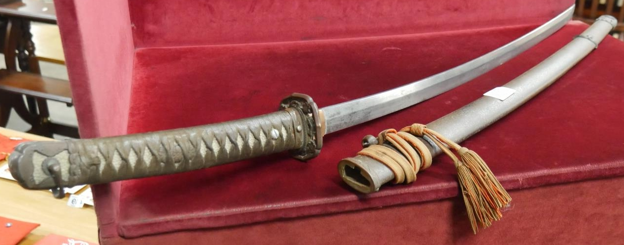

George KN Posted November 16, 2024 Report Posted November 16, 2024 I didn't want to open a new thread since this one was fairly recent, but I've come across a similar-ish tassel myself in the wild, and just wanted a second opinion from people. (Apologies for the terrible picture, I'm trying to get another) Does this look genuine at first glance? It's certainly rough around the edges, but it doesn't seem as shiny as the repro one discussed earlier in this thread... And do people think it looks more like a field or general grade tassel? I don't know much about them and information seems to be fairly sparse. Thanks! Quote
PNSSHOGUN Posted November 16, 2024 Report Posted November 16, 2024 Looks to be an early style field grade tassel, is the rest of the sword nice? 1 2 Quote

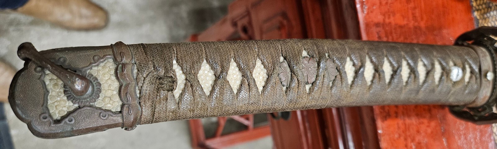

George KN Posted November 17, 2024 Report Posted November 17, 2024 Thanks @PNSSHOGUN! To be honest, I don't know if the sword is good, bad, or a complete fake, since I only have one picture whilst I wait for more: Apart from not knowing whether the blade is damaged, fake, showato, etc - the tassel, screw mekugi, and unusually plain chuso button (is it a replacement?) is giving me pause for thought about whether it is a genuine wartime sword. I also don't think I've seen such a generally brown and boring tsuka before... Does it seem in-keeping for an early gunto? I'm normally used to seeing a bit more gold or red, and a bit more of a hamon I was somewhat hoping you'd tell me the tassel was fake so I could rule out the rest as a put together package, but if it's not, I might have to reconsider... Quote
Bruce Pennington Posted November 17, 2024 Report Posted November 17, 2024 I have seen a small number of officer gunto with a screw/bolt. Seems like it would be a post-war addition to a sword missing the mekugi. But no way to know. 1 Quote
robinalexander Posted November 17, 2024 Report Posted November 17, 2024 On 11/17/2024 at 1:03 AM, George KN said: giving me pause for thought about whether it is a genuine wartime sword Expand George everything I can see in the bad pics suggests it is WW2 sword. The tassel does look original and well used as does the Ito. The chuso buttons are often replaced as they are easily broken by the uninitiated. That replacement could be wartime or post. Pierced tsuba and central chuso hole on fuchi are typical signs of Type 94 but Kabuto-gane maybe not...but that's nothing. As for the blade ? .... need better pics, particularly of nakago and kissaki. 2 Quote
dwmc Posted November 17, 2024 Report Posted November 17, 2024 Left handed gunto??? Chuso on opposite side? Am I seeing this correctly? Dave M. Quote
George KN Posted November 17, 2024 Report Posted November 17, 2024 @dwmc great spot! But that one's on me, I actually mirrored the image to help me notice anything odd. Thanks for all the thoughts everyone, much appreciated! I'm hoping I can buy this one 🤞 1 1 Quote

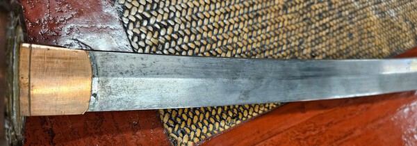

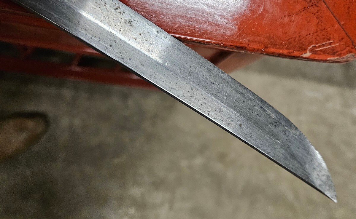

George KN Posted November 18, 2024 Report Posted November 18, 2024 Looks like someone else ended up with this one! I'm trying *really* hard not to pick up more project blades, and it went for just a little too much for me. These were the extra pictures from the auctioneer: Koshirae definitely looks decent, but the blade has had a rough time. Dodged a bullet? Missed a gem? I'm not sure either way, but definitely hard to walk away. I hope it finds its way onto this forum so I can find out what's on the nakago 1 Quote
