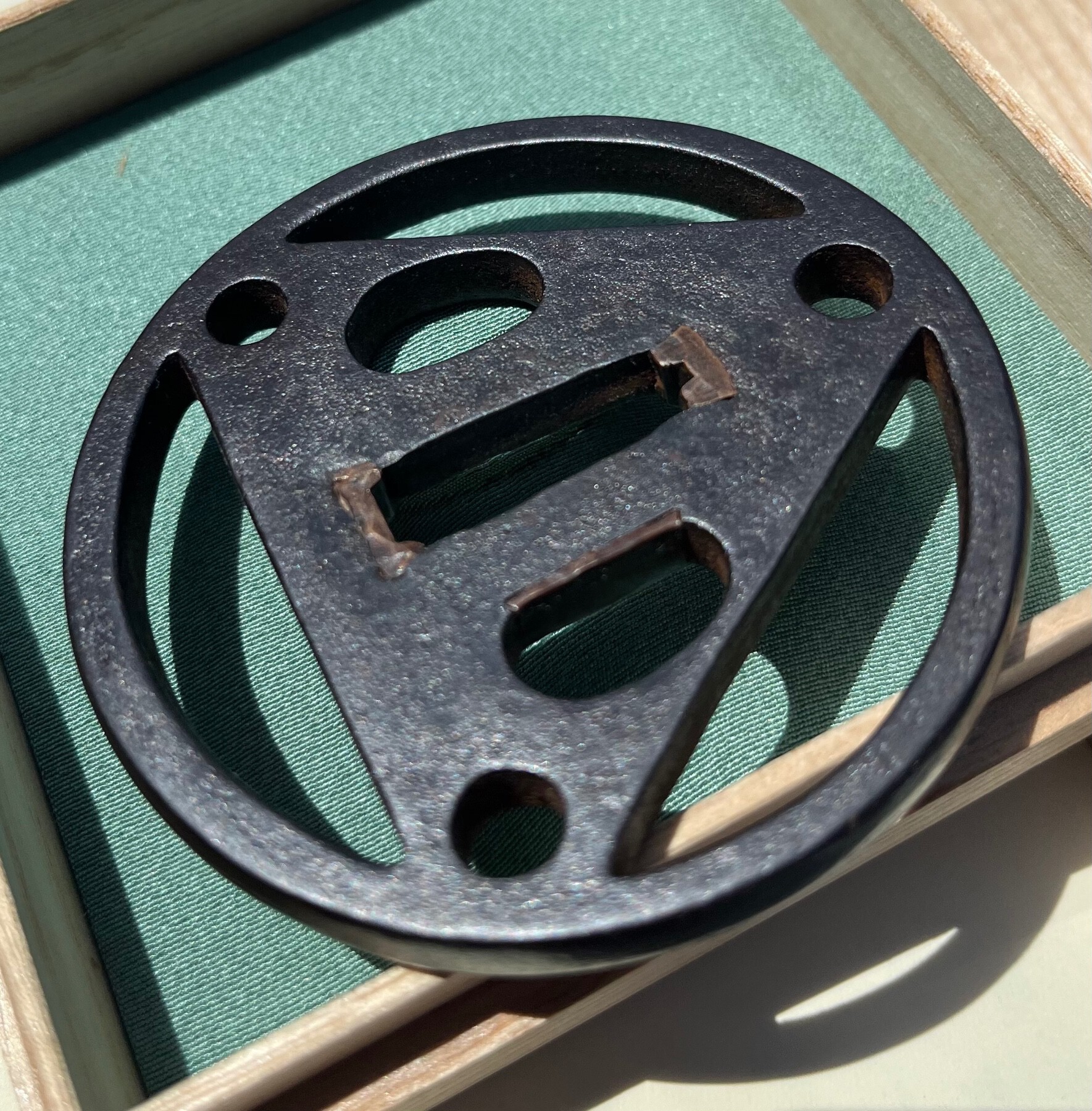

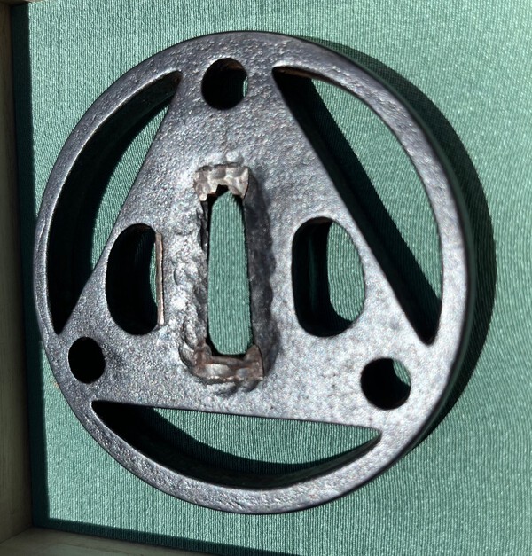

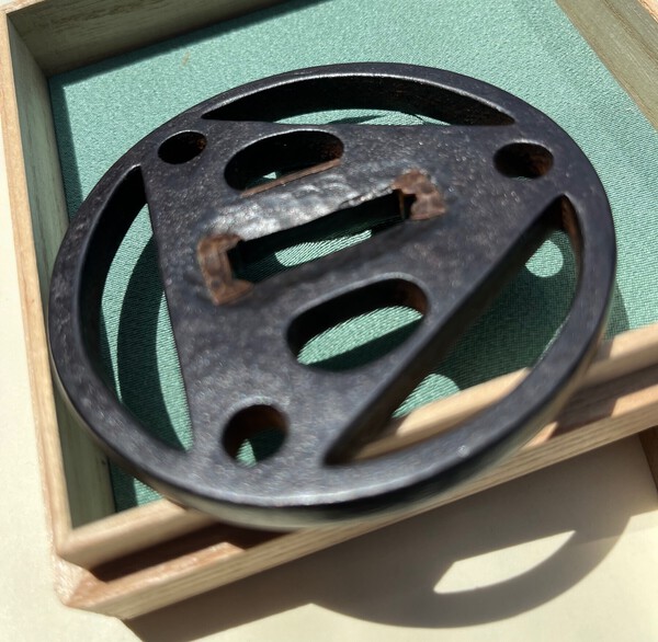

Steve and I have been looking at this big "Kanayama," but is more likely Ohno. I think it has a strong design, but the condition is a bit questionable. Apparently, this seller is not reliable. What a shame, as this may be something that Curran has been waiting for...
I bought a better example of this design, though it would be nicer if I had just bought Jim Gilbert's back in the day. Mine has NBTHK papers to Ono, which was nice- but I would have bought it papered or unpapered.
  The one that is currently up is with SWLibro seller?  Some minor things about the patina and the seppa dai give me pause. If the seller is whom I think, yes I too would be cautious.

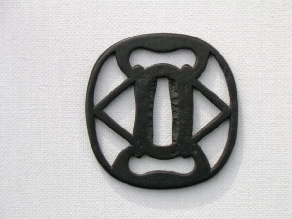

Here is one similar to #123 in the Yagyu inventory. Dr. Torigoye notes three production periods of Yagyu type tsuba, so this is a later Akasaka copy of the style by Tadatoki.  Also another, #94 in the inventory signed Yamakichibei

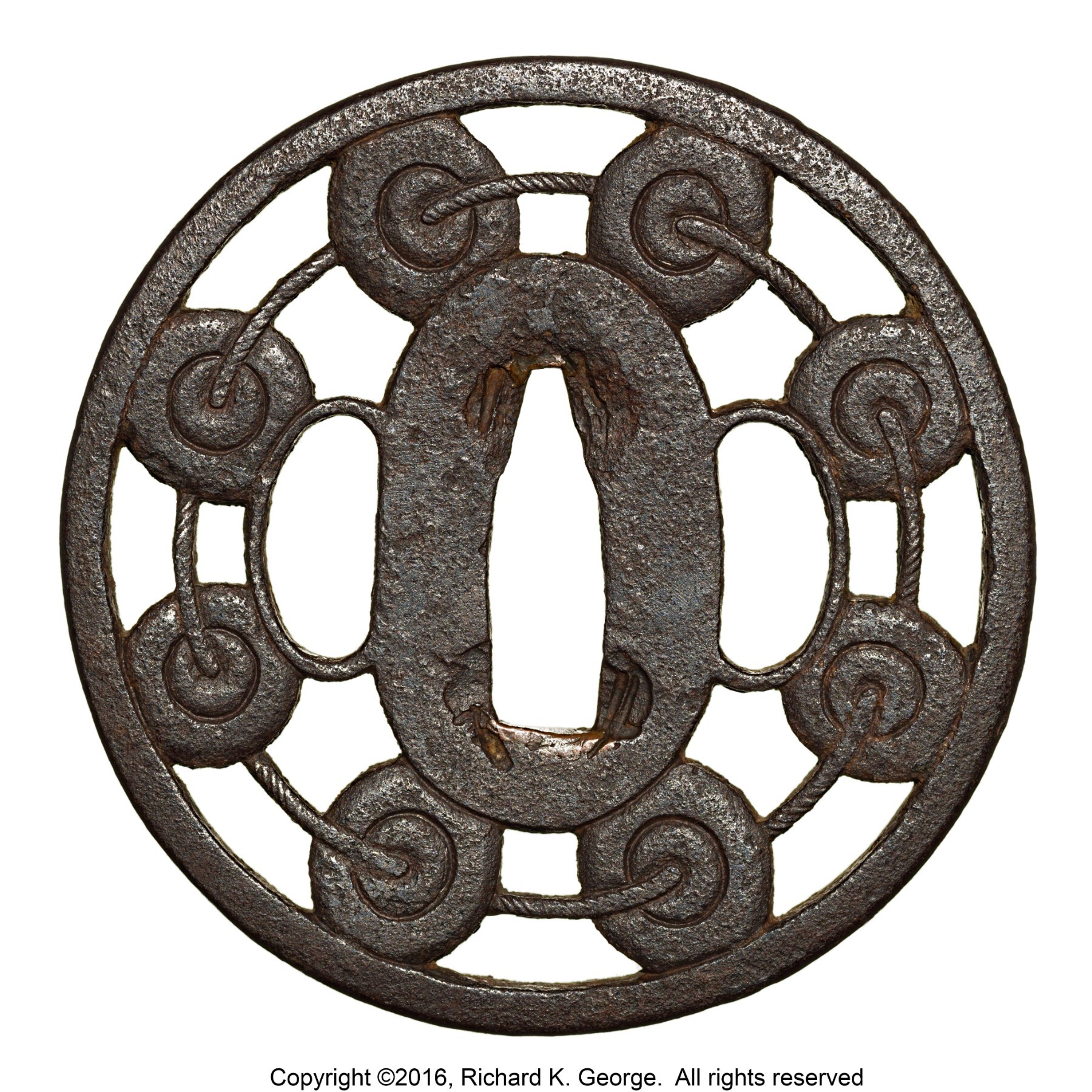

We have on this post a number of solid candidates for a learning set.
SteveH: Kuruma (1)
SteveW: double tomoe previously sold on NMB (1)
Andrew Quirt (nihonto.us): he has a triple aoi for sale on his site (1)
Didier: Kuruma (2)
Thomas: Yagyu deslgn, need to confirm dimensions (1)
Curran: probably has at least (2-3)
Sasano: although we cannot see in hand, he had an amazing eye. at least some of his tsuba can also be used as Ohno examples

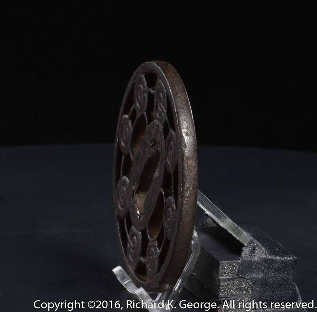

First some numbers. I measured a typical Kanayama tsuba and a massive Ohno that I have. I consider these to be for shorter swords based on the seppa-dai length.
Kanayama - 65.5 X 6mm. Weight = 67 grams
Ohno - 69 x 7mm. Weight = 128 grams
The Ohno weighs significantly more even though it is not that much bigger. So why is that?
  • I am not sure Sasano's opinion applies in this case because of the large weight difference. I would not think the weight would need to be increased that much.
  • It could be that a martial ryu commissioned heavy tsuba to complement specific sword techniques. This consideration still exists for koryu bokuto, where some bokuto are made light and others are made heavy depending on the training application.
  • Or, maybe it is just about achieving a desired visual or psychological effect with the massive, broad rim, weight not being a consideration?  Sort of like a style or culture statement, a teabowl on a stick?
@Tim Evans Thank you for posting this example. It is helpful to see and study such an example of a late Yagyu style tsuba being made by the Akasaka School.

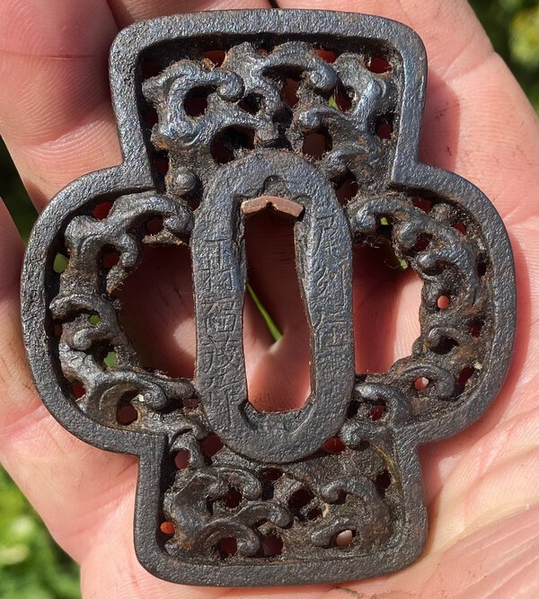

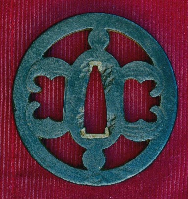

More research marital for Steve @Iaido dude. I papered this tsuba to Onō by the NBTHK when it was in my collection. I purchased it from @rkg. It had many wonderful iron bones along the rim. I really miss this tsuba.
_DSC5720_crop_Low_Res.thumb.jpg.da6bf0060d878e4c20a425c20c34e388.jpgOhoIronBonesExample.thumb.jpg.17bdc20eddae7a016a3af6101d7c8db7.jpg
What is thickness and weight of this tsuba?

I especially like the first two. Do you recall the reasons you considered them to be Ohno?
# 1, 2,and 4 have the distinctive tekkotsu and coarse jigane. This needs to be seen in-hand, not something that can be accurately depicted with an image. #3 is more of a guess based on the design elements. Okamoto, Sasano and Kremers allow for finer grained, no tekkotsu, maru mimi tsuba with the right "look" as late Ohno.

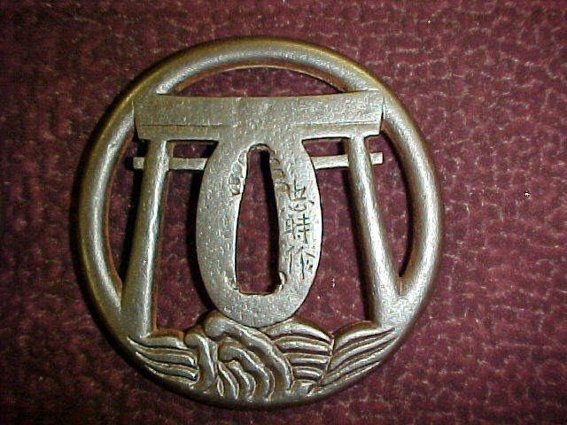

Here is an example of an Ono tsuba I bought from a board member signed Shimomura Fukushige I was wondering if it’s made in the style of  Yagyu  with the wave theme, it’s pretty heavy for its size it is 8mm thick at the rim and measures 75mm x 65mm the iron seems to have a sandy texture looking forwards to hearing you thoughts.
Chris H
If you send it in to an NBTHK Shnisa, it would likely be papered to Shimomura Yoshishige (AKA Fukumo), a known Ohno smith, rather than Yagyu. It does have some Yagyu-ish characteristics. This is an important reference piece because it is fully signed.

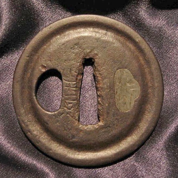

Just for comparison: A rather graceful looking TSUBA papered to KANAYAMA DEN. 74,7 mm round, thickness 5,9 mm. A few linear TEKKOTSU in the MIMI.
