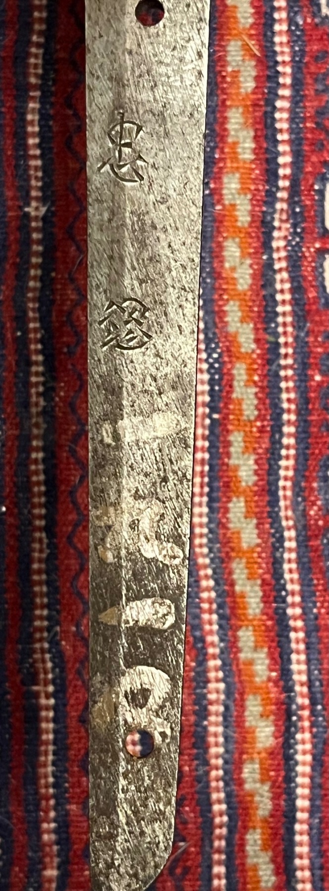

GetFuzzy2 Posted August 13, 2024 Report Posted August 13, 2024 Greetings, I picked up this type 44 about 10 years ago and will post more pictures but I’m really itching to know the date and smith of this blade. Thanks for everything and I’ll post more photos shortly. God Bless Quote
Xander Chia Posted August 13, 2024 Report Posted August 13, 2024 Can’t tell what the second character is but the first one is definitely 忠. As for the date it says, 昭和十九年三月, Showa era 19th year 3rd month. 1 Quote
David Flynn Posted August 13, 2024 Report Posted August 13, 2024 The first character, is definitely Tada. The second character could be Tsuna? Quote
Xander Chia Posted August 13, 2024 Report Posted August 13, 2024 On 8/13/2024 at 5:41 AM, David Flynn said: The first character, is definitely Tada. The second character could be Tsuna? Expand Looks like it… The character looks similar to the 綱 found here: https://www.reddit.c...terday_a_shin_gunto/ Don’t think the maker is the same though. The “handwriting” looks different. Quote
Bruce Pennington Posted August 13, 2024 Report Posted August 13, 2024 Followed several links, and K.Morita translated it on a kaigunto as Tadatsuna here: 1 1 Quote
moriarty Posted August 13, 2024 Report Posted August 13, 2024 Seems that 河村忠綱 (Kawamura Tadatsuna) is quite undocumented. Other than being a Seki smith (perhaps a lower grade?) I can't find much. Quote

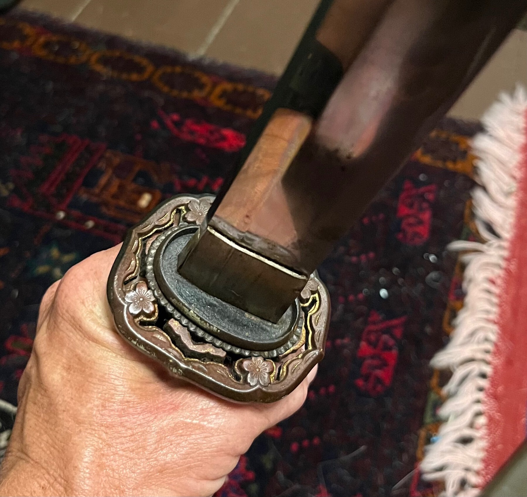

GetFuzzy2 Posted August 14, 2024 Author Report Posted August 14, 2024 Thanks for all the input Guys and the help, here are some more pictures sorry about the poor detail and the mess. Any other insight would be very helpful and appreciated. PS I enjoy the punched out Tusba that has been subdued with paint. God Bless Quote
GetFuzzy2 Posted August 14, 2024 Author Report Posted August 14, 2024 Chia that is so interesting, the 19th year of Showa is 1945, that is amazing to have such a late war sword. Thanks for the translation. God Bless 1 Quote
Bruce Pennington Posted August 14, 2024 Report Posted August 14, 2024 On 8/14/2024 at 2:05 AM, GetFuzzy2 said: 19th year of Showa is 1945, Expand With Japanese sword dates, you always have to subtract 1 Showa 1926 + 19 (-1, so 18) = 1944 March 1944. Quite a unique gunto, Vern. The tsuba isn't normal for a Contingency model, yet it looks like it was made this way, so a personal upgrade or modification by the owner? Also, any stamps near the top or on the back edge of the nakago? 1 Quote
GetFuzzy2 Posted August 14, 2024 Author Report Posted August 14, 2024 Bruce I’ll look later today. Thanks for the intel on how to do Showa math. God Bless 1 Quote
