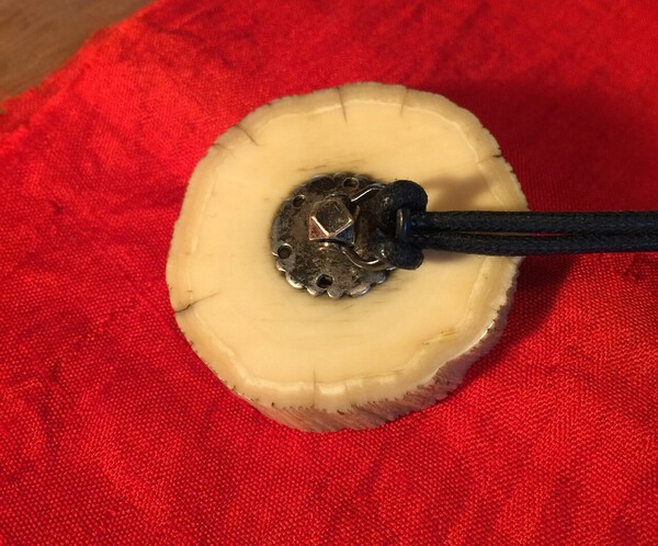

i-img590x786-17233926045883y1nmmp90114.jpg    I have seen antler, bone, horn and ivory tsuba but this is the first Narwhal tusk tsuba I have ever seen.
Narwhals: the Mysterious Whales and Their 10-Foot Tusks - Business Insider  64 mm x 40 mm x 6.3 mm  it isn't a very large guard taken as a cross section. All Narwal tusks are rather slim.
https://www.jauce.com/auction/n1148353109   I suppose you could get a lot cut from the one tusk but where will you ever see one again? Has anyone ever seen another?

does not look like Japanese workmanship to me. Nakago ana.???

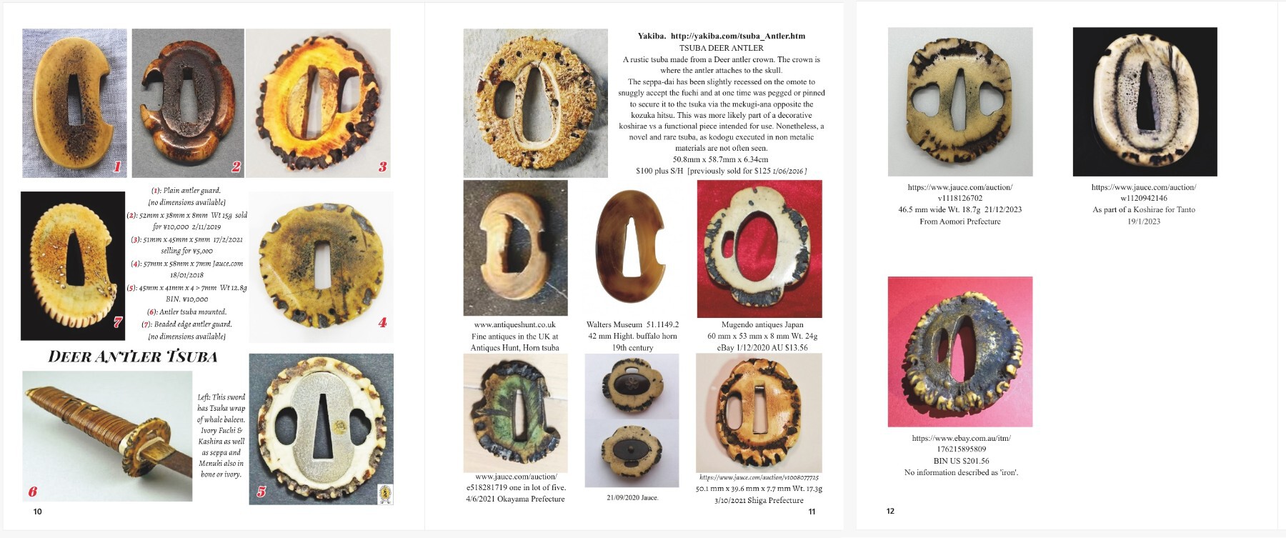

 Yes pretty rough work, I see similar on some deer antler ones as the core is often very spongy and I presume soft [shouldn't that make it easier to cut straight?] You might notice my 'avatar' is a reinforced antler guard - what is under the silver plate I don't know. I will add this new find to the ones I already have - an odd bunch, I think they are more likely found on country folk weapons or for village elder's rather than samurai? :dunno:

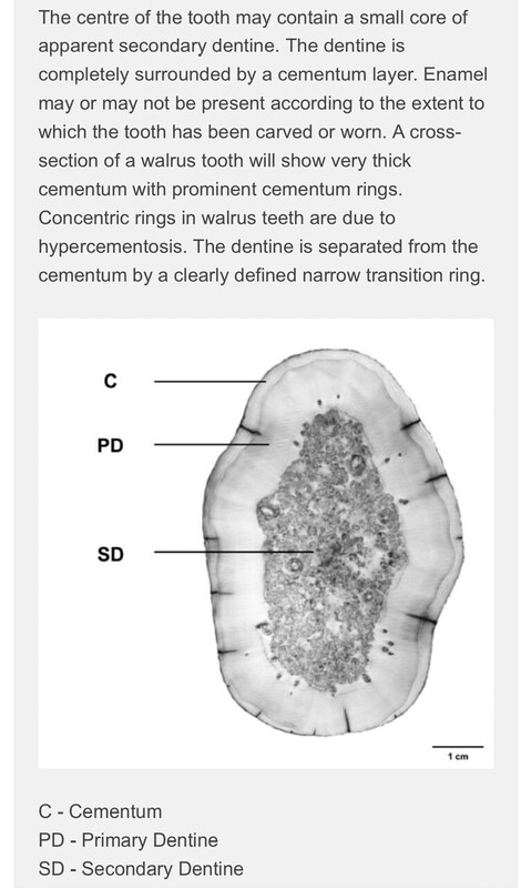

It’s walrus ivory btw.
From the International Netsuké Society site

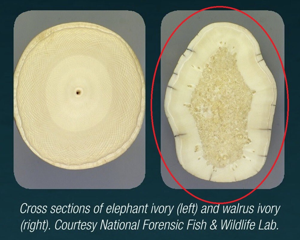

Looking further into it the anatomy of the two appears to be similar but the thickness of the inner dentine layer and general shape does some to indicate Walrus tusk.
Would this presumably mean that we could expect the tsuba to come from Hokkaido or Sakhalin, based on the natural habitats of these animals?
Something we have often discussed in the Netsuke world. The large central secondary dentine section of walrus has this 'crushed ice' look, often recognizable, but disguised in some way by artisans working with walrus Netsuke.

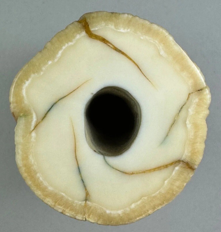

Of course other marine ivories were often carved to look like narwhal as it was considered a valuable material.
