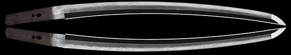

Alex A Posted August 10, 2024 Report Posted August 10, 2024 Kind of agree with Colin, slightly shortened then ok. Quickly looked through sales pages and randomly pulled a wak with the shape that appeals to me. Obviously on later Edo blades there would be more to the blade but it gives an idea. 1 Quote
Lewis B Posted August 10, 2024 Report Posted August 10, 2024 On 8/10/2024 at 8:13 AM, Alex A said: Kind of agree with Colin, slightly shortened then ok. Quickly looked through sales pages and randomly pulled a wak with the shape that appeals to me. Obviously on later Edo blades there would be more to the blade but it gives an idea. Expand How would this be rated? Late Kamakura and Juyo, attributed to Norishige. The nagasa is only 41cm so we can only wonder at how amazing this blade would have been originally. In my eye even if o-suriage there is an appeal to the sugata. 2 Quote
Alex A Posted August 10, 2024 Report Posted August 10, 2024 Its difficult judging a swords real shape from images, that must be said. Often swords look overly curved in images, i guess for folks that shop online, got to take real note when it comes to checking out the dimensions. The Kamakura sword above does not seem to have a great deal of sori, would be interesting to know what that measurement is. I prefer elegance over robustness with waks. Quote
paulb Posted August 10, 2024 Author Report Posted August 10, 2024 Well Lewis it is a very big name. I think the shape is ok the proportion good and nothing offends. Like you I would have loved to see this when ubu. Quote
Lewis B Posted August 10, 2024 Report Posted August 10, 2024 On 8/10/2024 at 8:43 AM, Alex A said: Its difficult judging a swords real shape from images, that must be said. Often swords look overly curved in images, i guess for folks that shop online, got to take real note when it comes to checking out the dimensions. The Kamakura sword above does not seem to have a great deal of sori, would be interesting to know what that measurement is. I prefer elegance over robustness with waks. Expand Sori is 0.7cm. Very small as it's massively shortened. Possibly half its original length. 1 Quote
Alex A Posted August 10, 2024 Report Posted August 10, 2024 Thanks Lewis, i kind of suspected small sori. Quote

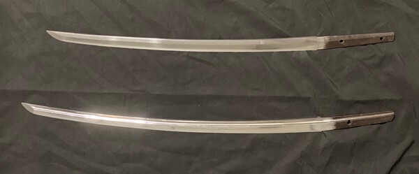

Scogg Posted August 12, 2024 Report Posted August 12, 2024 Doing some sorting today and oiling. Decided to compare two of my wakizashi side by side. One is unpapered suriage, the other is ubu and papered. Both mumei. Very different form. Just thought I’d share to a thread I enjoyed! 5 Quote
