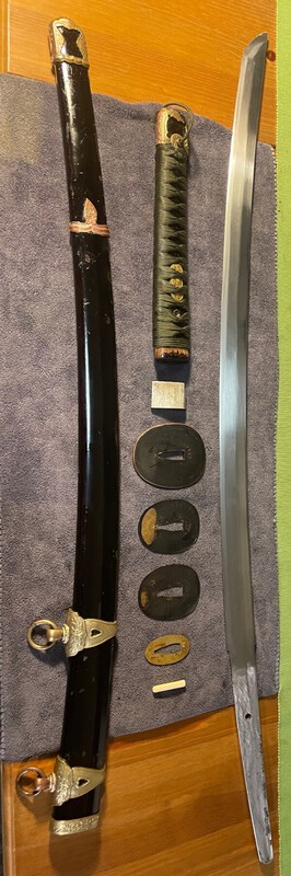

raaay Posted August 9 Report Posted August 9 i might be wrong but this looks like another copy of a Japanese blade , the Ha-machi and Mune-machi out of line which normally indicates a Chinese made blade ? 1 Quote

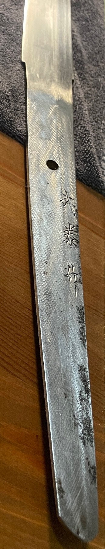

ROKUJURO Posted August 9 Report Posted August 9 Not Japanese in my opinion, whatever the signature. (MU/BU YASU?) Quote

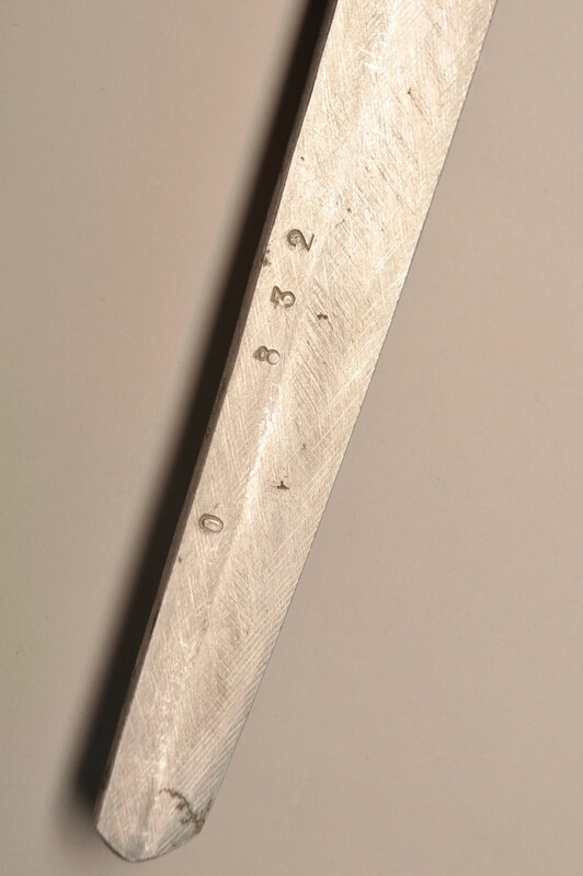

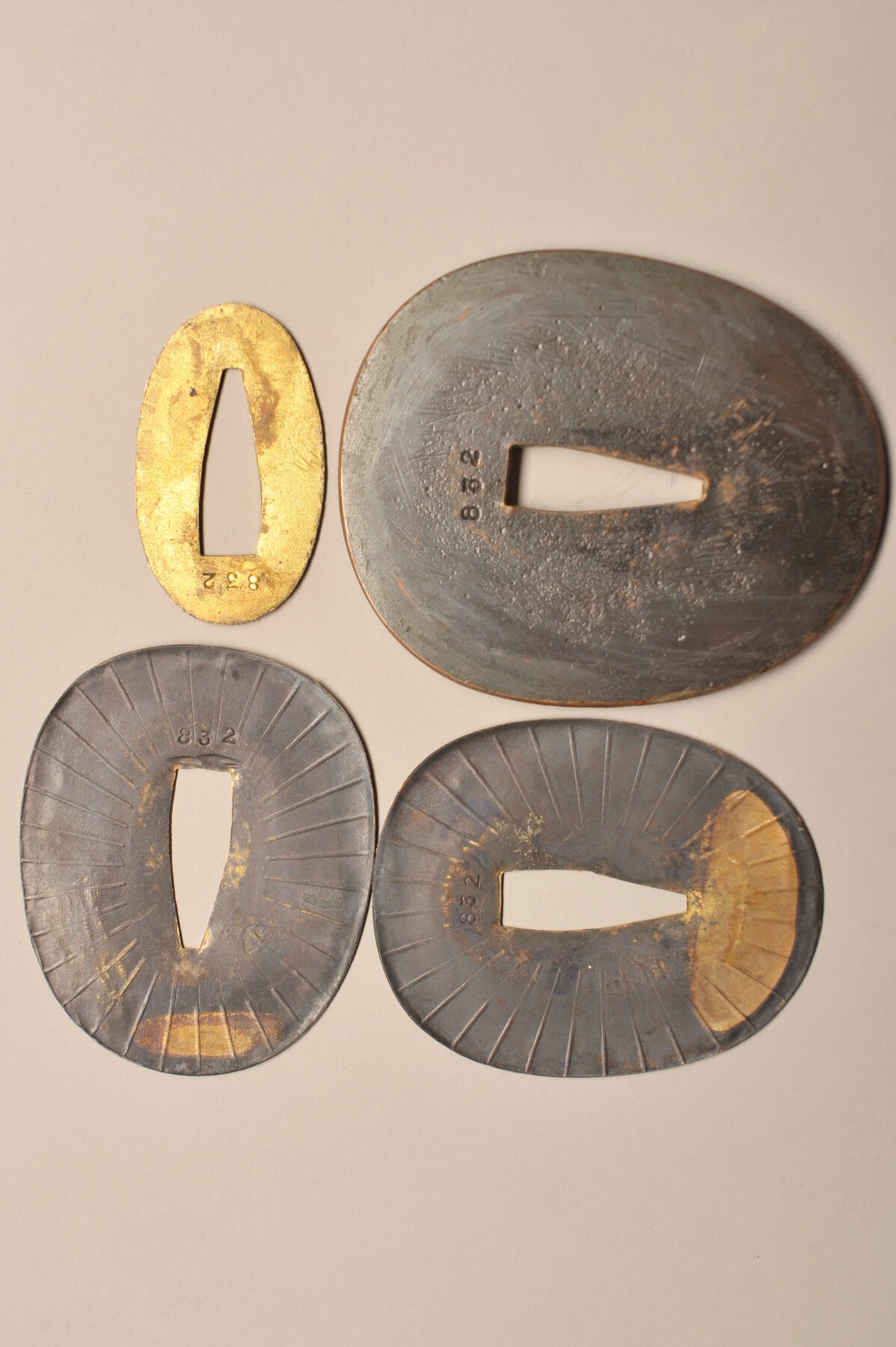

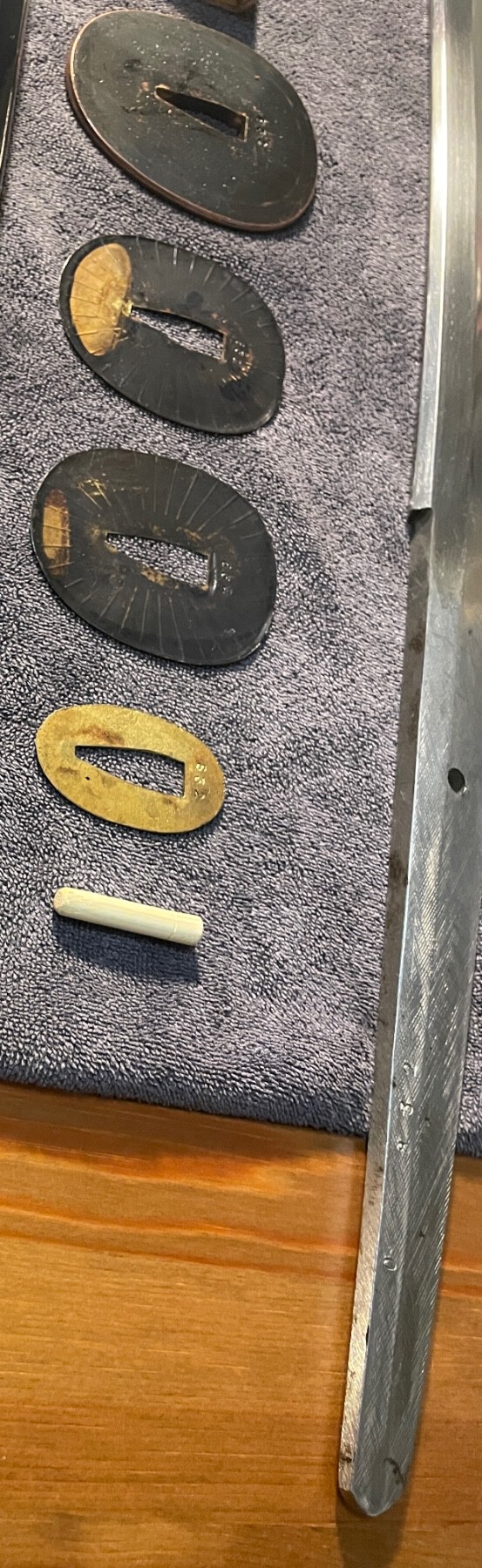

Conway S Posted August 9 Report Posted August 9 Tony, You have the characters correct. The smith is Takeyasu. I take it no translation is needed for 作. The blade is made from anti-rust steel which accounts for the bright appearance of the nakago. It is in late-war kai gunto fittings. It is 100% genuine. You may have noticed the numbers on the nakago match the numbers on the tsuba, seppa and probably the fuchi and tsuka as well. Conway 3 3 Quote
Bruce Pennington Posted August 9 Report Posted August 9 Good post, Conway! This is a late-war kaigunto, note the lacquered leather/fabric instead of rayskin. We have seen Takeyasu blades in late war kai as well as in post-war souvenirs. So, he was working in the last year of the war, probably. He has been of interest to @Jcstroud in the souvenir sword discussion - Who Was Toyosuke? 1 Quote

Bruno Posted August 14 Report Posted August 14 Can't find any Showa era TAKEYASU smith in SESKO book. A meikanmore smith? Quote
BANGBANGSAN Posted August 15 Report Posted August 15 @Tonyatm During World War II, many swordsmiths work for the Toyokawa Naval Arsenal 豐川海軍工廠 were not documented. It is estimated that these were either substitute names for known swordsmiths or their apprentices. In addition to Takeyasu武泰, there were also Toyosuke豐佐, Toyomich豐道, Kiyomich清道, Heishun平俊, and others. 5 Quote

Jcstroud Posted November 8 Report Posted November 8 Takeyasu and Toyosuke had many things in common small 4mm stamps green paint ,black paint, cut tangs at 9 in. Length+/-, crosshatched filemarks all seem to indicate Takeyama forge origin in my opinion. Currently looking for more verification. Quote
Jcstroud Posted November 8 Report Posted November 8 I would like to know the length of the Nakago as it appears long like those made in Takayama also kisaki is in the form of Takeyama blade. IMO Quote
