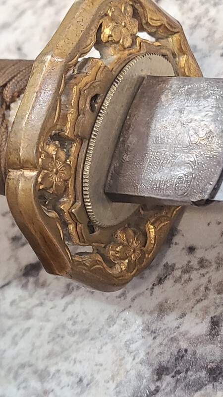

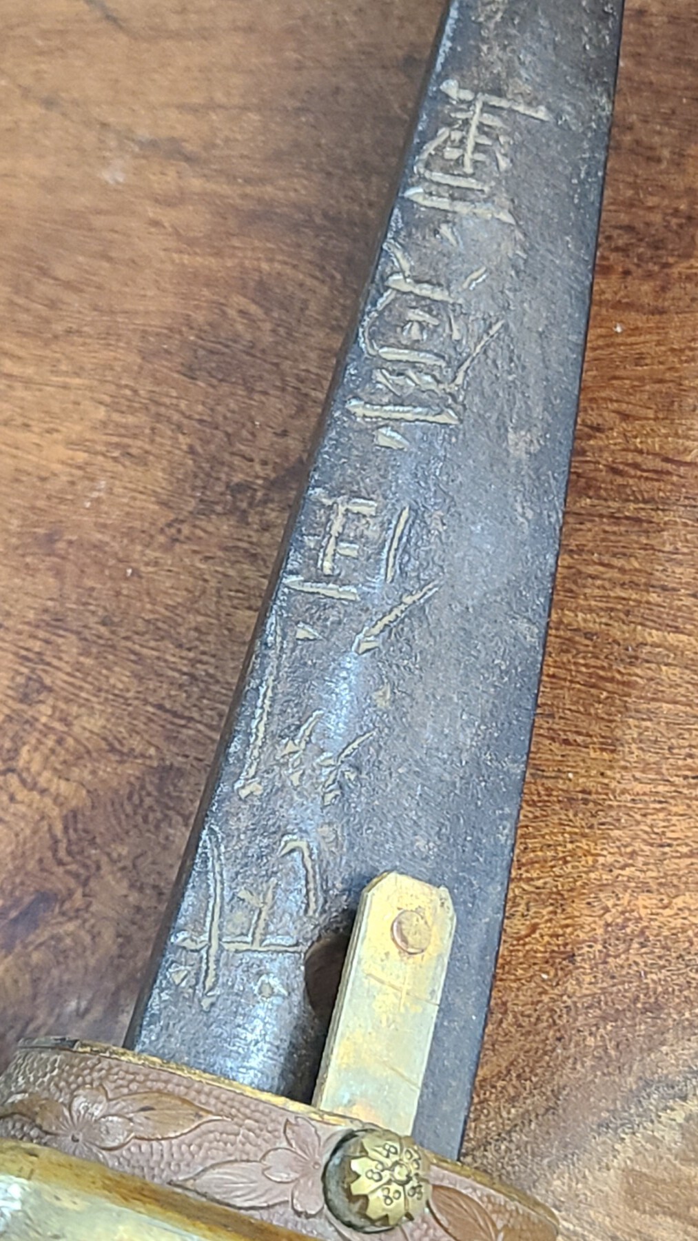

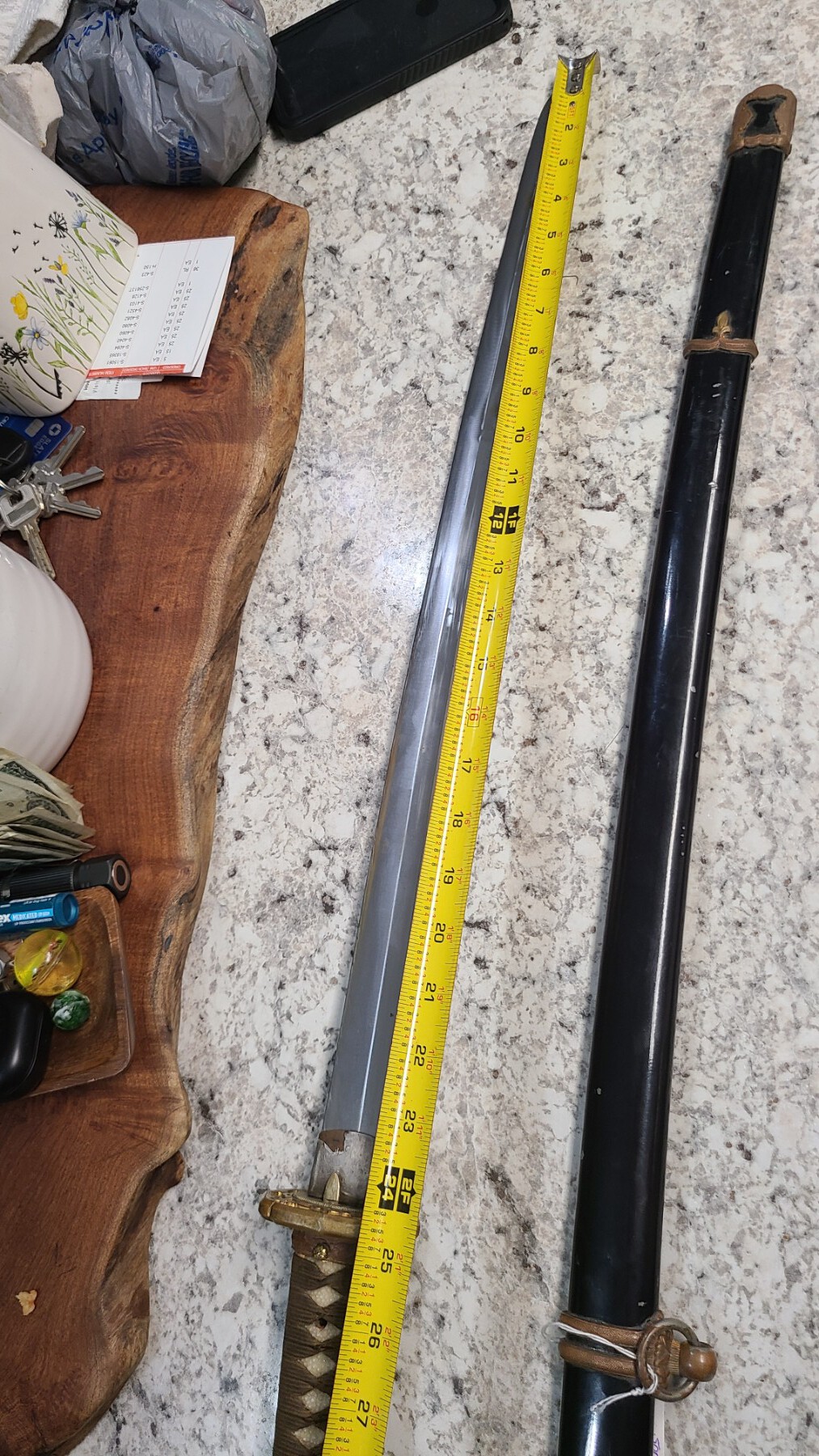

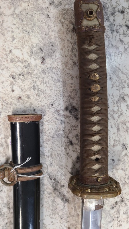

Hello, I just acquired this sword from an estate and know nothing about it. I would like as much information about this sword as possible. Here are some photos.

Looks like a good blade. Unfortunately Gimei for me.

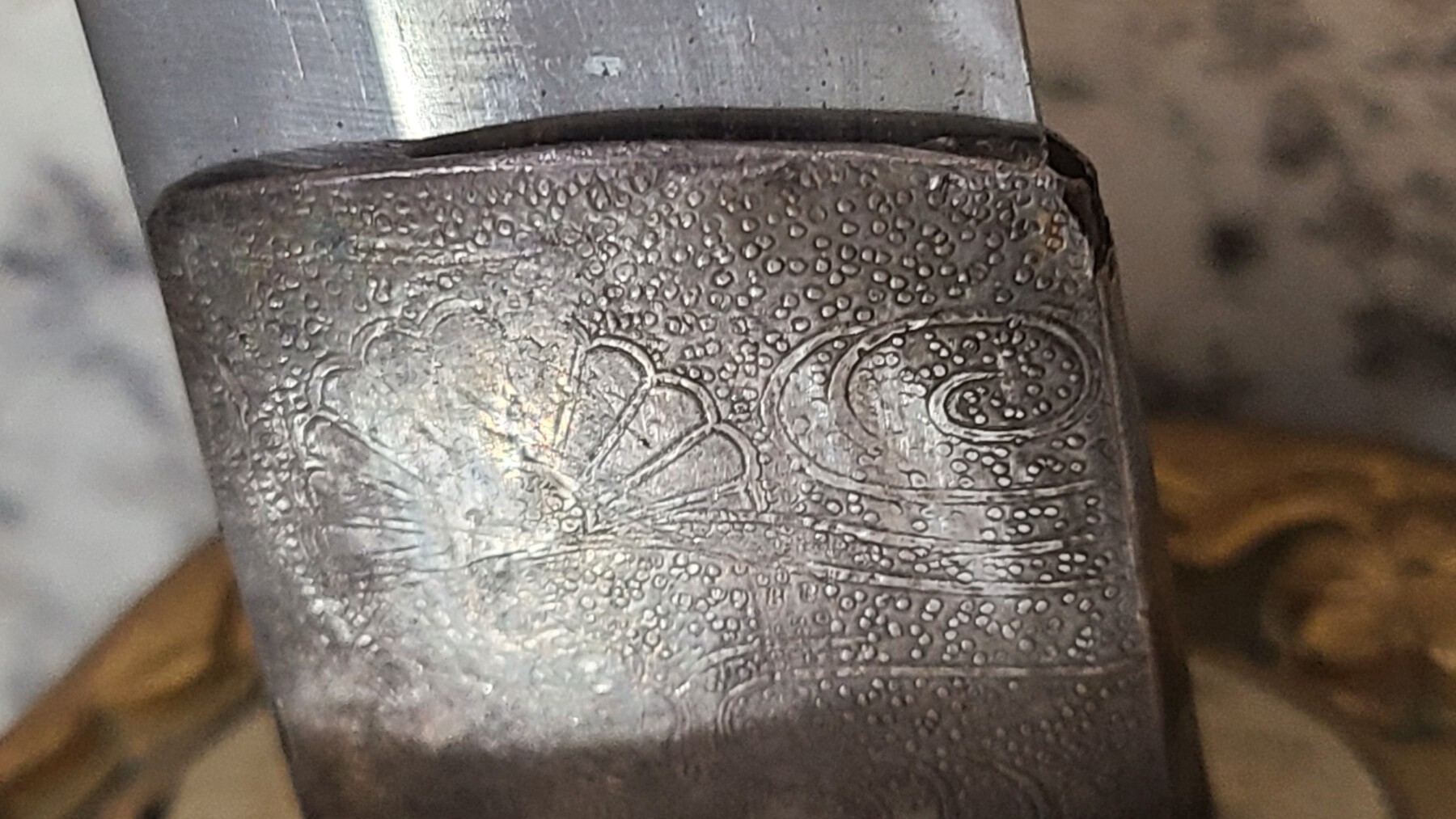

I really like the Habaki, Chrysanthemum Imperial is divine wind I think.

Nice pre-WWII mounts with seldom seen black lacquered Army Saya. Some have hypothesized that this has a connection to the Special Naval Landing Force, the Kikusui-To on the Habaki may offer some support to this.
Dear Jeremy.
Just to back up a little, and forgive me if I over simplify but you did say you knew nothing about the sword.  This is a sword in Shingunto mounts designed and carried by officers during WWII.  It has a pierced tsuba/guard which is a nice sign as most are not cut through, the mounts are in generally good condition and it has an unusual black lacquered saya.  As is often the case it has been fitted with an earlier blade, you know all about the signature.  These are often described as familyy blades but that is known not always to have been the case as desperate measures meant that there was a call up for blades to equip officers later in the war.
At the base of the blade is the habaki/blade collar which is unusual in being silver foiled and with the marks that Maxime mentioned.  Gimei means that the signature is not by the smith that it claims to be.  I can't see much detail of the blade and some of the marks suggest that a previous owner may have polished the blade, bad news and please don't clean or polish anything, just a wipe with light oil will do.

Thanks everyone! Is there anyway to see if the blade is not Gimei, I think it would be awesome if the blade was a older one passed down for the war effort.
Also it is missing the Mekugi, What would be the proper replacement for this?

Gimei blades were made/marked at all points throughout the history of nihonto. Regardless of whether or not this blade is gimei, it is almost certainly an older blade and could still merit restoration. Find a trusted polisher and ask their opinion. You could also take it to a sword club meeting and get opinions there. It is very hard to judge such things from photographs!

Until you find a proper replacement: you can fashion one from a bamboo chopstick. Cut off the proper length from a section of the tapered end. Choose a section that fits without falling out easily.
