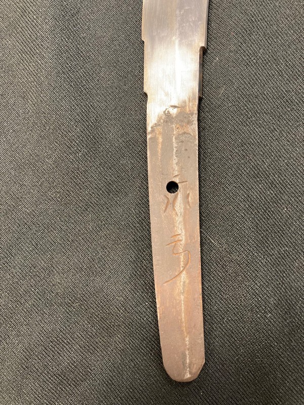

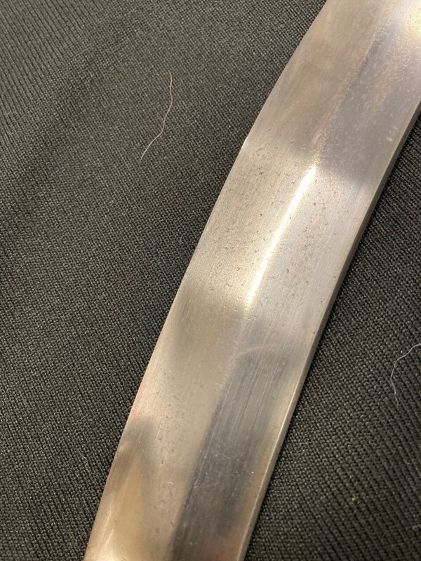

tbonesullivan Posted August 2, 2024 Report Posted August 2, 2024 This looks to be an old Naginata blade that was turned into a wakizashi, and the blade does look old and used, and like a lot of out of polish blades I have seen before. The characters on the tang are not ones I recognize at all. The fittings for the blade are also made from laminated wood, definitely not what I am used to seeing. The "duck" ornaments on the handle are definitely interesting. Quote
ROKUJURO Posted August 2, 2024 Report Posted August 2, 2024 That looks strange to me. Not what I would expect a NAGINATA NAOSHI to look like. The signature is questionable, at least to me. Does not look very Japanese in my opinion. Maybe it is the images.... Quote
Matsu3 Posted August 3, 2024 Report Posted August 3, 2024 The last character vaguely resembles the kanji for origin, 元, but it's a bit of a stretch. Laminated wood is strange, but I'm still a rookie when it comes to nihonto so I cant really say much. Quote
Lee Bray Posted August 3, 2024 Report Posted August 3, 2024 Exagerated sori, crudely shaped nakago, faked patina(imo) on the nakago, strange kanji(if they are kanji at all), plywood...all suggest this is a fake sword. Quote
Matsu3 Posted August 3, 2024 Report Posted August 3, 2024 On 8/3/2024 at 2:46 AM, Lee Bray said: Exagerated sori, crudely shaped nakago, faked patina(imo) on the nakago, strange kanji(if they are kanji at all), plywood...all suggest this is a fake sword. Expand The patina does look faked, looks like mostly red and brown rust, with a line of less rusted metal running down the nakago (maybe, can't really tell with the picture quality). 2 Quote
raaay Posted August 3, 2024 Report Posted August 3, 2024 Sorry , It looks like IMHO, an attempt to make a Japanese style sword . classic issues with the mune-machi and ha-machi . and basically the whole tang etc. Quote
tbonesullivan Posted August 6, 2024 Author Report Posted August 6, 2024 On 8/3/2024 at 3:47 AM, Matsu3 said: The patina does look faked, looks like mostly red and brown rust, with a line of less rusted metal running down the nakago (maybe, can't really tell with the picture quality). Expand I have seen plenty of very old patinated blades, and plenty of WWII blades that barely have any oxidation. This just didn't look right. I can't see any traces of Yasurime, and the edges are not really straight. The Nakago-Jiri in particular just doesn't look shaped right. Quote
obiwanknabbe Posted August 20, 2024 Report Posted August 20, 2024 This has all the looks of a komonjo ebay sword. Its possible that it started as a real blade of some type, but everything about it was tempered with or faked. Quote
