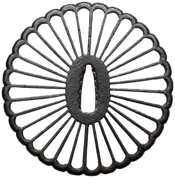

Soshin Posted August 1 Report Share Posted August 1 Here is one dating a little bit later during the early Edo Period. It might be larger than the one in the photo at 10.4 cm. While the openwork looks thin it is not weak and the plate of the tsuba is very thick and well forged. 2 Quote Link to comment Share on other sites More sharing options...

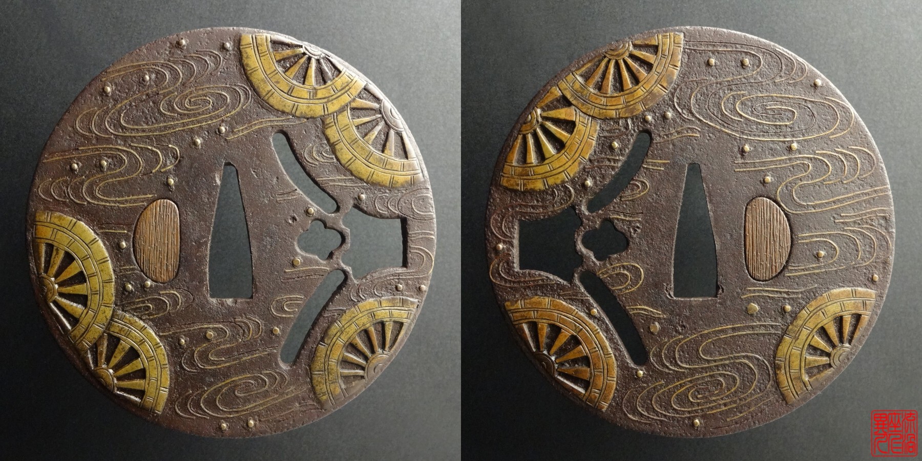

Ghoul Posted August 2 Report Share Posted August 2 I don't know much about mine, but I have often thought my gunbai tsuba could be early and made for war rather than art: It is only 8cm in diameter though, but feels very practical. I do wonder why you would need tsuba any larger than this, as extra weight feels like it would be a disadvantage, and I can't see much benefit of a wider tsuba if its primary purpose is to prevent an opponents weapon from sliding down your own and attacking your hand. So I also agree with the opinions that larger tsuba are likely for show rather than utility. 1 Quote Link to comment Share on other sites More sharing options...
