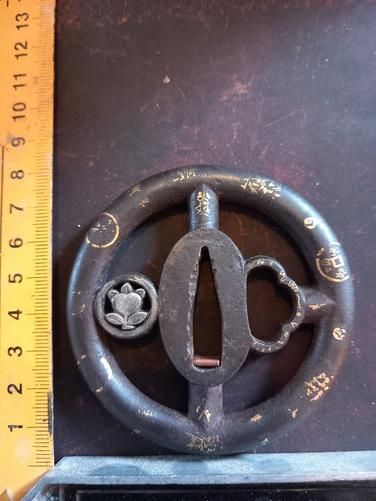

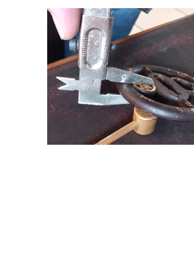

Tohagi Posted July 30, 2024 Report Posted July 30, 2024 (edited) On 7/25/2024 at 11:38 PM, Bruce Pennington said: Nice, and the whole sword looks to be quite nice as well! Hello, and thanks Bruce... Here is a topic about a very unusual Tsuba for me. First time I see such a massive heavy iron tsuba : The thickness of the mimi is almost 1 cm (exactly 9.4mm). The main Kamon is Tachibana (kuse), the copper is added recently... What do you think about it ? is it for nagamaki naoshi or other kind of blade? Did you saw this before? Edited July 30, 2024 by Tohagi 4 2 1 Quote
Curran Posted July 30, 2024 Report Posted July 30, 2024 That is certainly different. I've been around tosogu for a few decades, and don't remember a similar one. I don't know that I can shed much info on this one. My subconscious tells me Kyushu and possibly Satsuma, though I sure as heck cannot articulately explain why. Take that as a semi-educated opinion, but still kinda a shot in the dark. 2 Quote
Bruce Pennington Posted July 30, 2024 Report Posted July 30, 2024 Eric, I haven't seen this design before, but I don't follow tsuba as a collector. You are sure to get some expert opinions on this forum, though. I would say the circled plant in the center is a family mon (crest). I suspect the other surrounding images have some meaning, but the other guys will have to chime in for that, too. Very interesting tsuba. Quote
Tohagi Posted July 30, 2024 Author Report Posted July 30, 2024 Thank you, Yes it's Tachibana(kuse) family crest. It's a cort (curt?) high ranck family, not samourai... and quite enemis/politics oponents of the fujiwara's. Best regards, Éric 3 Quote

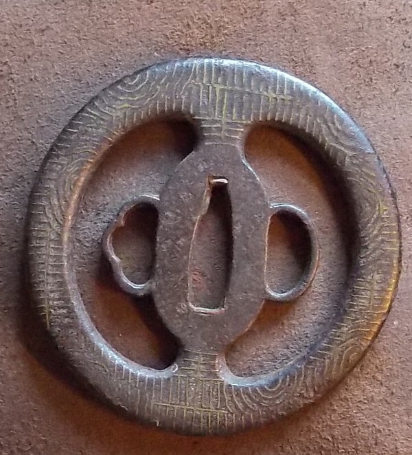

kissakai Posted July 30, 2024 Report Posted July 30, 2024 I looked for the widest tsuba in my book and it is Myochin = 7.9mm No where near yours but may be of interest 5 Quote
Tohagi Posted July 30, 2024 Author Report Posted July 30, 2024 Very close work on the ring ! No higo zogan in this one... Best, Éric VD Quote
Tohagi Posted July 31, 2024 Author Report Posted July 31, 2024 (edited) Could my Tsuba be Ono School ? They are known to make heavy and thick iron sukashi tsubas... Here another thick iron Tsuba I found on line (7.2mm). At least, this Tsuba can be used as an anchor ! https://japaneseswor...n-tsuba-with-anchor/ Edited July 31, 2024 by Tohagi 3 1 Quote
OceanoNox Posted August 1, 2024 Report Posted August 1, 2024 It almost looks like a buckle or a clasp for capes and coats. 1 Quote
Toryu2020 Posted August 1, 2024 Report Posted August 1, 2024 I would say it is not Ono since they were an Owari group so they didn't do pieces as detailed as yours - simple Owari and Yagyu designs. The "anchor" I believe is a rice bail hook and not an anchor... -t 1 Quote

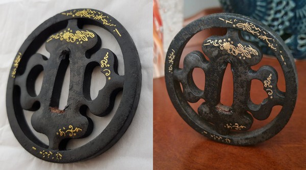

Tohagi Posted August 1, 2024 Author Report Posted August 1, 2024 Thank you for your very instructive answer, do you have a guess on this unusual work? I realy don't have a clue... Best regards, Éric VEGAS DANGLA Quote
Toryu2020 Posted August 1, 2024 Report Posted August 1, 2024 Eric - if you are asking me, I have to say I do not know who might have made these though my impression is that it is later work, say 1800's... -t 1 Quote
Robert S Posted August 1, 2024 Report Posted August 1, 2024 At a guess all of these come from one or more craftspeople that were experimenting with casting. Getting those cylindrical shapes is entirely natural in casting, but a lot of work using other techniques. That aligns with the idea that these are later work. Robert S 2 Quote

Soshin Posted August 2, 2024 Report Posted August 2, 2024 On 7/30/2024 at 12:21 PM, Curran said: That is certainly different. I've been around tosogu for a few decades, and don't remember a similar one. I don't know that I can shed much info on this one. My subconscious tells me Kyushu and possibly Satsuma, though I sure as heck cannot articulately explain why. Take that as a semi-educated opinion, but still kinda a shot in the dark. The thickness of the plate reminds me of Satsuma School but the overall size of the the tsuba is I think a bit too large for a Satsuma School tsuba. The Ono School has tsuba I have seen all have a thick robust plate and openwork like this tuba but would not have the soft metal inlay decorations like this tsuba has. All the Ono tsuba I have owned and examined showed strong well defined iron bones (tekkotsu 鉄骨) along the rim or even sometimes on the surface of the tsuba. I have seen nice robust signed Myochin School tsuba with later decorations done to the plate. @Tohagi Eric VD I hope you find this information helpful to your tsuba. 1 Quote
Tohagi Posted August 2, 2024 Author Report Posted August 2, 2024 Dear David, Thank you so much, this is helping a lot . It seems that Myochin could be a solid clue, it was Kissakai first impression too. The nunome zogan work could be a later work, even if the Tachibana Kamon should have been plated from the begining IMO.... The overall size is 7,8 /7,9 cm it's still à big tsuba, I confirm no tekkotsu like the one you can see in Akasaka's, just the iron normal deformation in curving the ring (upper inside). Wish you the best, Éric VD 1 Quote

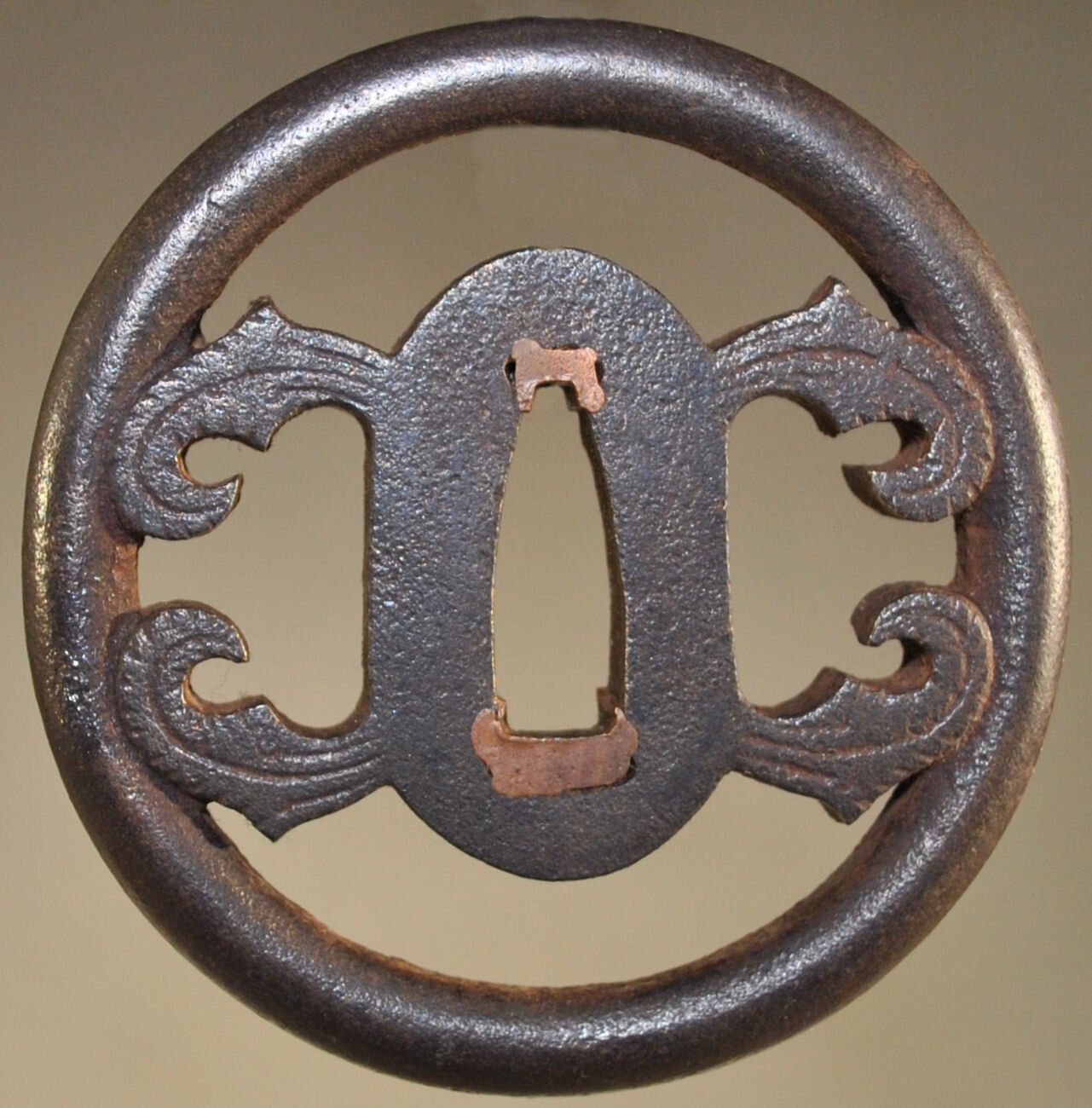

Steves87 Posted August 2, 2024 Report Posted August 2, 2024 There are quite a lot of thick guards out there, this one is not as thick as the example you have, but it is able to stand upright on the face of the mimi. I believe this represents a Mon, but I couldn't tell you which one, off the top of my head. 4 Quote
Tohagi Posted August 2, 2024 Author Report Posted August 2, 2024 Very, very intersting and nicely done Tsuba ! Do you know what school is it ? Best, Éric Quote
