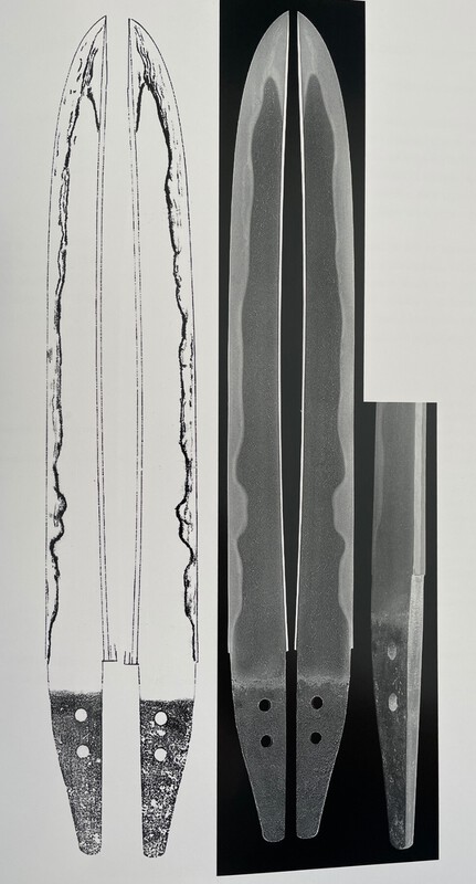

From NBTHK's Oshigata collection
Looks peaceful to me.
I'd say there's no typical hamon in Muramasa's work, he quenched in many different forms : notare, notare midare, sanbon-sugi, O-midare, togari gunome, hako midare ( it's posssbile i forget some).
