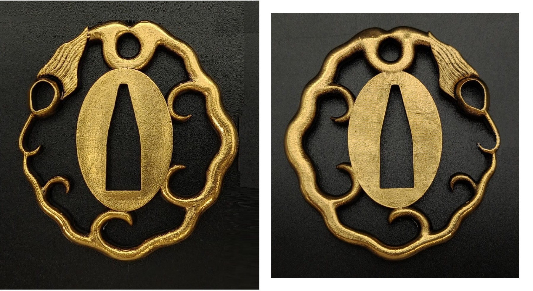

Spartancrest Posted July 27, 2024 Report Posted July 27, 2024 I have been collecting images of the "rain dragon" tsuba for several years now [134 so far] and I came across this one today. https://www.jauce.com/auction/m1146338096 It immediately stood out to me as a modern fake. Then having a closer look I noticed the seppa-dai had rows etched across it and certain areas showed concentric ridges following the contours all over the "metal". What I can't figure out is was the entire guard 3D printed or was the blank used for casting purposes printed? [Let us for now ignore the dragon has no eye, there is a seam running around the edge of the mimi and that they have modeled the nakago-ana on a coke bottle!] 4 Quote
PhoenixDude Posted July 27, 2024 Report Posted July 27, 2024 Probably 3d printed a model and used it to create the mould. 3 1 Quote
Steves87 Posted July 28, 2024 Report Posted July 28, 2024 I agree with Jay, I have a feeling only steel is 3d printed at this point; however, wax can be 3d printed for casting brass (lost wax casting), so this is very possible in this case https://www.zeal3dprinting.com.au/brass-3d-printing/#:~:text=The lost-wax casting method,in the final product design. 1 Quote
Geraint Posted July 29, 2024 Report Posted July 29, 2024 Dear All. Good spot Dale. Jay and Stephen are almost certainly correct about the use of a lost wax process for this tsuba, however the range of metals now used in additive manufacturing is immense at this point, from one reference, Aluminium alloys Cobalt-base alloys Tool steels Nickel-base alloys Stainless steels Titanium alloys Precious metal alloys Copper alloys Processes used include electron beam and laser fusing, though the properties of the finished component need some working out. (I think that this level of processing would be far too expensive to make it worth the effort for this type of tsuba.) It gets more and more interesting as the days go by! All the best. 1 1 Quote
