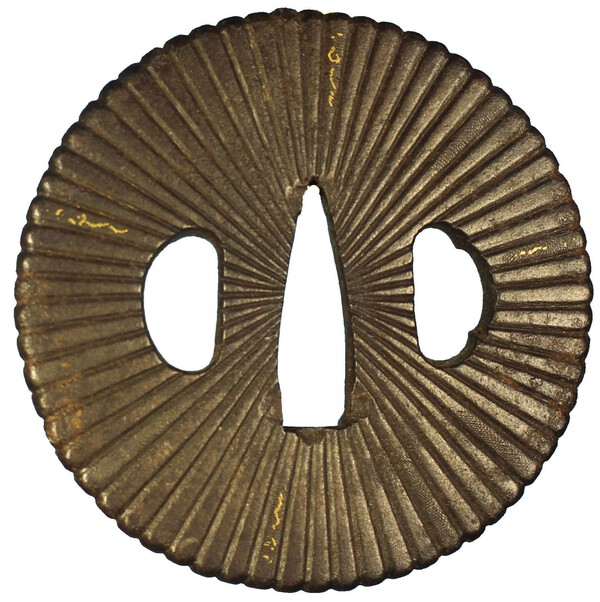

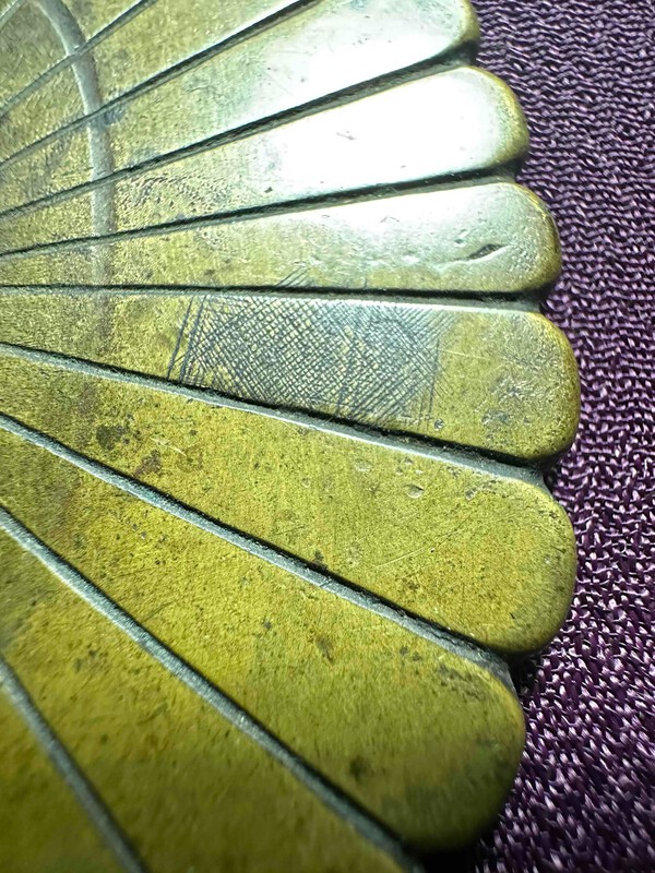

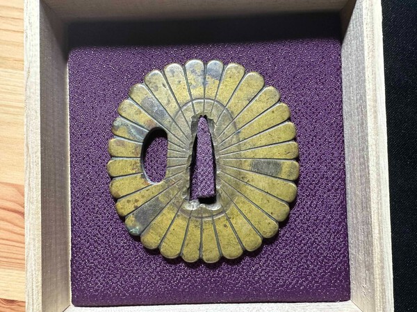

Okan Posted July 22, 2024 Report Posted July 22, 2024 Hello guys, Here is an interesting piece, Momoyama period perhaps? Nunome zogan on 3 petals on both sides, but I can't see any remains of silver or gold...An early experiment piece maybe? 6 Quote
kissakai Posted July 22, 2024 Report Posted July 22, 2024 That is interesting Mine is quite different and quite a bit later but the cross hatching is very similar 4 Quote
FlorianB Posted July 25, 2024 Report Posted July 25, 2024 In my eyes the piece seems to be mere a model. Best, Florian Quote

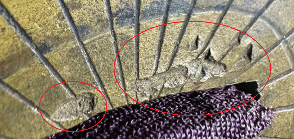

ROKUJURO Posted July 25, 2024 Report Posted July 25, 2024 Florian, as SHINCHU and SENTOKU were very valuable materials, I don't think so. Also, the SEPPA-DAI shows traces of long-term use, so I believe it has some age to it. Quote
Matsunoki Posted July 25, 2024 Report Posted July 25, 2024 On 7/25/2024 at 5:50 AM, FlorianB said: mere a model. Expand Interested to hear why you think that. Quote
Spartancrest Posted July 26, 2024 Report Posted July 26, 2024 I know we are talking almost microscopic details here but I can't help noticing the nunome scoring has skipped over the petals in one segment. Early type of work or a rushed job? [I think OLD - IMHO] What could have caused this? Tagane-ato gone wrong? Quote
FlorianB Posted July 26, 2024 Report Posted July 26, 2024 Hi Colin, it was just an idea. Indeed I haven’t considered the former value of these materials as Jean mentioned. BTW: Have there been models at all? Best, Florian Quote

ROKUJURO Posted July 26, 2024 Report Posted July 26, 2024 Concerning the cross-hatching areas, they are usually larger than needed for the application of the NUNOME ZOGAN decoration The exceeding area is usually burnished down later in the process with a MIGAKI-BO, if I am correctly informed. But admittedly, this TSUBA is a bit of an enigma. The cross-hatching does not show remaining traces of gold or silver, so the TSUBA may have been used only half finished. The cross-hatching is not recently done in my opinion; it looks used and the usually sharp edges are rounded. I have no good explanation for the defects on the SEPPA-DAI. Taking samples for scientific material analysis? Who knows? Perhaps Ford? 1 Quote
Rodenbacher Posted July 27, 2024 Report Posted July 27, 2024 It looks to me as if an apprentice has practiced the technique on an old piece. It's definitely a Tsuba which was in use, but not a very precious one, so maybe it was taken from an old sword and used as a practicing piece. Also the marks on the seppa-dai could be traces of trying some sort of a tool by an apprentice. Quote
