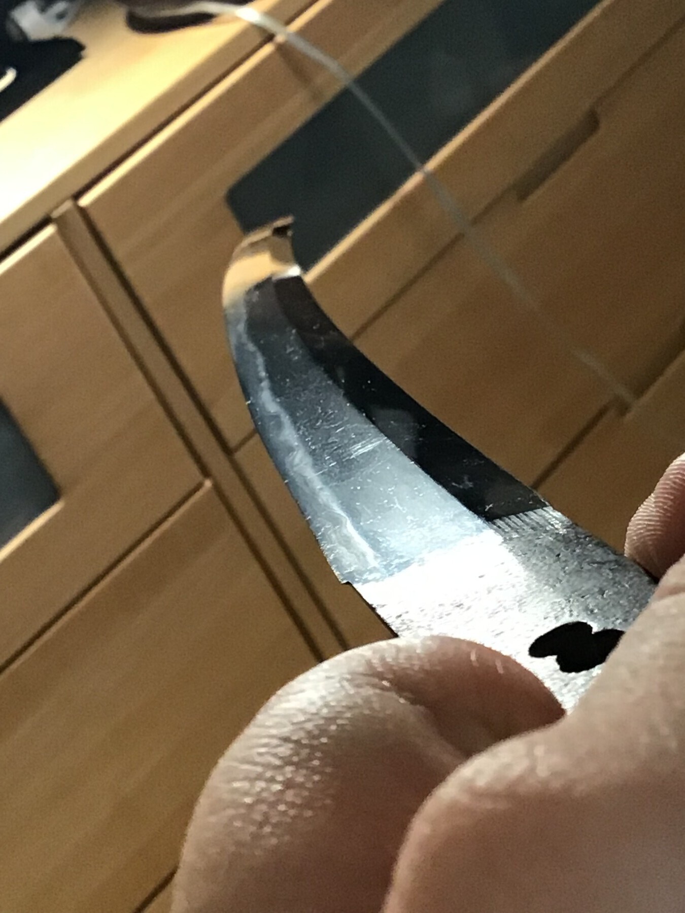

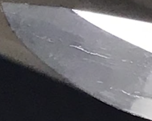

nulldevice Posted March 16 Report Posted March 16 Is that last photo showing maybe some of a boshi? Since the kissaki is small, you don’t want the direct glare in the photo. Usually you can see the boshi best with the glare (direct reflection) just off the blade and having the angle just right to see the temper line where it transitions to the tip. Some blades have a boshi that runs very close and may be touching the cutting edge or they may have a reshaped kissaki where the boshi runs off indicating previous damage to the tip that was reshaped. Quote
Zoglet Posted March 16 Author Report Posted March 16 On 3/16/2025 at 11:41 PM, nulldevice said: Is that last photo showing maybe some of a boshi? Since the kissaki is small, you don’t want the direct glare in the photo. Usually you can see the boshi best with the glare (direct reflection) just off the blade and having the angle just right to see the temper line where it transitions to the tip. Some blades have a boshi that runs very close and may be touching the cutting edge or they may have a reshaped kissaki where the boshi runs off indicating previous damage to the tip that was reshaped. Expand Took closer pictures using your advice. I see very little boshi in the 2nd picture, and more on the other. Quote

Zoglet Posted March 17 Author Report Posted March 17 Here are photos I took. Only the faintest amount of boshi can be seen. Quote
