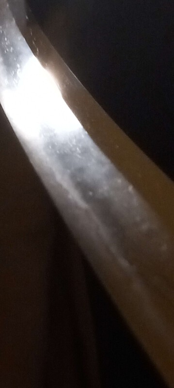

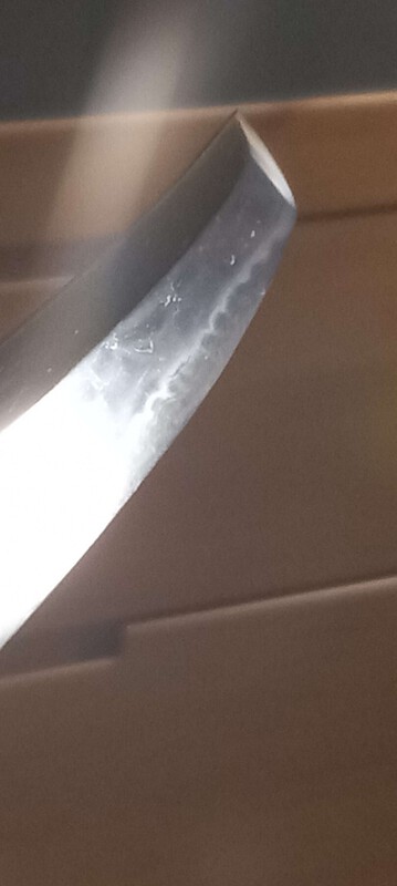

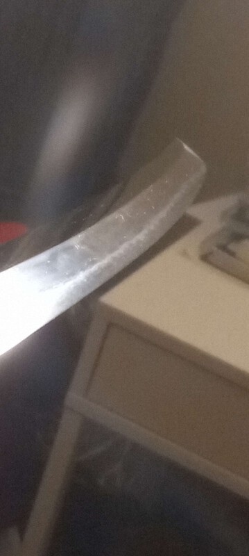

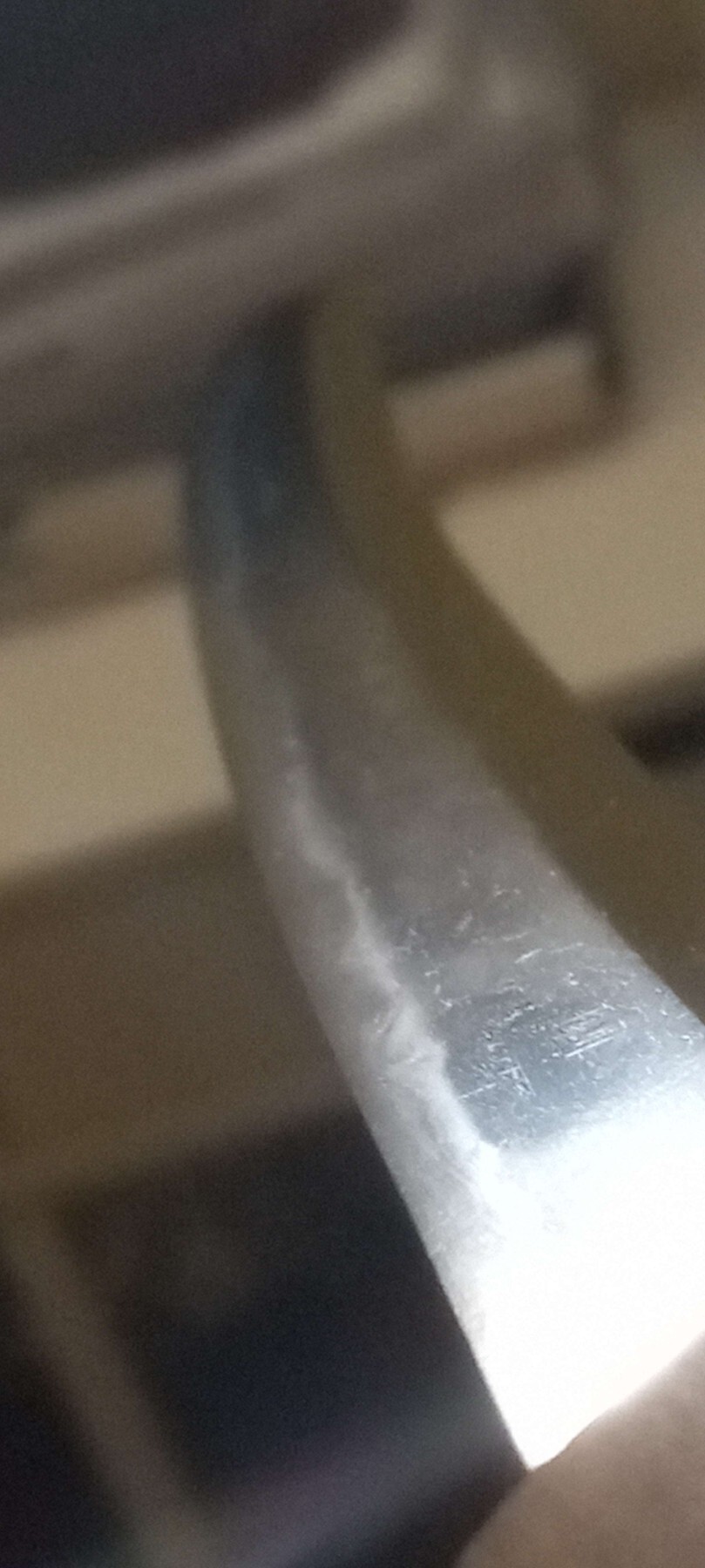

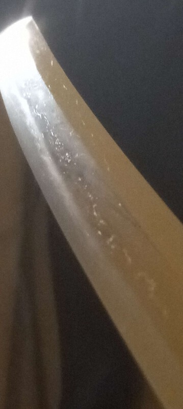

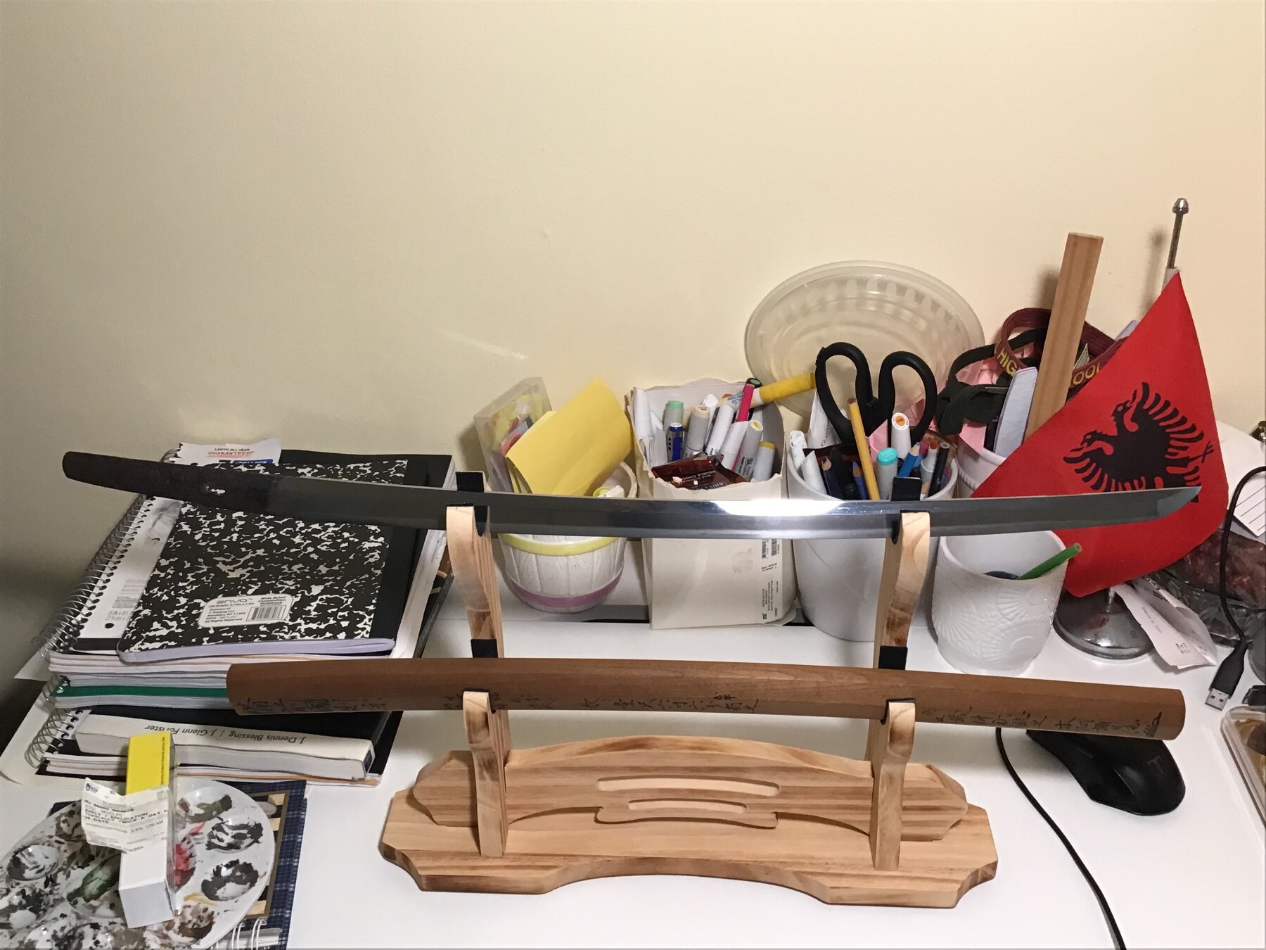

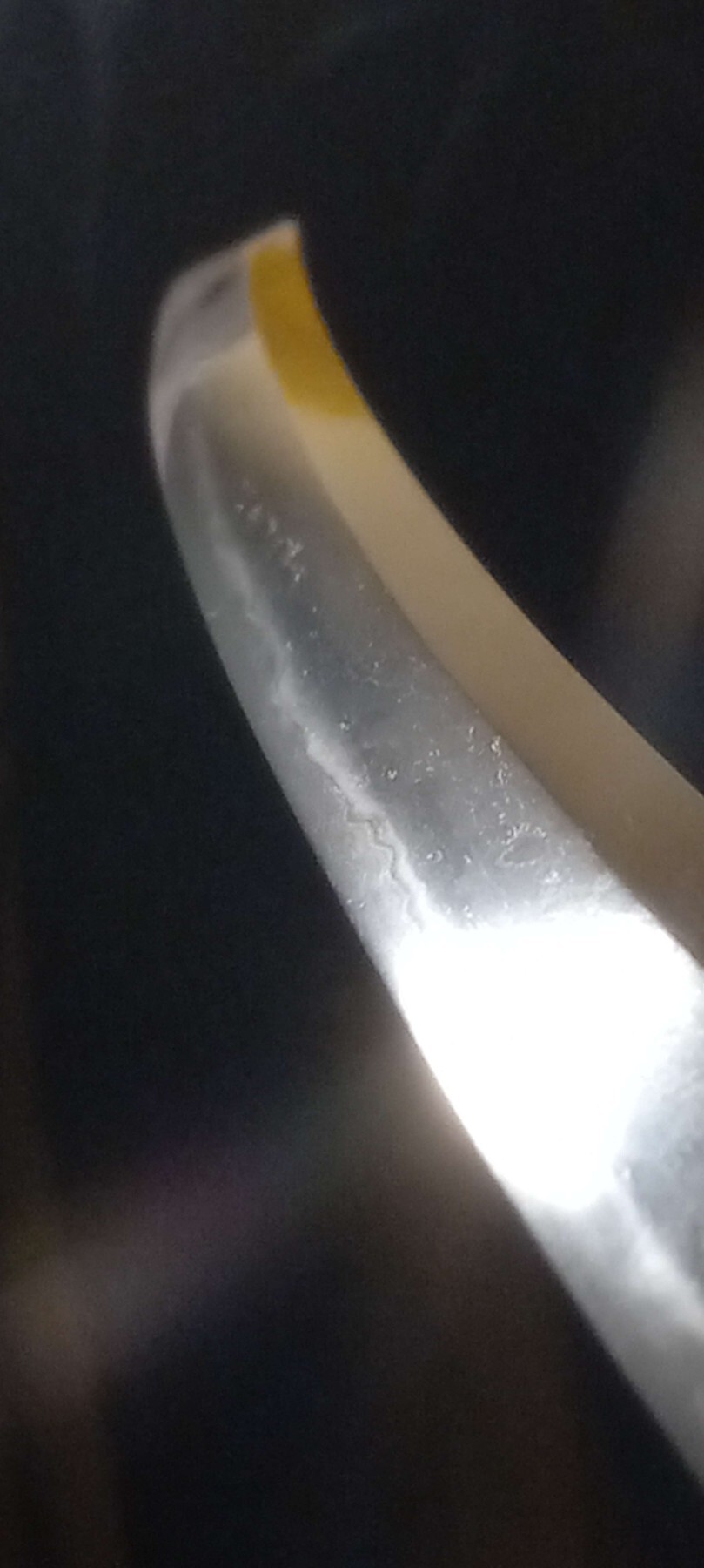

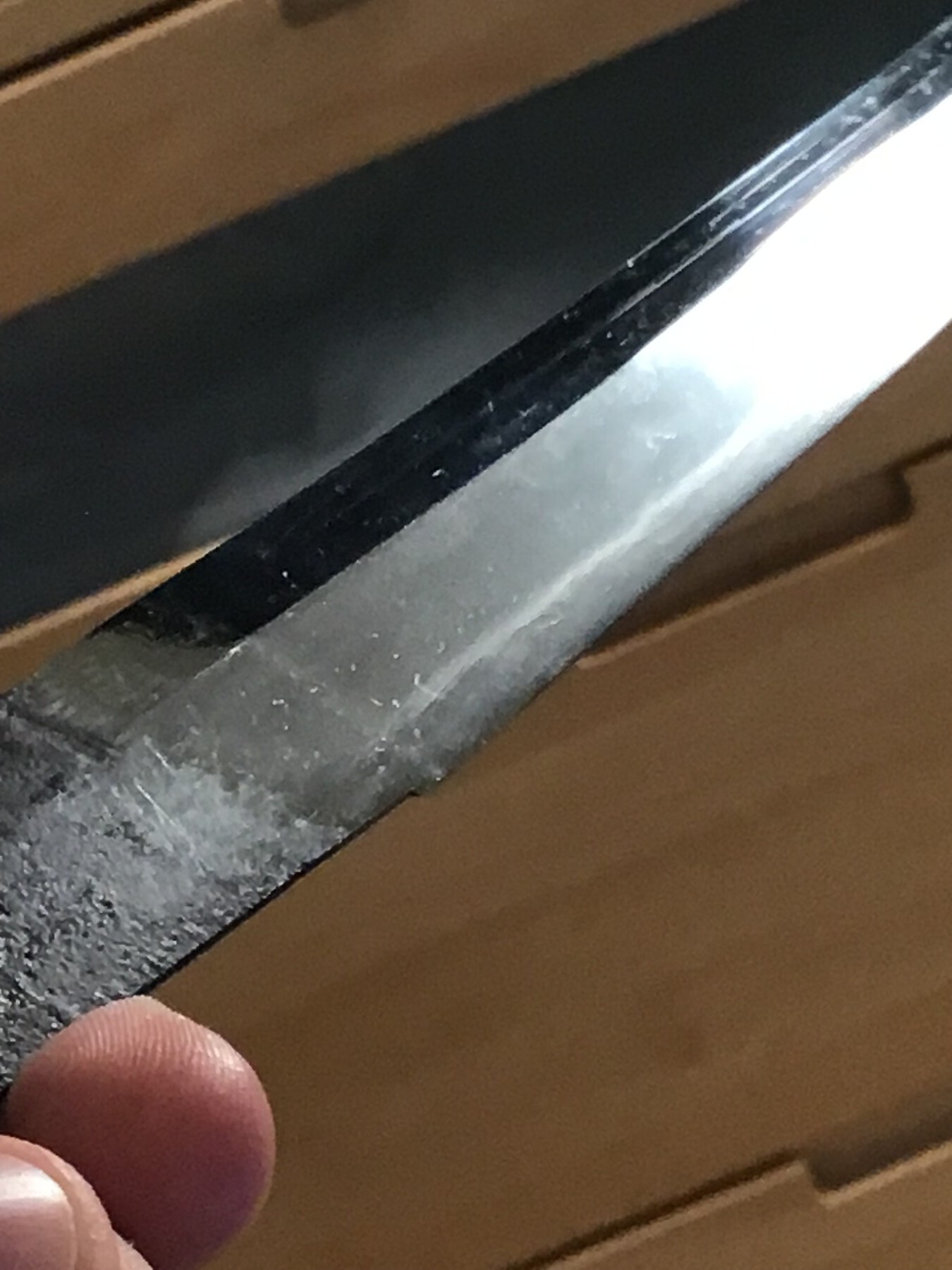

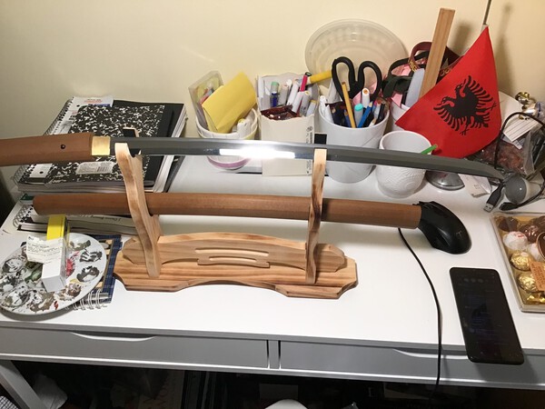

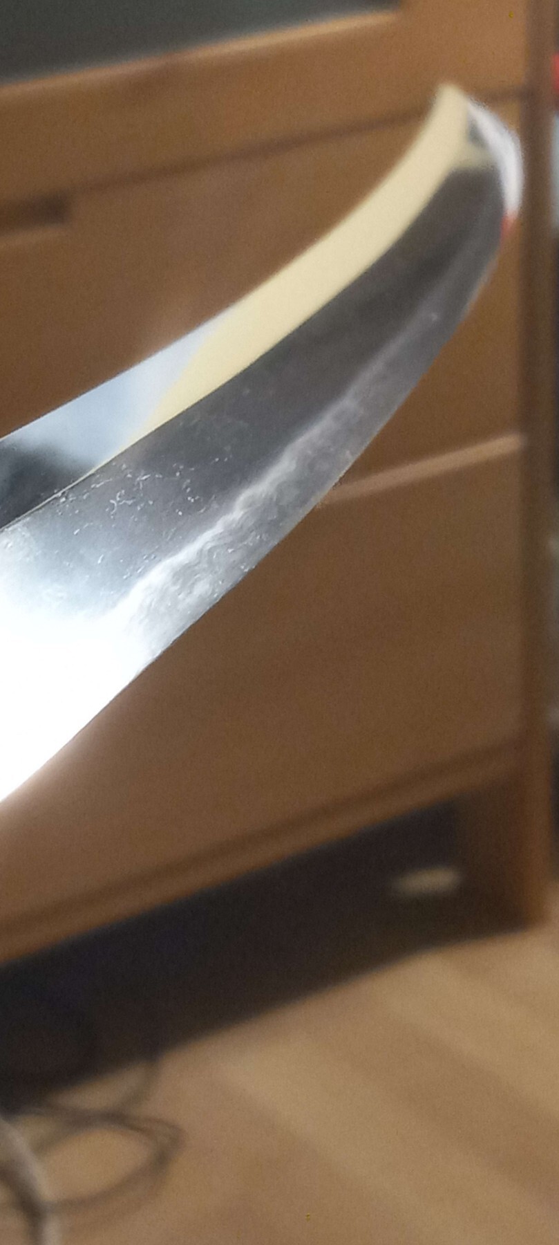

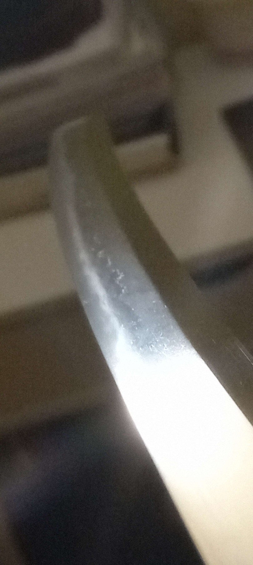

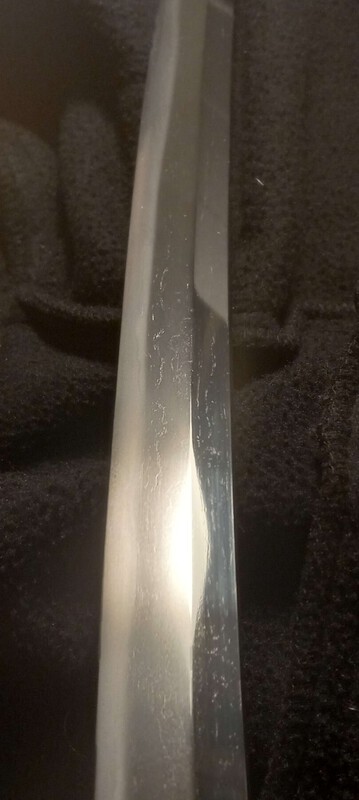

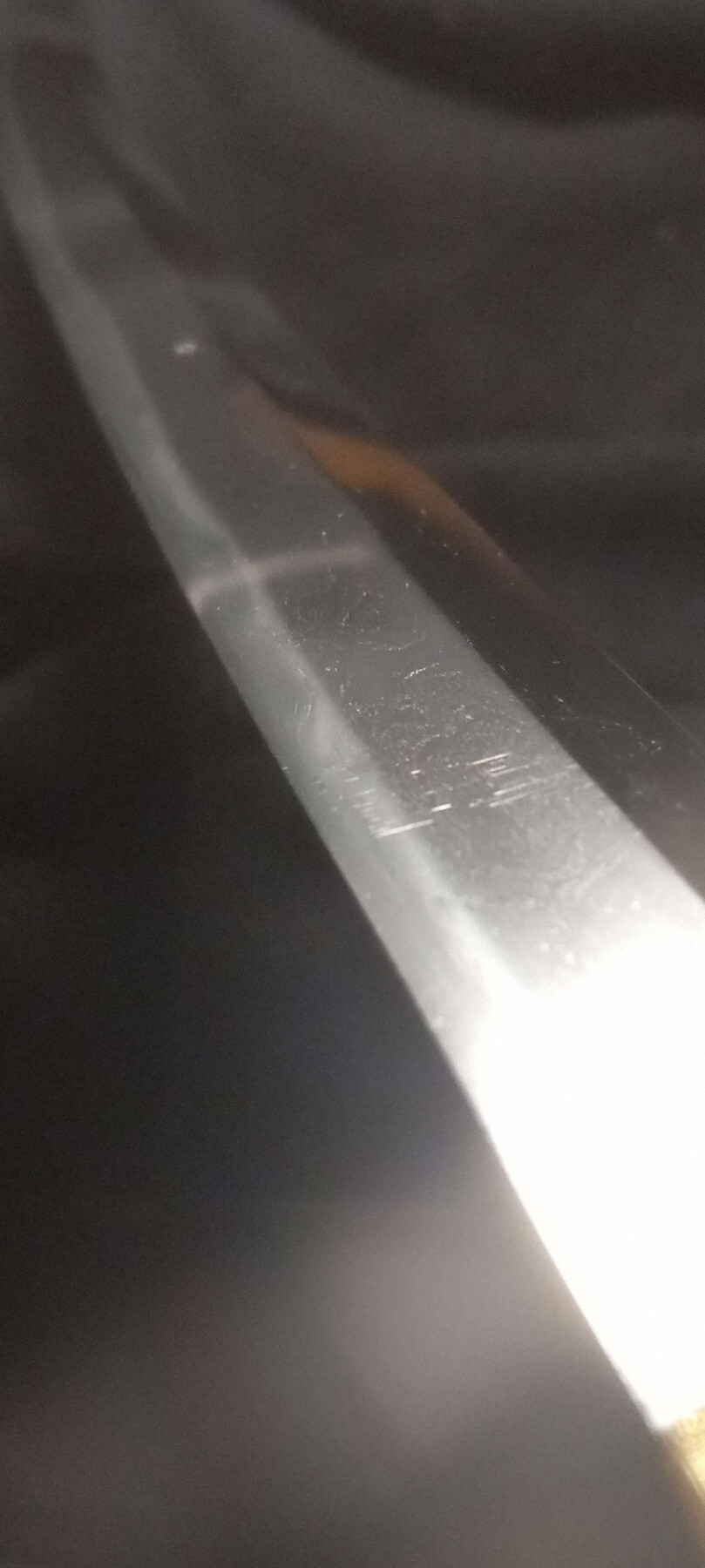

Zoglet Posted March 16 Author Report Posted March 16 Hello everyone, I am so sorry to get back to this so late. I was finally able to take better photographs of the blade and study a bit more about the Ichimonji school. I now lack the belief that the blade is Ichimonji, however, I am still a bit questioning on what exactly this blade is. I was able to take better photographs of the utsuri, hamon, and jihada. Thanks to anyone still willing to hear me out here. Forgive the imperfections in the photos, as my camera is not great, and the clutter. I keep my nihonto in a better environment, but that room is the only one with an incandescent lamp. Quote
Rivkin Posted March 16 Report Posted March 16 That's actually looks like a nice blade which I would prefer to look in hand and see what's there. Might have a potential, though the signature is still... ambitious. Quote
Zoglet Posted March 16 Author Report Posted March 16 On 3/16/2025 at 5:20 AM, Rivkin said: That's actually looks like a nice blade which I would prefer to look in hand and see what's there. Might have a potential, though the signature is still... ambitious. Expand Thanks for the quick evaluation. I'm trying as best I can to send quality pictures. Quote
PNSSHOGUN Posted March 16 Report Posted March 16 Utsuri and Inazuma visible, clearly a sword worth further appraisal. Quote
Zoglet Posted March 16 Author Report Posted March 16 On 3/16/2025 at 6:34 AM, PNSSHOGUN said: Utsuri and Inazuma visible, clearly a sword worth further appraisal. Expand The traces of inazuma caught my eye too, and the utsuri has this bright, midare-style pattern. Interested to learn more. Quote
Zoglet Posted March 16 Author Report Posted March 16 John, those are typical early Bizen traits, no? Quote

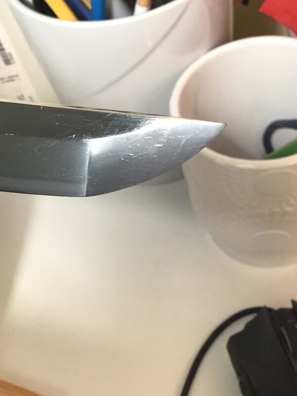

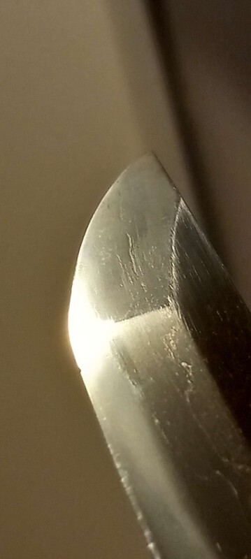

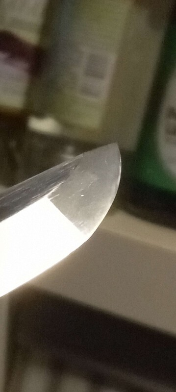

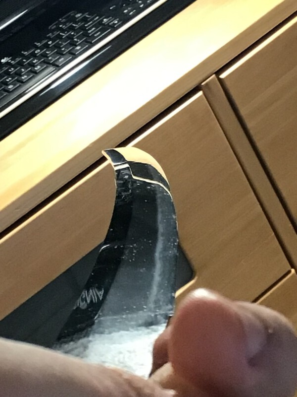

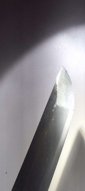

Lewis B Posted March 16 Report Posted March 16 On 3/16/2025 at 4:50 PM, Jacques said: Kissaki seems reshaped Expand That was my thought too looking at the hamon and the angle it approaches the yokote. Can we get some clearer images of the kissaki and boshi? Quote

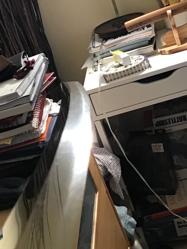

ROKUJURO Posted March 16 Report Posted March 16 In my opinion, these really bad photos do not allow a precise KANTEI. What I think I can see is that the blade is quite tired. Nicholas, blurry or foggy images do not help. You need a dark, non-reflecting background, nicely focused photos made directly from above if possible. Play with the lighting and cut the photos out so very little background is seen. 2 Quote
Zoglet Posted March 16 Author Report Posted March 16 On 3/16/2025 at 7:48 PM, ROKUJURO said: In my opinion, these really bad photos do not allow a precise KANTEI. What I think I can see is that the blade is quite tired. Nicholas, blurry or foggy images do not help. You need a dark, non-reflecting background, nicely focused photos made directly from above if possible. Play with the lighting and cut the photos out so very little background is seen. Expand I'm sorry, Jean. I'm trying as best I can. Quote
Rivkin Posted March 16 Report Posted March 16 This is a complex blade and getting better images might realistically not happen. There is little seen. It needs to be handled in hands. But to give it some prospective: [1] strong multi-layered midare utsuri which reaches high towards shinogi. [2] More or less periodic choji with not much height or width variation in nioi/ko nie [3] The choji is composed from layers of ko nie as if drawn by pencil - very well formed, accented, separate and distinct with inazuma/kinsuji in ko nie. [1] and [2] are very good. This is ko ichimonji style. It really looks like Sadazane where you see kinsuji/inazuma in ko nie. In oshigata this blade would be ko Ichimonji. But... [3] is how first tier imitators of ko Ichimonji worked, for example, in shinshinto. Kiyomaro, Kajihei. The blades they made have much sharper and well outlined hamon structure, compared to more natural, soft and flowing ko-Ichimonji work. Also their utsuri why reaching out to jifu utsuri and reaching to shinogi has very uniform, strong tint, compared to richer appearance of the original. How much money you are in it? Generally I would send this blade to NBTHK for papers. It will fail. Remove the signature. Resubmit. There is a chance you will get a good name. 1 Quote
Zoglet Posted March 16 Author Report Posted March 16 On 3/16/2025 at 8:57 PM, Rivkin said: This is a complex blade and getting better images might realistically not happen. There is little seen. It needs to be handled in hands. But to give it some prospective: [1] strong multi-layered midare utsuri which reaches high towards shinogi. [2] More or less periodic choji with not much height or width variation in nioi/ko nie [3] The choji is composed from layers of ko nie as if drawn by pencil - very well formed, accented, separate and distinct with inazuma/kinsuji in ko nie. [1] and [2] are very good. This is ko ichimonji style. It really looks like Sadazane where you see kinsuji/inazuma in ko nie. In oshigata this blade would be ko Ichimonji. But... [3] is how first tier imitators of ko Ichimonji worked, for example, in shinshinto. Kiyomaro, Kajihei. The blades they made have much sharper and well outlined hamon structure, compared to more natural, soft and flowing ko-Ichimonji work. Also their utsuri why reaching out to jifu utsuri and reaching to shinogi has very uniform, strong tint, compared to richer appearance of the original. How much money you are in it? Generally I would send this blade to NBTHK for papers. It will fail. Remove the signature. Resubmit. There is a chance you will get a good name. Expand I'm down $1100 on the blade. Going to send better photos now if I can. Quote
Rivkin Posted March 16 Report Posted March 16 At 1100 you should be good, at least I would buy it if you are selling. It looks like an interesting blade and in 1970s it was simply judged optimistically. There is something weird going on with kissaki, as if it was shortened and there is a question what's happened with hamon there. 1 Quote
