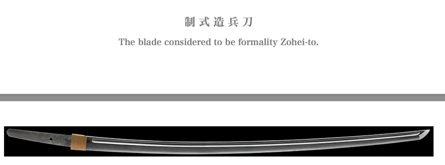

John C Posted July 16, 2024 Report Posted July 16, 2024 Does look like a nice zohei-to. From Ohmura's site: John C. 2 1 Quote
