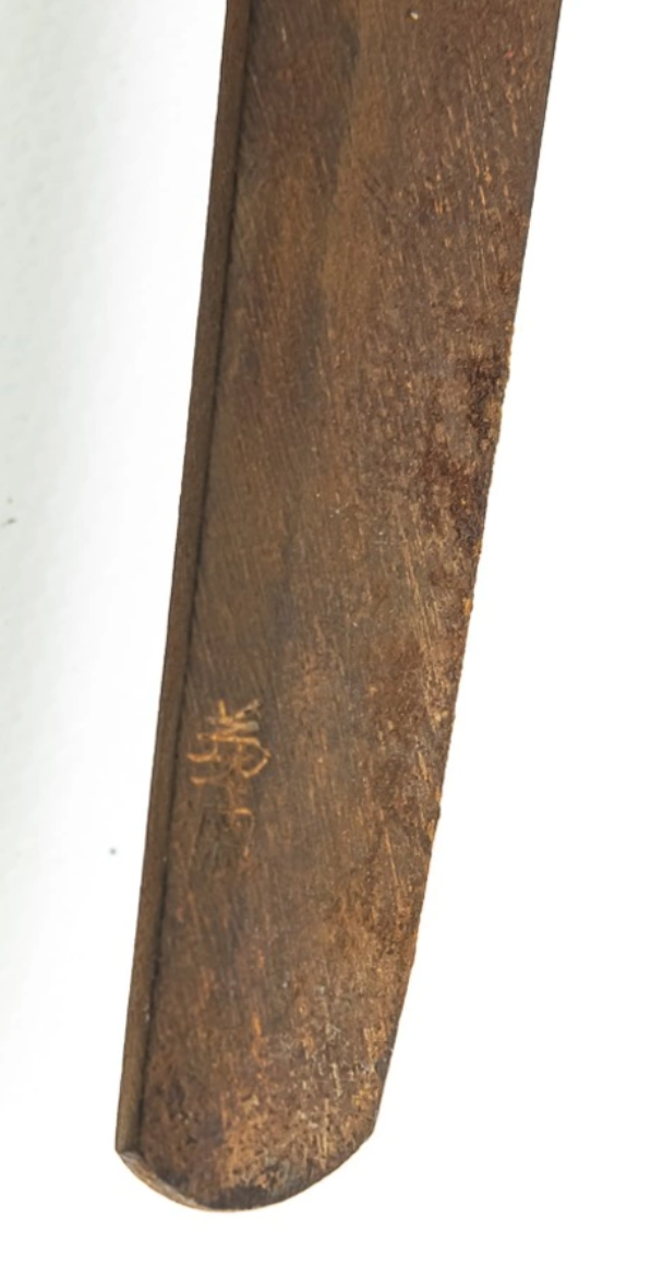

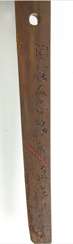

Bruce Pennington Posted July 10, 2024 Report Posted July 10, 2024 "Seki" is as far as I can get! And any chance this means something? Thanks guys! Quote
Deiro Posted July 10, 2024 Report Posted July 10, 2024 I fear I gave someone a terrible headache, 関住人各務行直作 back could be 為より in cursive. Not my field, I myself can't help further. 1 1 Quote
ROKUJURO Posted July 10, 2024 Report Posted July 10, 2024 Bruce, the smith's name might be YUKIMICHI, but the photo is at an angle which is not helpful for reading. I am sure the experts can read all of it, even the single KANJI on the URA. If you have the possibility, please make photos of the NAKAGO on a dark background, directly from above, with the light from the side. Quote
Bruce Pennington Posted July 10, 2024 Author Report Posted July 10, 2024 Yukimichi with the alternative michi! Thanks guys! Sorry, these are photos from an auction site, so the only one's available. Quote
ROKUJURO Posted July 10, 2024 Report Posted July 10, 2024 On 7/10/2024 at 5:55 PM, Bruce Pennington said: these are photos from an auction site, so the only ones available. Expand I thought so. The MEI looks like 行 道 to me, so a standard 'MICHI'. Quote
Nobody Posted July 10, 2024 Report Posted July 10, 2024 On 7/10/2024 at 5:28 PM, Deiro said: I fear I gave someone a terrible headache, 関住人各務行直作 back could be 為より in cursive. Not my field, I myself can't help further. Expand I agree with your reading for the mei. 関住人各務行直作 – Seki junin Kagami/Kagamu Yukinao saku One kanji on the back side might be 弟 – younger brother. I am not sure. 2 1 Quote
YOSE Posted July 11, 2024 Report Posted July 11, 2024 Ura side: might it be 義岡 or 義国? It seems that there are two kanji, though it might just be my novice eyes. Quote
Bruce Pennington Posted July 11, 2024 Author Report Posted July 11, 2024 Again, thanks guys! I was bothered by the small stroke at the left base of the second kanji, but after seeing Moriyama-sans post, I checked Sesko. He uses this, and it matches (wow, when I copy and paste, it changes the kanji to 行直) I'm taking a screenshot and posting it. Quote
