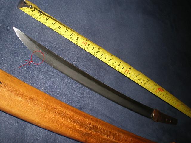

Jock Posted December 17, 2009 Author Report Posted December 17, 2009 Does it have a kaeri (return) or is it Yakizume (running straight to the mune)? _________________ Jean Hi Jean, I twisted and turned the blade in different angles in the light until my eyes popped out - and yes there is a 1mm wide (and then getting thiner and thiner) return for about 3.5 -4 cm Jock Quote
Jean Posted December 17, 2009 Report Posted December 17, 2009 Strange for a Nagamaki Naoshi .... Quote
george trotter Posted December 17, 2009 Report Posted December 17, 2009 Jean, Not so strange if it is not naoshi, such as if it was made as a small (woman's) naginata. Also, can I comment on the use of Jap wak kat? Under the rules of English, and good manners, it is perfectly acceptable to use these as abbreviations, for example Jap. wak. kat. The full stop (period for the Americans) must never be neglected. Personally I shudder to see these shortenings used, but remember if you use the full stop it is correct, polite grammar in English. Regards, George. Quote
uwe Posted December 17, 2009 Report Posted December 17, 2009 Hi Folks, as far as I know, we had to distinguish between naginata and nagamaki Uwe Quote
Jean Posted December 17, 2009 Report Posted December 17, 2009 Interesting George : I was starting from 2 hypothesis : - Taking into account the very small sori I was going for a Nagamaki rather than a naginata - I thought it was o suriage - but perhaps not taking into account the nakago look. It is certainly Machi okuri by the distance of the 2 Mekugi ana (Must have been before around 36 cm), perhaps the reason why the habaki has been mutilated, but for the rest (O suriage) it is pure speculation from my part. But then again when you see Naginata Nakago they are much longer and much thinner and the mekugi ana is much lower : http://www.aoi-art.com/sword/naginata/main.html I have not seen Women Naginata but if some one had some pictures to spare I'll be glad to see them. Quote

george trotter Posted December 18, 2009 Report Posted December 18, 2009 Hi all, Yes an interesting point...naginata or nagamaki. The naginata usually becomes much broader in the boshi than nagamaki? I just spoke on my memories of 30 years ago. The women dancers were talking specifically about samurai women and their weapons and techniques to defend the house and it was put down in song and dance to help them learn/remember the kata (way of doing). They said it was a naginata, and if I recall, they said it was a woman's naginata because they also showed us makuriyari (a woman's "pillow spear")...very small and light...usually kept near the futon in case the bedroom is attacked. But I must admit, I don't know if there were yari and naginata made especially for women...I just remember the one she used was very much like this one. As for the tang, I agree they are slimmer and longer and the mekugiana is further down than wakizashi, but we don't know for sure here whether the tang is suriage and machiokuri to the extent that all the original tang is gone. If is has gone then perhaps it is not so small after all. just a thought. George. Quote
Jock Posted December 20, 2009 Author Report Posted December 20, 2009 Bruno said: Jock, Is the munemachi descent(3-4 mm)? I have been told by skilled man that it is one of the good good way to see if the sword is tired or not. May we have a pic of it please? Regards Hi Bruno, My apology for the delay in replying to your message above - the munemachi is 4mm - I need a new camera as soon as I have it I'll post a pic! Jock Quote
Bruno Posted December 21, 2009 Report Posted December 21, 2009 Hi Jock, Thank you. In fact, I 've made a mistake! I meant the ha machi instead of the munemachi. 4mm is good enought anyway. I have been told that the ha machi should measure at least 4/5 mm otherwise the blade could be a bit tired to tired to death, and that sometime nakago have been filed at the hamachi and/or munemachi to make them more important, so the sword younger.Thus, it is more difficult to determine how the sword is tired. Quote
Jean Posted December 21, 2009 Report Posted December 21, 2009 Bruno, Forget the hamachi thing (though if non existing or small is an indication), there are a lot of other signs showing if the sword is tired or not. Furthermore it does not work on suriage blade, machi okuri ..... Quote
george trotter Posted December 22, 2009 Report Posted December 22, 2009 An interesting point Jean... Just to clarify the ha/mune machi thing...the original question was about the mune-machi indicating tiredness...I said the ha-machi is more likely to be an indicator than the mune-machi. Jean, with repect, while I agree there are a lot of other signs of tiredness in a blade I don't think it is wise to just "forget about the ha machi thing". Because the blade wears thin with many polishes,and the nakago stays thick, the ha-machi/habaki fit is especially a sign of tiredness (IMHO) or at least repeated polishings. You say, the matter does not exist in the case of suriage or machi okuri...I think this this is open to discussion as in these cases a large part of the nakago is still thick . It would only be correct if the old, thick nakago is totally removed as in o-suriage, and the questioner did not say the blade was o-suriage. If the blade was o-suriage then the machi thing would not apply and as you say, other signs would need to be checked. with respect, George. Quote
Jean Posted December 22, 2009 Report Posted December 22, 2009 George, I did not say anything else and won't enter into a useless debate. Everything must be look after and there are a lot of pro and counter examples, depending on when the sword was forged. This is not the object of my post. Just reread Bruno post carefully and you understand the why of my post. Quote I meant the ha machi instead of the munemachi. 4mm is good enought anyway. Is good enough for what? For the blade not being tired? Quote I have been told that the ha machi should measure at least 4/5 mm otherwise the blade could be a bit tired to tired to death, Where does it lead : nowhere - Hearsay, Bruno does not know for sure, at least 4/5mm hamachi, it is a brand new one ... Quote and that sometime nakago have been filed at the hamachi and/or munemachi to make them more important, so the sword younger No, I don't think that a new filed mune/ha machi are made for a blade looking younger (kind of refreshing) - There are thousands of more convincing reasons Quote Thus, it is more difficult to determine how the sword is tired. The why of my shortcut post. I like Bruno because he is enthusiastic and try to learn hard as a newbie. BUT, my reply is a gently reminder that his post is neither complete nor concluding and even more confusing showing that he is just throwing in a post, undigested infos. This question (Hamachi) should have been subject of a newtopic with polishers' opinions (our friend Ted) and in a same way, "How to spot a tired blade" - these topics are educationnal ones and should be one day or another opened in the board. That is what a newbie should do or anyone wanting clarification/information. Quote
george trotter Posted December 22, 2009 Report Posted December 22, 2009 Hi Jean, Yes, now I am confused too....I agree with you, I think it is maybe better to wait until the question becomes a proper thread of discussion. Regards, George. Quote
Jean Posted December 22, 2009 Report Posted December 22, 2009 Just for information, I have verified the hamachi of 3 koto swords, of which one ubu and 2 Osuriage. Hamachi is at most 2mm Quote
