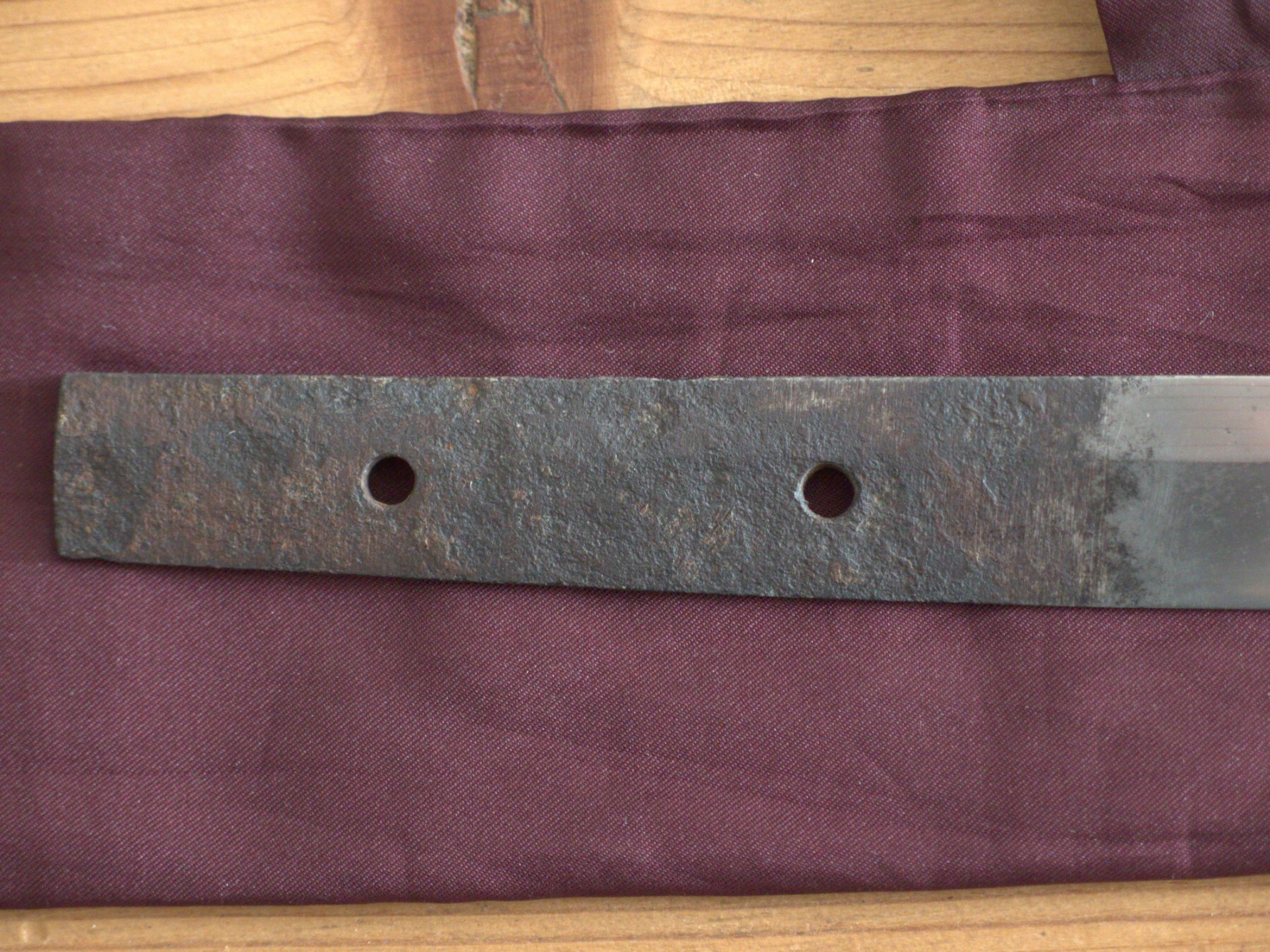

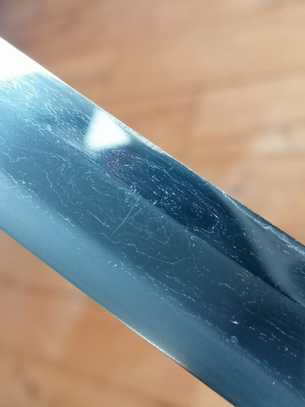

Bonjour à tous, je suis nouveau sur le forum et j'ai besoin de votre aide pour identifier et dater mon tout premier Wakizashi. Je n'ai pas beaucoup d'informations à son sujet, si ce n'est qu'il est o-suriage, n'a pas de signature, mesure environ 57 cm ( 22 pouces ) et date, selon le vendeur, de la fin de la période Muromachi. Je pense aussi qu'avant son raccourcissement, le sabre devait être un katana en raison de sa longueur, mais cela reste une hypothèse de ma part et je ne suis pas un expert.
merci d'avance pour vos réponses.

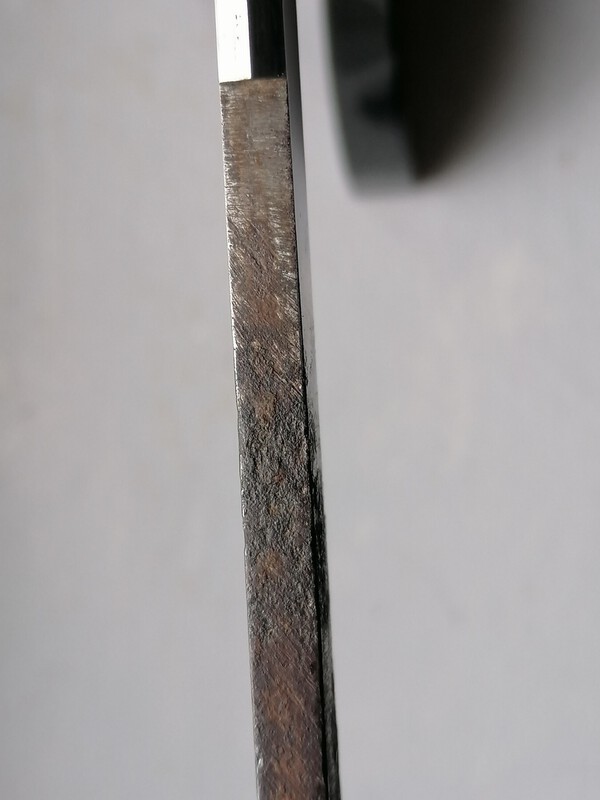

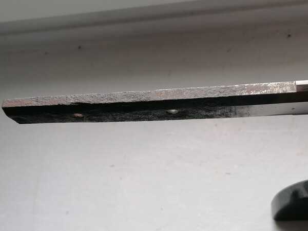

Hello,
Could you take a picture of the nakago from the mune side? Maybe give the thickness of the thickest part under the habaki ?
best regards
Éric VD
Yes absolutely ! The thickness of the thickest part under the habaki is 5mm ( 0.19 Inches ) and here are the pictures of the nakago from the mune side. IMG_20240711_1621222.thumb.jpg.6b13b97694529bc845cdb34aadd78dab.jpgIMG_20240711_162154.thumb.jpg.095753bb76dd5fb4d9470c69c6df8996.jpg
Difficult to say...
5mm is not so much, there is almost no polishing bolt (renflement in french). Hada seems masame with loose grain...
Could be kazu-ichimono ( not a good news) or tired genuine (yamato-den?).
Middle or end muromachi is very possible to me.
Absolutely not sure at this point.

Your answer is very interesting ! Indeed, I agree with you that it is difficult to know for sure which of the two hypotheses you mentioned is the most probable. I also noticed among the forging defects on the blade some sort of wrinkles which, according to my research, could be "shinae", the traces of a repaired bent blade. In addition, underneath the habaki there are bar-coded lines that seem to be the trace of an ancient polishing process (perhaps dating from the 2nd World War?). I was thinking that perhaps these new features could help a more precise identification.
Hello, yes, its a shortened Katana. Maybe shortened after damage, a crack maybe.
It could well be Koto
Obviously, the nakago is missing which would have been a great help.
The jigane to me looks like large itame with some nagare, rather than pure masame.
Here is a good link that will help you understand a little, even throws some schools in.
KANTEI 2 – JIGANE & JIHADA #2 | Markus Sesko
