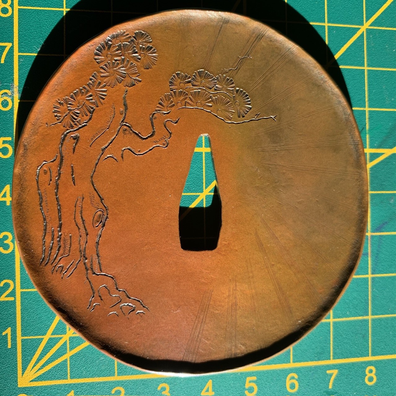

 I tried something different with the symbol of my hometown, the 1000 year old oak. It feels like most people here have forgotten about it but I always liked it.
Experts say it won’t last long anymore…

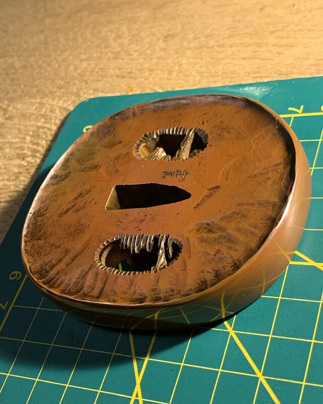

This is what I actually work on.
the big Tsuba took all of my saw blades so I ended up using one of this scroll saw blades (they suck). I ordered new ones and continued my work but will make the 2nd part of the video when it is finished.
So the experts will realize a few things
1. Melting the copper took too long and the water was too cold when I casted it.
2. actually the friend I make this Tsuba for wanted a lens shape and liked the texture so I don’t had to clean it and add another texture.
3. Kill me for the scroll sawblade :D
4. I have my daughters rabbits in my forge when the weather is bad outside :laughing:
The Video is not educational and more for my Instagram audience but maybe I can make a longer YouTube movie from it when it is finished.

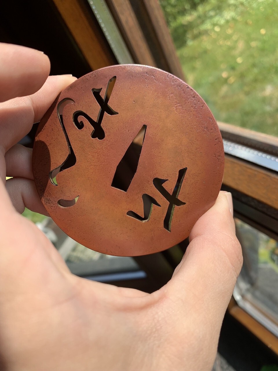

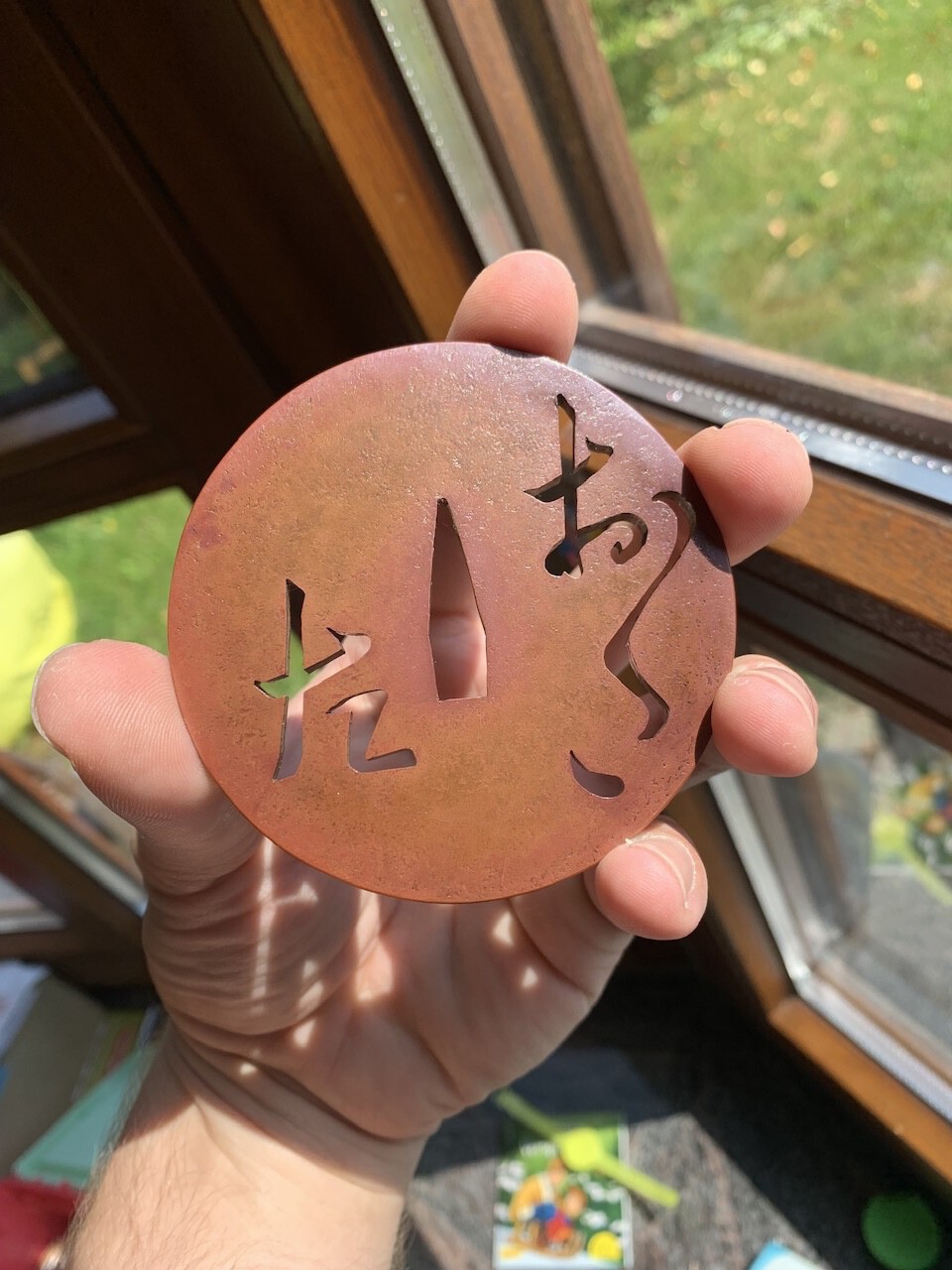

If some of you can remember I wanted to do an utsushi of the “Oda Sa tsuba”
but after some questions I decided that i can’t do it back then.
I have learned a few things and now I will give it a try.
So what I have is a blurry picture without much additional information and this texture is unlikely accurate but hopefully will help me to achieve my patination goals.
After my Tsuba has some variations in the calligraphy I won’t say it is written by Naomasa.
I have a little file work to do but then the patination experiments begin.

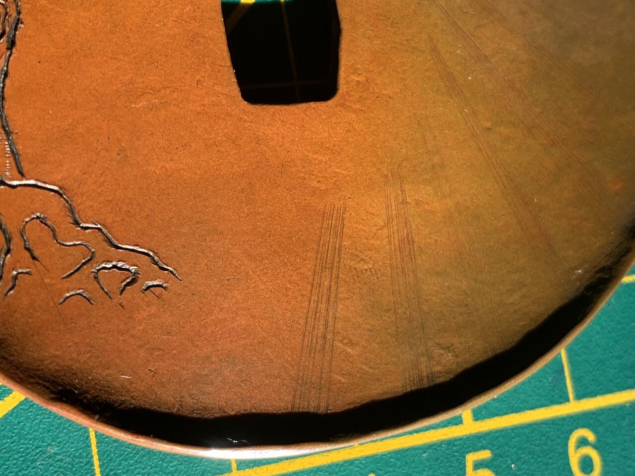

Now I had some sad tries with the Oda Sa Tsuba and will try again later.
The first try was (imo) ruined by a small piece of iron from my hammer or anvil that got stuck in the surface.
It is right next to the „Sa“ but it is so small I did not see it earlier.
So I removed it and tried again to see if I can still use this rokusho solution.
but now i have to clean it again and clean the surface with different polishing compounds to achieve (hopefully) the effect of the darker outsides and around the nakagoana.
In my opinion it actually is a result of its age and was more like mine is now when it was finished, but I don’t have houndred years to wait and touch it.
I don’t have the high hopes for the next try :laughing:
Also does it look too plain completely unsigned ?

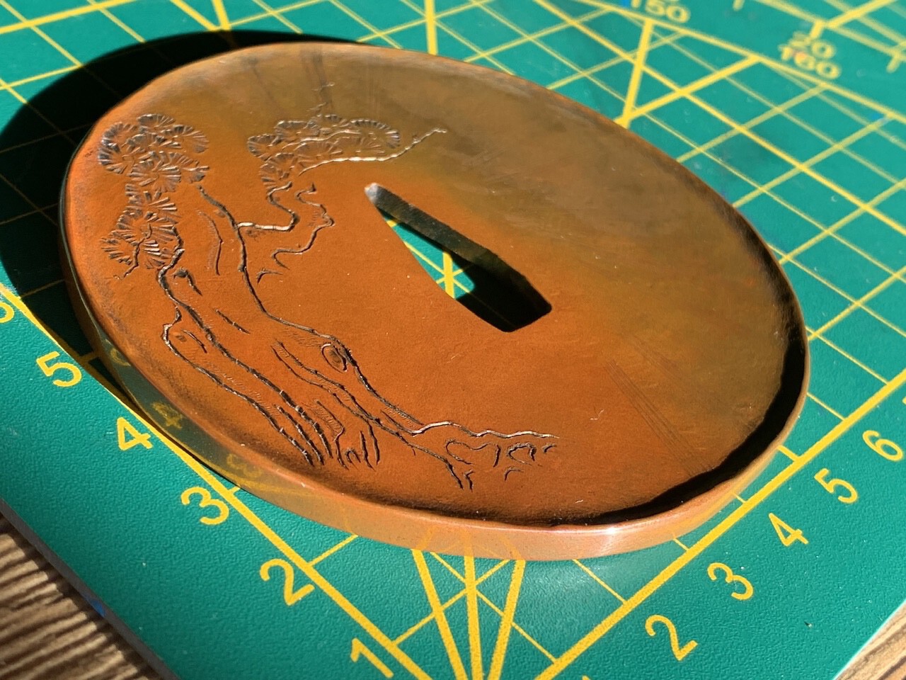

Here is another one that I made from a blank that has some kind of personal story, the reason i don’t removed the scratches from the „dirty“ side.
IMG_7196.jpeg.0bf794397b9c2c0abfa7d7eb597a8e48.jpegIMG_7205.jpeg.50e884c04f00621f857ff9eca64fe851.jpegIMG_7198.jpeg.7278694b912ee2f72c3166b26a96c204.jpegIMG_7200.jpeg.7644da9da9deabfd5cdf0a73cfff57f9.jpegIMG_7201.jpeg.fa36f27878d2646a2ae674721a46c805.jpegIMG_7202.thumb.jpeg.0eaea7e3b58988327f4ae25858f9ade4.jpegIMG_7203.jpeg.45626328b85e907a8f4853e73315f78b.jpegIMG_7204.thumb.jpeg.e2051b06749b27e1c928fe9e5db11bbb.jpeg

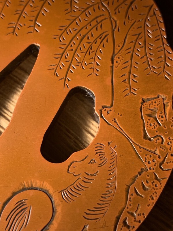

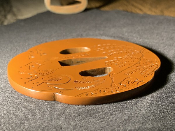

I call it finished, here the video that shows it much better
Now some engraving after I haven’t even signed the last piece :roll:

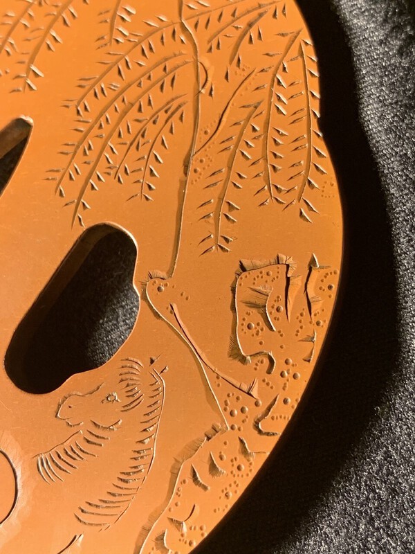

Katakiribori a Yokoya motif.
Some flaws and many things that could be done better but I won’t get better not doing it.
Love the horses eye, after looking at  Somin pieces it was cool to see that he does not used a punch like many later artist did but chisel around the pupil so I also tried it.
I’m happy with the result but this was actually the easier side of the Tsuba.
  • Like 4
  • Wow 1
In case no-one told you, that is superb work! Well done, I find that quite skilled, and one of the hardest techniques to get right. Ford would have given you a big compliment I am sure.
Thanks Brian I appreciate your words !
In Germany we say “Man soll den Tag nicht vor dem Abend loben.”
and google told me the English equivalent is “Don't count your chickens before they are hatched.”
We will see where it goes :glee:
I always highly valued Fords Opinion and I hope my efforts would meet his expectations and I can make the best of what he shared so generously!

And made a new nearly flawless patina for the horses Tsuba
old
new
ofc the old one had a little more urushi in the groves but this can be added and some will say the old one looked more alive but look at this :laughing:
