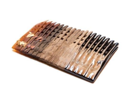

Schmitty Posted July 2, 2024 Report Posted July 2, 2024 Hello, would anyone be able to point me in the direction of some resources/books/videos/blogs specifically on applying Urushi on metal and rawhide armor. The two things I am most interested in is 1: how exactly is this build up achieved on rawhide kozane before and after it is laced. I assume the rawhide is treated similarly to fuki urushi before lacing but then it looks like some kind of build up of material/filler, see first photo, before the final polished layers. 2: I don't know what the proper Japanese terminology is but how is the edgingtrim on metal Japanese armor built up. You can see it chipping/flaking away in this photo. I believe it's some Urushi clay mixture. Any help would be greatly appreciated thank you.
ROKUJURO Posted July 2, 2024 Report Posted July 2, 2024 Trevor, very special questions! Have you considered to ask the related restorers directly? One of them is David Thatcher: https://davidthatcher.co.uk/
uwe Posted July 2, 2024 Report Posted July 2, 2024 It’s called “kokuso“, a mixture of urushi and fillers!
Schmitty Posted July 2, 2024 Author Report Posted July 2, 2024 5 hours ago, ROKUJURO said: Trevor, very special questions! Have you considered to ask the related restorers directly? One of them is David Thatcher: https://davidthatcher.co.uk/ No I have not, I wanted to exhaust all other options before I pester them with questions but I suppose there is no harm in asking. Ill send him an email, Thanks for the reply.
Samurai Art Posted July 2, 2024 Report Posted July 2, 2024 I am a member of this board. The mixture is called sabi-urushi nuri, not kokuso, as previously mentioned. It consists of flour, sawdust, or hemp strands. Sabi is made with water and a dried volcanic clay called tonoko. As a retired professional restorer, I cannot delve deeply into the restoration process. I have no interest in educating the three katchushi posers in this group who wish to learn the process to improve their monstrous works. For the newbies, I cannot recommend anything in the same way asking about sword polishing would be received. There are no books on the subject; to learn, you must study metalwork and how to apply urushi yourself. Studying in Japan should allow you to find a teacher like Nishioka or toyoda sensei, which is the only route in my opinion. 1 1 1
Schmitty Posted July 2, 2024 Author Report Posted July 2, 2024 5 hours ago, MIFUNE said: I am a member of this board. The mixture is called sabi-urushi nuri, not kokuso, as previously mentioned. It consists of flour, sawdust, or hemp strands. Sabi is made with water and a dried volcanic clay called tonoko. As a retired professional restorer, I cannot delve deeply into the restoration process. I have no interest in educating the three katchushi posers in this group who wish to learn the process to improve their monstrous works. For the newbies, I cannot recommend anything in the same way asking about sword polishing would be received. There are no books on the subject; to learn, you must study metalwork and how to apply urushi yourself. Studying in Japan should allow you to find a teacher like Nishioka or toyoda sensei, which is the only route in my opinion. Hello David, unfortunately studying in Japan is financially unfeasible for me, as much of a dream as that would be, but I completely understand the reasons. Your work is beautiful and inspiring and I thank you for the response.
