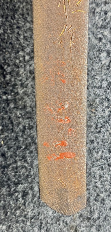

Newguymike Posted June 27, 2024 Report Posted June 27, 2024 The only thing I am sure of is the Showa Era stamp. Can anyone help me translate the rest of the kanji? My understanding is that it’s a date and signature; but I’d love to know. The red paint, from what I’ve been told is a proof of some kind; again, I’d love some help. Finally, there are 4 dots and I’d love to know what they are. 1 Quote
Conway S Posted June 28, 2024 Report Posted June 28, 2024 Mike, I believe it’s signed Amachi Masatsune. No date here. The paint can reference a production sequence or can be used to help keep the blade and its fittings itemized during assembly. Conway 3 1 Quote
Kiipu Posted June 28, 2024 Report Posted June 28, 2024 天池正恒作 Amachi Masatsune saku. 作 = made by. 2 1 Quote
Newguymike Posted June 28, 2024 Author Report Posted June 28, 2024 Thank you gentlemen for fast responses, I appreciate it. Is there anything else you can tell me about the pictures? There’s a series of four dots- any idea what those are? Quote
John C Posted June 28, 2024 Report Posted June 28, 2024 @Bruce Pennington Four diagonal dots at the end of the nakago. John C. 1 Quote
Bruce Pennington Posted June 28, 2024 Report Posted June 28, 2024 Thanks John! Hi Mike! I have 6 other Masatsune blades on file with the Showa stamp and NONE of them show the full nakago, so I don't know if those blades bore the dots or not. Very frustrating! We haven't got a clue as to their use or meaning. They are predominantly on WWII blades, but I have seen a rare few on much older blades. You have the honor of having the first I've seen with such small dots in a diagonal! Quote
Bruce Pennington Posted June 28, 2024 Report Posted June 28, 2024 I'm curious about the black marking on the jiri of both sides. My first impression was that it's an anchor, but I don't think so. Anyone recognize them as kanji or kana? 1 Quote
Brian Posted June 28, 2024 Report Posted June 28, 2024 Surely just to mark them to keep them with their respective fittings? You can stamp numbers on fittings to keep them together, but likely those lines and marks were just used to note which blade went with which fittings. Even older swords co-opted into the war would have needed markings to keep them together with their new military fittings. Easy to make a note "III - 3456 fittings" Blades would have been separated when getting polished etc. Just seems logical to me. 1 1 Quote

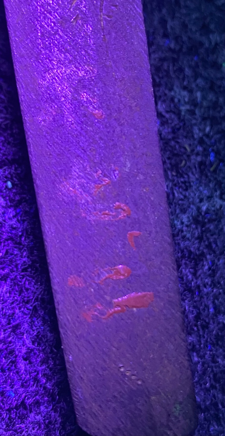

Kiipu Posted June 28, 2024 Report Posted June 28, 2024 14 hours ago, Newguymike said: The red paint, from what I’ve been told is a proof of some kind; The red painted characters look to be a subassembly number of some kind. The second character is indistinct; however, it does kinda look like a 二. Could the diagonal dot punches be related to the subassembly number? ホ = HO. ? = ? [could be a 2]. 二 = 2. 1 Quote

Newguymike Posted July 1, 2024 Author Report Posted July 1, 2024 Are there any specific books that anyone in the thread can recommend? And, I’m adding another photo that highlights the paint better. Quote
Bruce Pennington Posted July 1, 2024 Report Posted July 1, 2024 On 6/29/2024 at 6:52 AM, Newguymike said: @SteveM- thanks for sharing. Do you or anyone else in the thread have additional information relating to this specific person? This is what Sesko has on him: "MASATSUNE (正恒), Shōwa (昭和, 1926-1989), Gifu – “Masatsune” (正恒), real name Amachi Reiichirō (天地鈴市郎, first name also reads Suzuichirō), born. September 23rd 1894, he worked as guntō smith and died May 12th 1949, Fourth Seat at the 6th Shinsaku Nihontō Denrankai (新作日本刀展覧会, 1941)" 1 Quote
Kiipu Posted July 1, 2024 Report Posted July 1, 2024 1 hour ago, Newguymike said: I’m adding another photo that highlights the paint better. OK, I can see it clearly now. It is the katakana character ホ followed by 72. ホ七二 = HO-72. 1 1 Quote

Newguymike Posted July 1, 2024 Author Report Posted July 1, 2024 3 hours ago, Kiipu said: OK, I can see it clearly now. It is the katakana character ホ followed by 72. ホ七二 = HO-72. Thanks, for the help; but what does it mean? Is HO-72 have a specific purpose? Quote

Bruce Pennington Posted July 2, 2024 Report Posted July 2, 2024 I did address the dots in my first post. No one knows why the dots were used. They are not like the assembly, painted, numbers as they never matched numbers anywhere else on the fittings. They are mostly seen on WWII blades, however, I have seen a rare few older blades with dots, so it's not just a WWII thing. 1 Quote

John C Posted July 2, 2024 Report Posted July 2, 2024 Mike: Just to add to what Bruce said in re: the dots. There was an old video posted some time ago that showed a smith making farm tools that used blades. The smith noted in that video using 3 dots in a triangle as a maker's mark. He also indicated it had been done for some time. So as Bruce noted, probably nothing to do with assembly but rather a maker's mark of some kind. John C. 2 Quote
