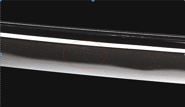

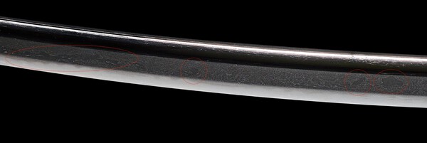

Lewis B Posted June 26, 2024 Author Report Posted June 26, 2024 Here are a couple of examples I found online. The first one is a Naotsuna and the second a Ko Hoji Sadatsuna, both Juyo papered. I get the impression Tanobe is in the camp of letting it slide and does not degrade the quality of the blade much when they exhibit such Shintetsu features (circled in red). 1 Quote
Rivkin Posted June 26, 2024 Report Posted June 26, 2024 The influence of kizu on high level papers is always school specific. At TJ level, Sumigane or Rai shintetsu are not seen as strictly negative. Ware can be tolerated with ko Hoki or Sairen or Hiromitsu. Fukure with Masamune. Bizen blades with almost any kizu generally can't get Juyo. 2 Quote
